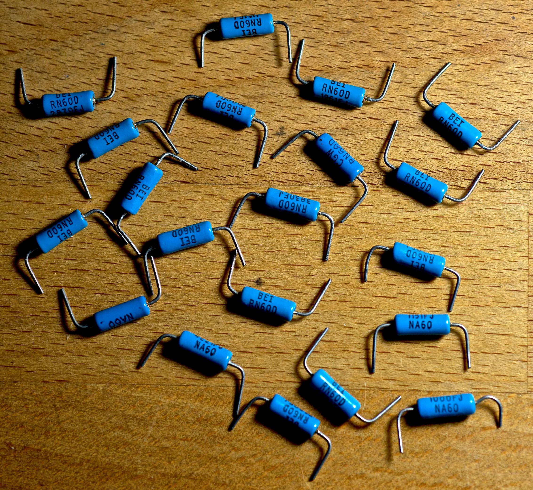

Who know the brand name BEI (very low noise resistors like DALE) ??
This resistors was added to each device of this preamp model.
Bradford-Electronics-Incorporated. (eaten by KOA speer)
The one North-East of the center reads Corning Glass Works.

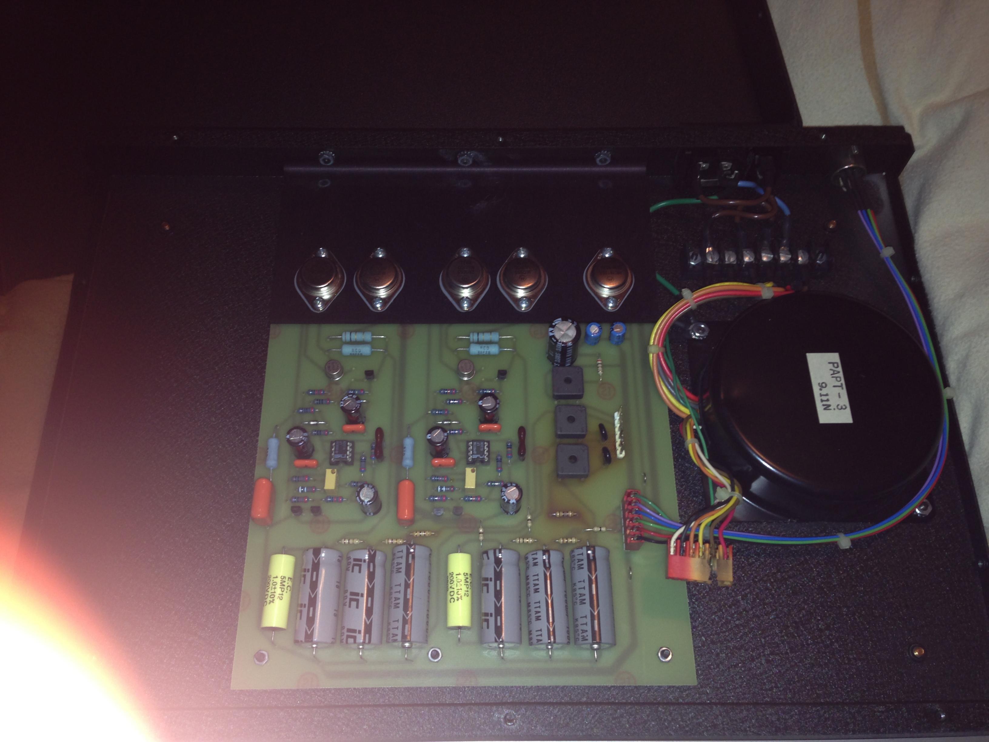

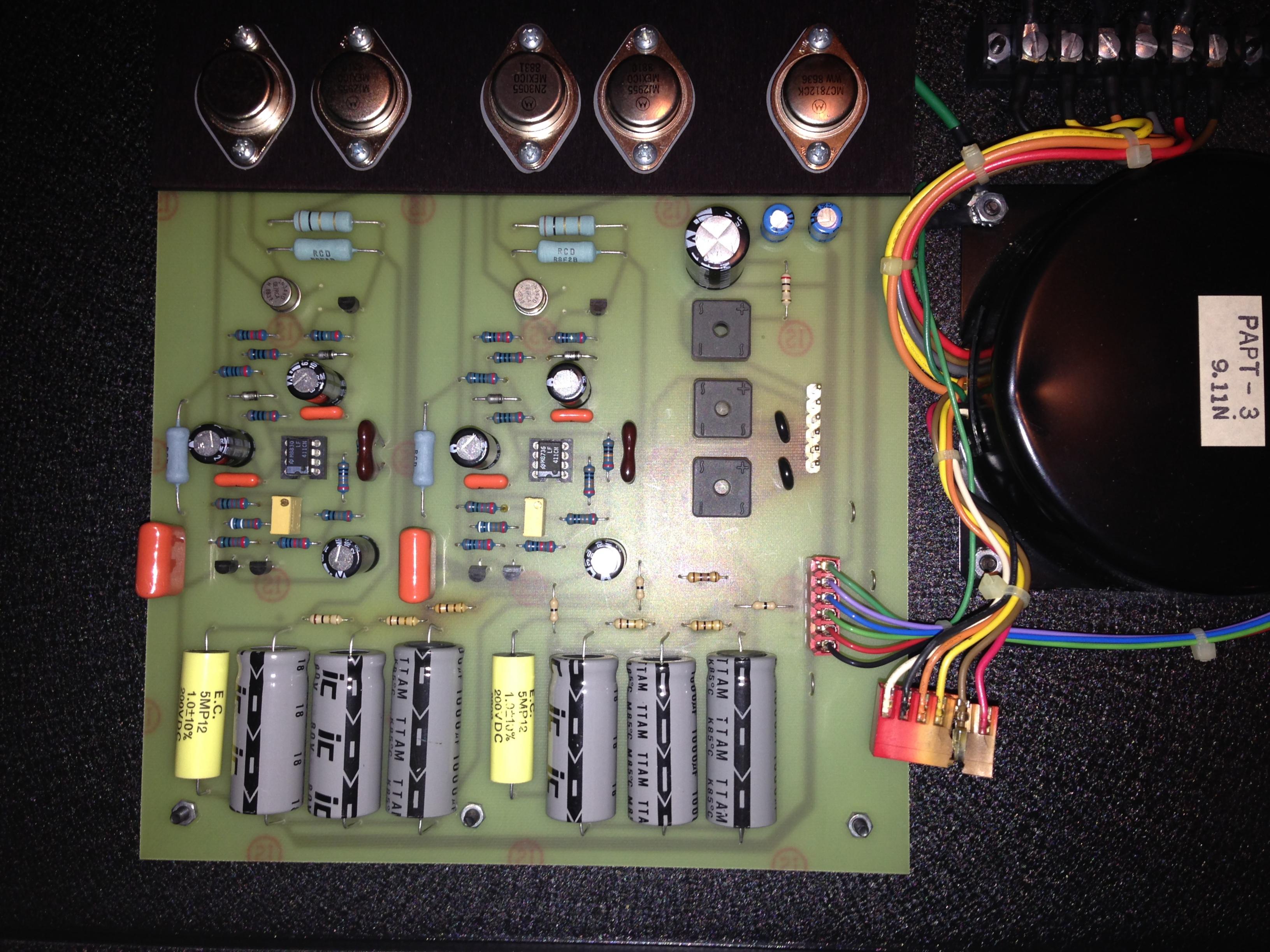

The first preamplifier of this model has arrived to investigate. The cable connector from the toroidal transformer to the PCB pins of the power supply device so as the PCB-pins and PCB itself have been very strongly superheated (sound check in this condition isn't possible without the risk of additional damages).
This means, the superheated region of the PCB must necessarily be removed with help of drilling mashine and cut-off wheel (hard to believe an a preamp in this price range - for doing this I will create images of this desaster previously, probably after Christmas).
Why the hell the transformer was not soldered directly with the PCB rails ???
The reason for the overheating are resistances between the male and female connectors - also good known at the old versions from Electrocompaniet's Ampliwire 100.

burned connectors and burned PCB area

The attached images are the supplement to my previous post.
