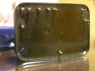

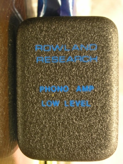

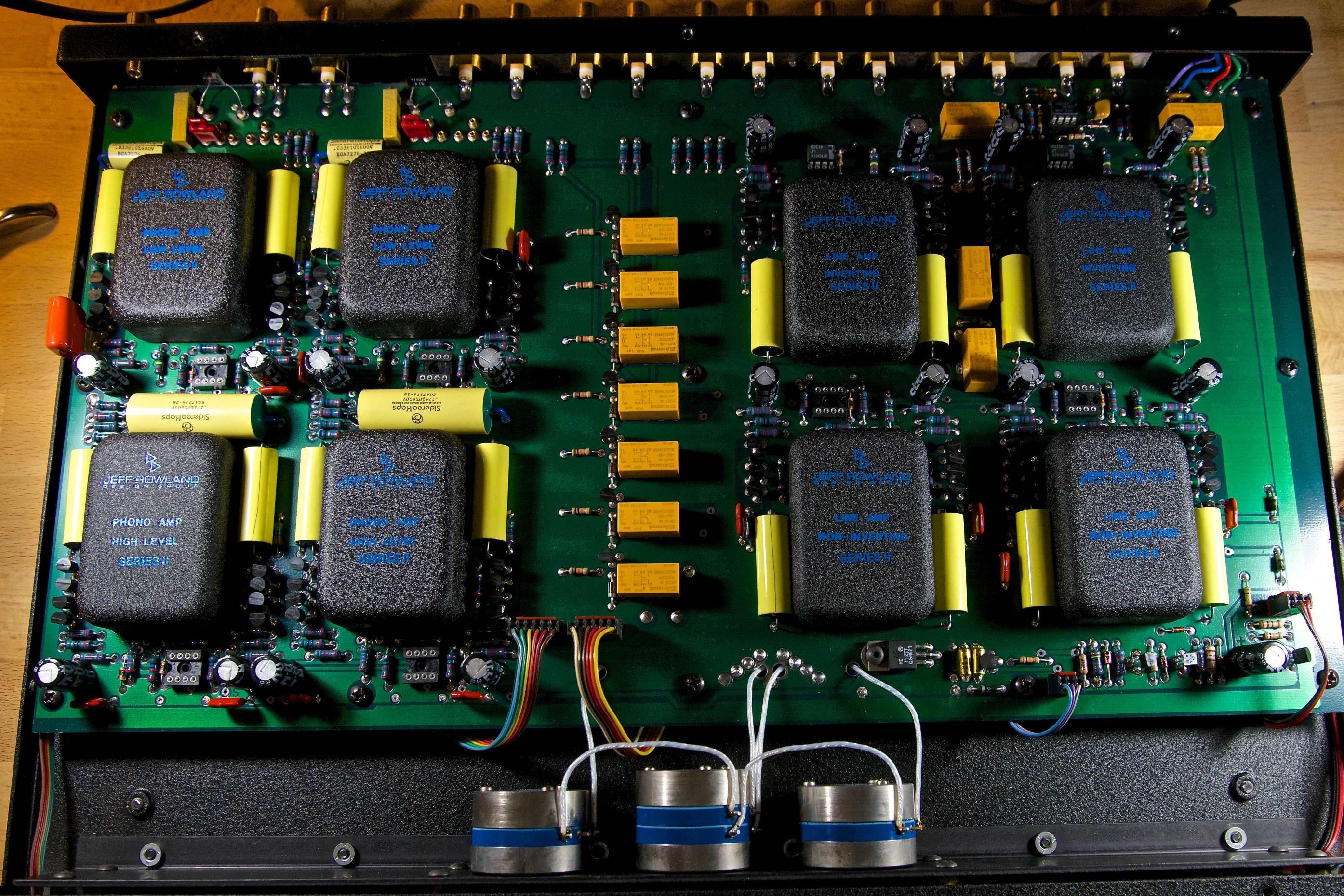

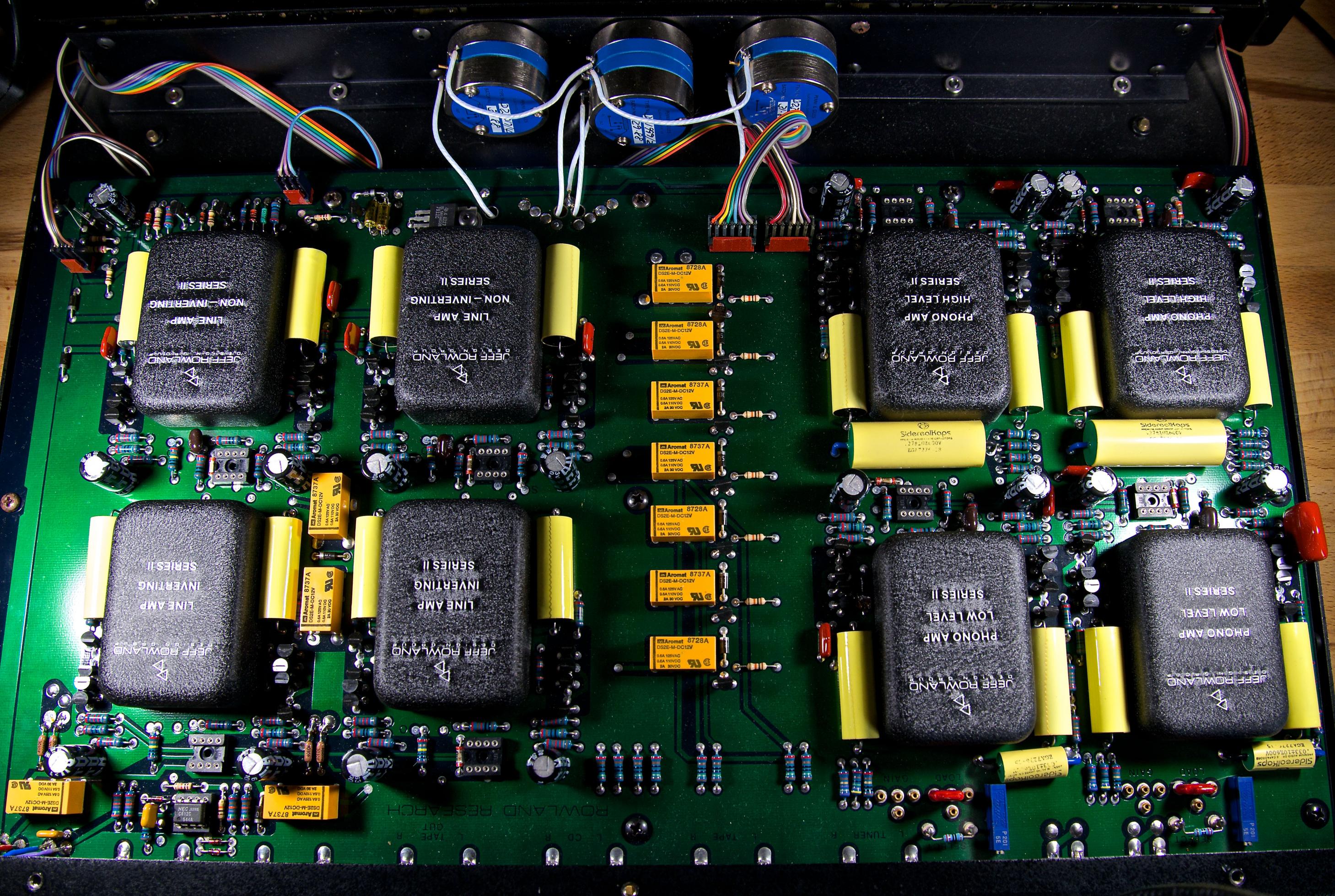

Questions to the Operational Amplifiers used for Offset Servos
A friend of me purchased two preamplifier devices of this model.
he send me an inside image from both devices - go to the attached pics.
I miss the operational amplifier ICs (DIP-8) - instead this I discover only the 8-pin sockets without the ICs - except by the second device - there are two OP-Amps in the area for the inverting line amps.
according the simplified schematics there are drawed offset servo OP-Amps for each module (four/each channel).
Follow question rises up:
In which cases are the offset servos in use and in which cases
they are dispensable?
Thank you for advices.

Sorry, cannot really help but fwiw i once deconstructed a similar module. Took me a few days and wasn't any fun. And in the end - where there should have been a zero feedback circuit - 4 cheap opamps were found and nothing else worth concealing.
I wouldn't be too surprised if under the epoxy lies one of John Curl's circuits.
In which cases are the offset servos in use and in which cases they are dispensable?
That was one of the highlights of the improved Coherence One, no DC-servos, the transimpy circuit of the Series II modules could do without.
(LNRDS and Stereoplay had articles on the JRDG Coherence One SII, omission of the servo was mentioned in one of them)
Coherence One 1st series has a 411 crud for every module installed.
All series II versions have empty opamp sockets. In case a module turned stray dog as it became older, an opamp could be installed as service patch.
Last version of the SII had no DIP8 sockets soldered to the main board at all, empty landing pads.
Jeff likely figured he could kill two birds with one stone : save a buck, and possibly sell an extra gain module. There's economics for ya !
