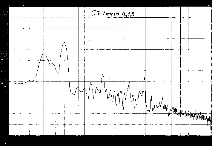

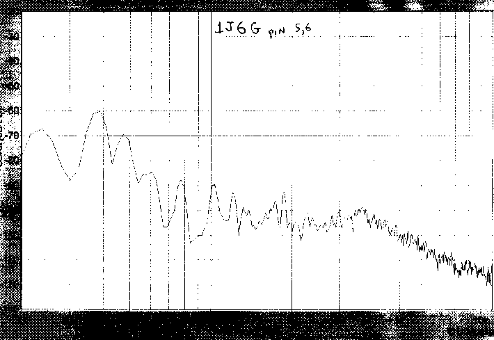

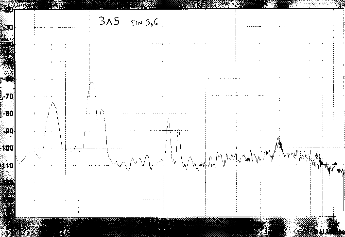

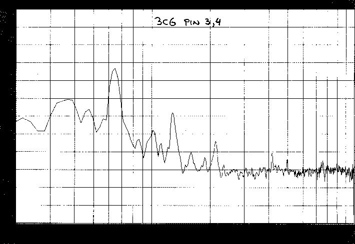

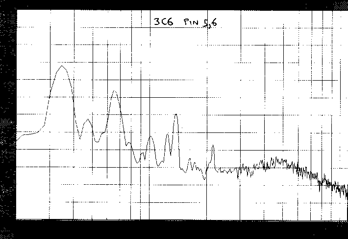

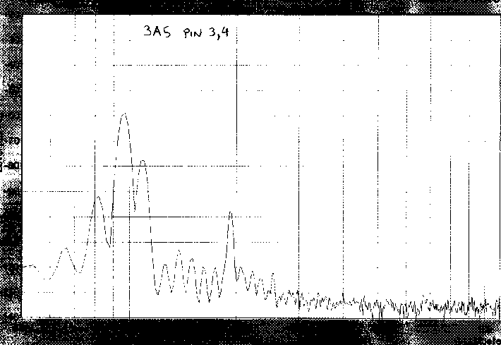

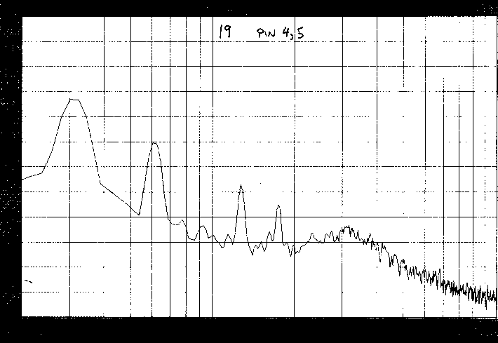

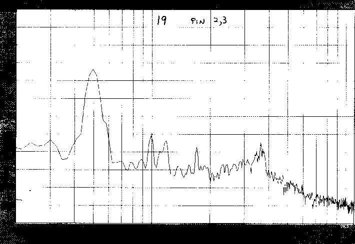

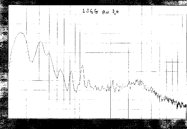

I acquired a few small DHT dual triodes to test: 1J6G 1J6GT 1J6GX 1G6GT 3A5 19 3C6 and 1E7 (a dual pentode). First, I had thought that maybe the same filament section was used for each triode, but that is not the case for any thus far. The triodes are separate assemblies with the filaments in series.
The 19 appears to be the same as a 1J6G but with the older 6 pin base. The 3C6 is a Loctal base.
To test these I used an IXYS CCS on the plate, set for a few mA and adjusted the grid bias for best linearity. I initially tried a Tek 7L5 spectrum analyzer, with the tracking generator output thru a SS amp to a speaker set near the tube. The input of the analyzer was the (attenuated) plate output. This gave a nice set of resonance peaks for each tube, but no easy way to get them on the computer.
So I connected the tube plate output to the computer sound card (attenuated) using a software FFT analyzer to see the spectrum. This worked similarly, but I found that if I just tapped the tube with my finger I got near the same spectrum without having to mess with the speaker. I then connected the SS amplifier input to the same (attenuated) plate signal so I could hear the signal too.
Most of the tubes sound similar to weird cow bells, and different sides of the tube are somewhat different from each other. Trying a different tube of the same type gives somewhat different results too. So, I concluded that they are not very consistant.
Some tubes however sounded like Chinese gongs, and were very interesting sounding.
One of them was amazingly good, with various ringing tones becoming prominent at different times and that weird bending sound like a musical bending sawblade in between the prominences. I'm thinking of making a doorbell with it now. But I will have to try it first in a pre-amp stage to see what it sounds like there. These gongers also tended to be more sensitive to pickup, with some even oscillating from the speaker acoustic pickup. I also checked a 6FQ7 indirect heated triode, and it was near dead silent in the same test setup. The DHTs are VERY sensitive to acoustic pickup.
So some tube spectra follow.

Unfortunately, the FFT software does not seem to allow saving the spectra directly, so I have to print them, then re-scan them. The file limitations for uploading here reduce the resolution so you can't read the scales then. The bottom axis is a log freq scale from 200H to 10KHz for most of the scans. (500Hz starting on some) The vertical axis is a log (dB) scale from -140 to -20 dB.
