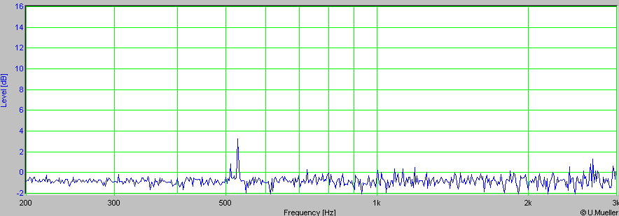

Repeated the wet sock scan and its not consistent. Hard to tell if anything works this way then. I was afraid of that. Very high Q resonances require an extremely slow frequency scan to avoid phase shift problems.
I noticed another interesting effect last night. If I put the speaker near the computer CRT monitor and scan, some frequencies make intensity waves travel across the screen (horizontal bar-like, but clearly sinusoidal modulation, with vertical motion).
With such high Q tube resonances, it will be very tough to isolate the tube from picking up acoustics. A very tiny acoustic pickup of the right freq. and for a few seconds will bring up the full amplitude resonance. It will take extreme measures to avoid any feedback. I don't think a heavy chassis will help this problem at all, it probably enhances it. You're really going to need exotic things like lead and aerogel and deadened shielding boxes to fix this.
smoking-amp said:With such high Q tube resonances, it will be very tough to isolate the tube from picking up acoustics. A very tiny acoustic pickup of the right freq. and for a few seconds will bring up the full amplitude resonance. It will take extreme measures to avoid any feedback. I don't think a heavy chassis will help this problem at all, it probably enhances it. You're really going to need exotic things like lead and aerogel and deadened shielding boxes to fix this.

Well, we probably can shield out the broadband acoustic pickup stuff (microphone effect), but the high Q resonances look nearly hopeless:
System suspended on air bearings with battery power, with modulated laser beam signal input and output thru vacuum chamber windows.
Neg. feedback comes to mind as the only practical fix for them.
Don
Oh,... for measuring the resonances (and attempted attenuation schemes), we just need to set the oscillator on a known resonance, and measure the steady response.
Don

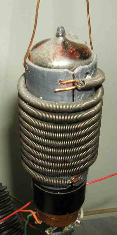

45 said:This is the right way to do the job.
The top copper posts are connected to the suspension.

"This is the right way to do the job."
Nice. Suspended by some elastic or a spring? How well does it work?
"If I had to hide it inside a box I'd just use sand! "
Does kinda look like one of George's (Tubelab's) procedures for tubes that didn't make the grade at 3X rated dissipation. A tube "hanging".
Maybe could put the tube in a bottle of clear silicone oil instead of lead, then suspend the bottle.
Elastic. It works nice.
The picture shows the valve into the amp.
45
Not sure I quite understand the focus on damping at this stage of the game. The whole point of the thread originator was that there is something about DHT's that results in more richness and depth to the output, that gives a perception of more realistic timbre (at least for some listeners). The hypothesis was raised that internal mechanical resonances in the tube might be responsible for this effect.
If the point is to demonstrate that the resonant behavior that Don shows, is due to mechanical feedback, then comparing the same tube, with and without excitation is an obvious thing to try. But wouldn't it be simpler just to remove the tube under test from the sound field? Put the speakers in another room, outside, whatever. A wet sock around a high voltage tube? Yikes! We get nervous about schematics on here without mains isolation.

"A wet sock around a high voltage tube? Yikes! We get nervous about schematics on here without mains isolation."
Yeah, that was a little overboard I guess, don't try that one at home folks. (didn't work anyway) It was actually a damp sock, not a dripping wet one, rolled up around the tube with a foam layer over it to handle it. All in the interest of science.
"wouldn't it be simpler just to remove the tube under test from the sound field? "
Yes, all one needs is to use some headphones to listen, with the speaker on or off to check for feedback effects etc. When I get my Hammond 124B xfmr, or if Andy can try it out. He's the one who best knows the DHT effects.
Sheldon said:Not sure I quite understand the focus on damping at this stage of the game. The whole point of the thread originator was that there is something about DHT's that results in more richness and depth to the output, that gives a perception of more realistic timbre (at least for some listeners). The hypothesis was raised that internal mechanical resonances in the tube might be responsible for this effect.
I start from the end: the hypothesis is wrong. Demonstrated and always repeatable (as is for any true scientific claim).
Without excitation of its mechanical resonances the DHT sounds simply better.
The experiment has been done not only for a DHT (or other tubes) but for any component of the audio system.
Damping (in its literal meaning) is not the right thing to do.
An elastically suspended object at subsonic frequency works by means of
inertia reaction for our purposes.
Basically the (big) difference is: damping the resonances means that you are attenuating a negative effect that is already masking and irreversibly degrading your sound, while inertia reaction simply does not make it happen, not only as consequence of speakers acoustic feedback but anything of the outer world that can excite your components!
