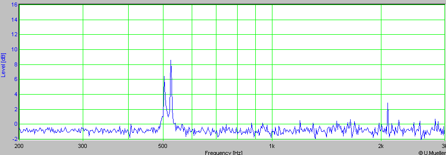

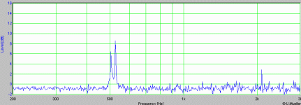

Well, first I put a 3/8 inch light foam pad around the tube and tied it up with a small elastic band which was used to support the assembly also. Doesn't look like it helped at all, maybe even worse.
"Magnetic coupling doesn't work!"
after all those billions $, no gravity waves yet either.

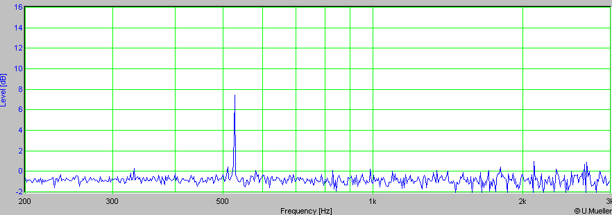

Next I put a wet, size 12, sock around the tube and suspended that with the foam and elastic as a sling around all. (takes like 5 minutes to scan the freq. slowly, I couldn't hold it steady that long)
Seems to have helped some, but nothing miraculous. I wonder now if the height of the resonant peaks is consistent, maybe random phase shifts between the freq. sample tests interact with the high Q resonances to alter responses. I'll try the last one again to see if its consistent.
