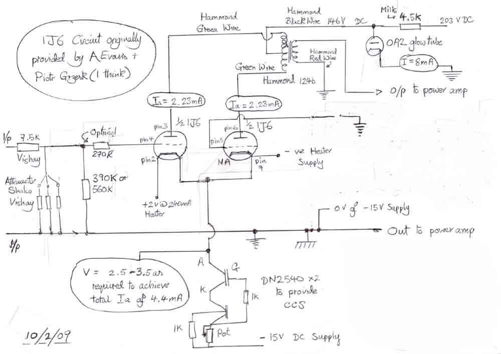

This is a draft version from a colleague, used in single ended mode. My own is balanced and has the stepped attenuator and 7.5k resistor directly soldered to the grid of the 1J6. My own version doesn't have the glow tube, but has an AZ1 mesh, 2uF cap polypropylene, 10H choke and 50uF polyprppylene cap. - andy
Couple of other things - in my version the stepped attenuator is 12 step 47k in shunt between the two grids, so there's an input resistor to earth before the 7.5k in series - 250k or whatever you fancy.
The 1J6G should have matched halves to eliminate DC in the 124b. You really need a tube tester or something like that to match the halves. In my stash of 1J6G about one third were pretty good matches, and less than that were really good matches. They're not terribly expensive like the usual DHTs. I used it because I wanted a balanced input, so a double triode with common cathode was a good choice and meant a less complex filament supply. For that I used 6-0 6-0 toroid, SChottky diodes, 15,ooouF cap, LM1086 as current source with 5.2 ohms resistor, 1 watt, connected between adjust and out, with positive output from adjust pin.
andy

To Allen Wright - I should have said this, but preceding my preamp is a RAKK DAC - this is a low output DAC since it's current output and the i/v resistors from each leg to earth are 75 ohms. There's no op-amps after the DAC - the output with DC on it goes straight into the grids of the 1J6G. This then gets equalised in the biasing of the 1J6G. So really for "preamp" you could substitute "DAC tube output stage". That's true of the last bunch of preamps I've built - they all work straight out of a RAKK board.
But as others have said - a preamp is nothing but an amplification stage, whatever comes before it. I don't know if you'd call mine a "real" preamp - it has to bring the voltage up from about half a volt to a bit under two volts if you include the stepdown in the output transformer. I can see that a commercial designer like Allen, or indeed Kevin with the RAKK would not want to build with extinct tubes, against which it could be said that there a plenty of stocks of some of the DHTs like 26 and 01A. Transformers add money - OK for Kevin as an importer at least. And I know that in his own systems Kevin uses 01A, 26 and no doubt many more. So you may want to play around with some DHTs, Allen, even if they don't go into products.
Other points - the 3a5 is another good double DHT - I've used that for preamps as well. I think the 1J6g is probably better.
The 6J6 comparison eluded me - I was thinking 6J7. I don't think there's much of a comparison, certainly not in terms of sound - they're worlds apart.
As for headphones - I don't have any good ones. It's a very interesting point. I should see if I can borrow some.
andy
Thanks for publishing this interesting circuit Andy. A couple of offtopic questions:
Is the 124B really good enough to do justice to a Vishayed Shallco? What can you compare it to? Would it have any bass with demanding music?
Worst case input impedance seems quite low. Was it primarily intended for use with digital sources?
Thanks.

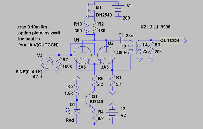

Hi Andy,
Have read your threads with great interest. So now I must have a try as hearing is believing:cool:.
One can look at both 1J6G and the dirt-cheap DCC90/3A5 as dual plate DHTs and use one /channel. This halves Ri and doubles Gm. 3A5 being interesting due to the possibility to use a 1,5V-cell for heating. Of course the triodes have to be selected with matched halves.
Below is how I am going to do it. My friend Hoktuna has almost the same circuit with 417A/5842 so I think it will be an interesting challenge......
There are a few cheap DHTs you can experiment with. 1J6G and 3a5 are good in the double triodes - didn't have much luck with the 3B7 - anyone like that one?
And a few good cheap single triodes. The 31 is a favourite - very musical. 01A is superb, so is 26. Both plentiful and perfectly fine in the ST shape.
Plenty to get started with. If you haven't tried any of these - push the boat out and have a go! I started with a bench power supply for the heaters before learning to build filament circuits, which actually is dead easy when you've done it.
Andy

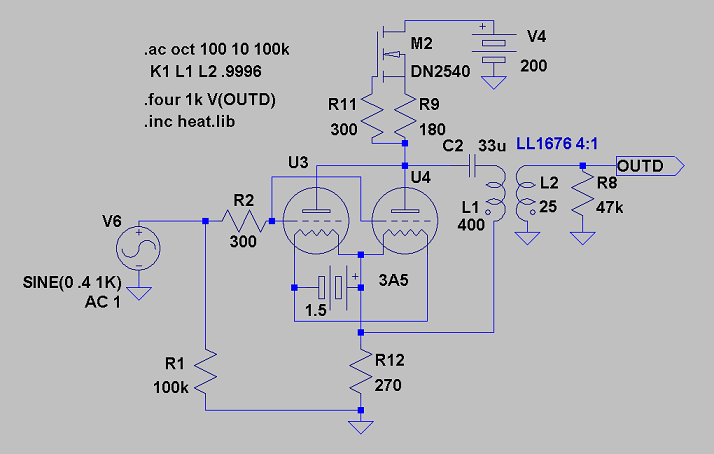

About experimenting I think 3A5 is a good candidate to try with a heater CCS with heater-current through the cathode resistor. I like CCSd heaters in DHT poweramps, so why not try it in a DHT preamp? So in this case 220mA+8mA through R1.
Andy, have you tried it?
