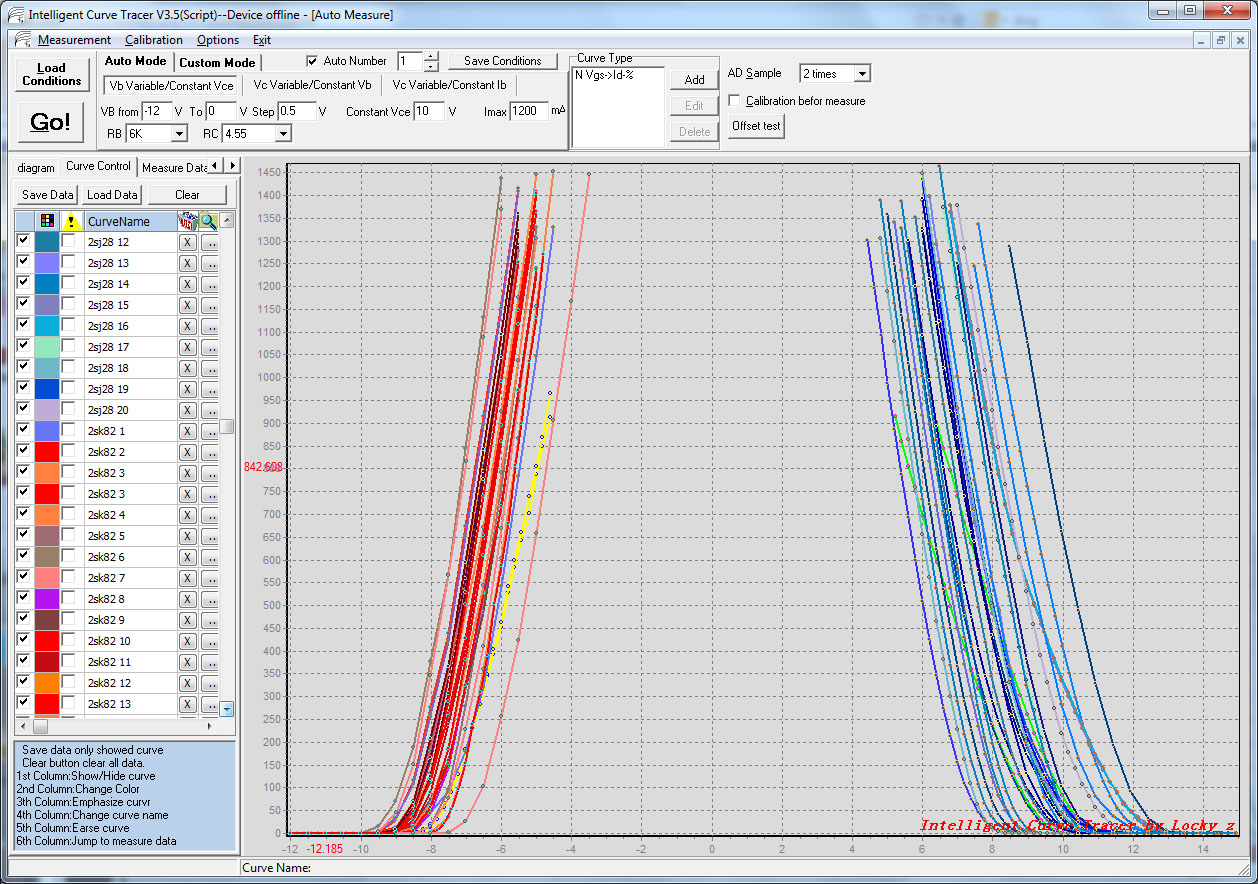

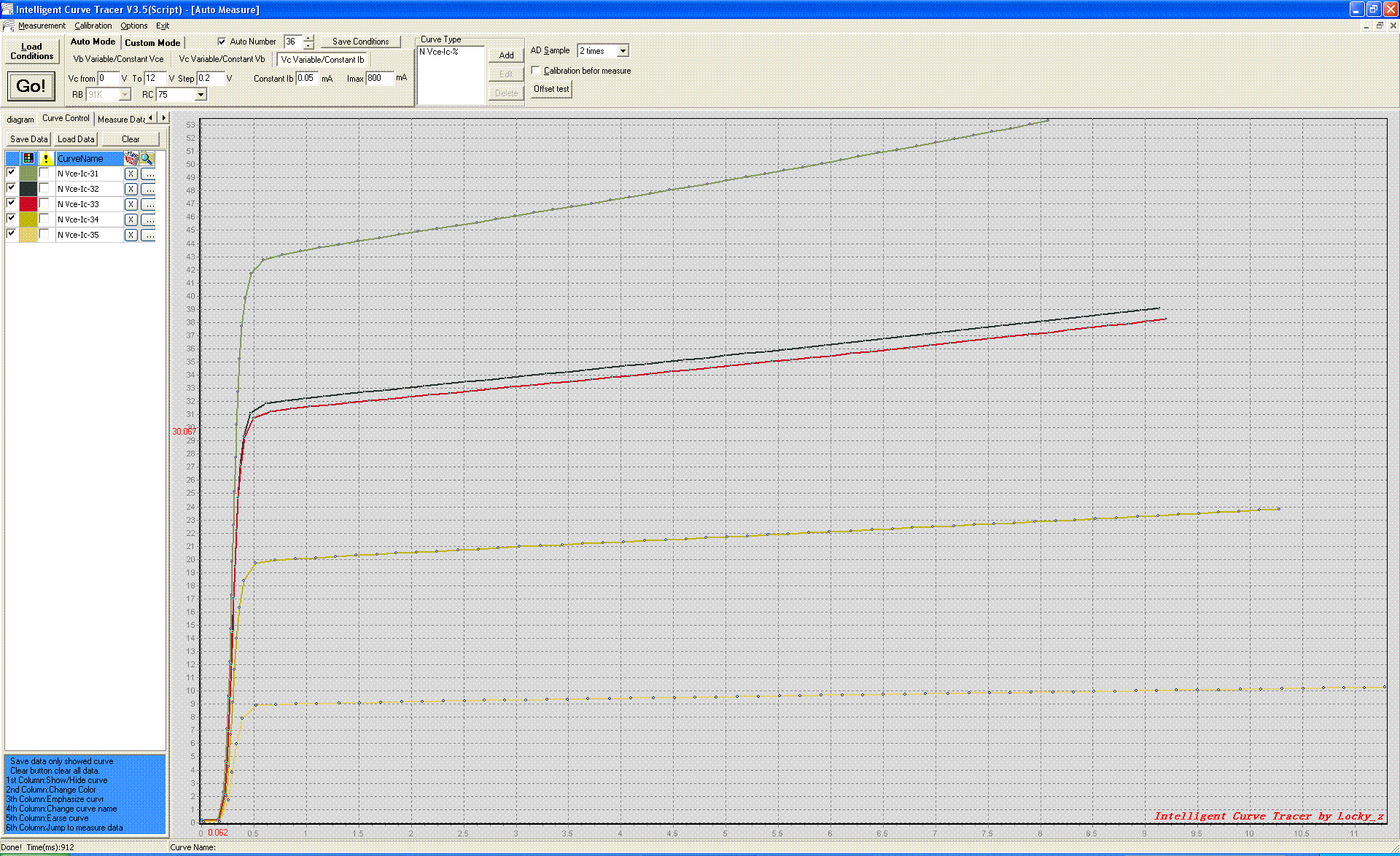

Trouble measuring mulitple Vce-Ic curves
The first step of the Ib current is set to 5 uA. The next is 10 uA. I repeat the process and eventually the next curve is plotted at about the same Ic level as the previous curve. Then the next curve plots just fine again. If I repeat the whole manual process, starting with highest Ib first, I get the same result. For me, it looks like Ib = 20 uA gets wrong.
The same thing happens, if I do the same process by scripting. Sometimes the last curves seem to be plotted at random Ic levels. I use the Vce-Ic script delivered with the software, slightly modified for may transistor.
The bad tables for the bad curves, contains the same data as the curves display.
Have anybody else experienced the same problem?
Everything else seem to work just fine.

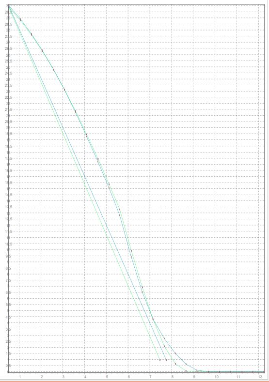

Maybe you can pretend the TL431 is an Nchannel MOSFET:
This "MOSFET" should have a gate threshold voltage of exactly 2.50 volts. So if you select an Ids vs Vgs sweep with fixed Vds = 5.0V, you "should" see zero current when Vgs < 2.50V and infinite current when Vgs >= 2.50V. In other words, a perfectly vertical line at V=2.50V on the curve tracer display. Choose a relatively high value of "base" resistor (= "gate" resistance), so you don't accidentally shove a ton of unwanted current into the Ref pin of the TL431.
edit- you could also short Ref to Cathode and plot it as you would plot a zener diode. You expect the TL431's zener breakdown voltage to be 2.50 volts and its output resistance (DeltaV/DeltaI) to be less than 1 ohm.
