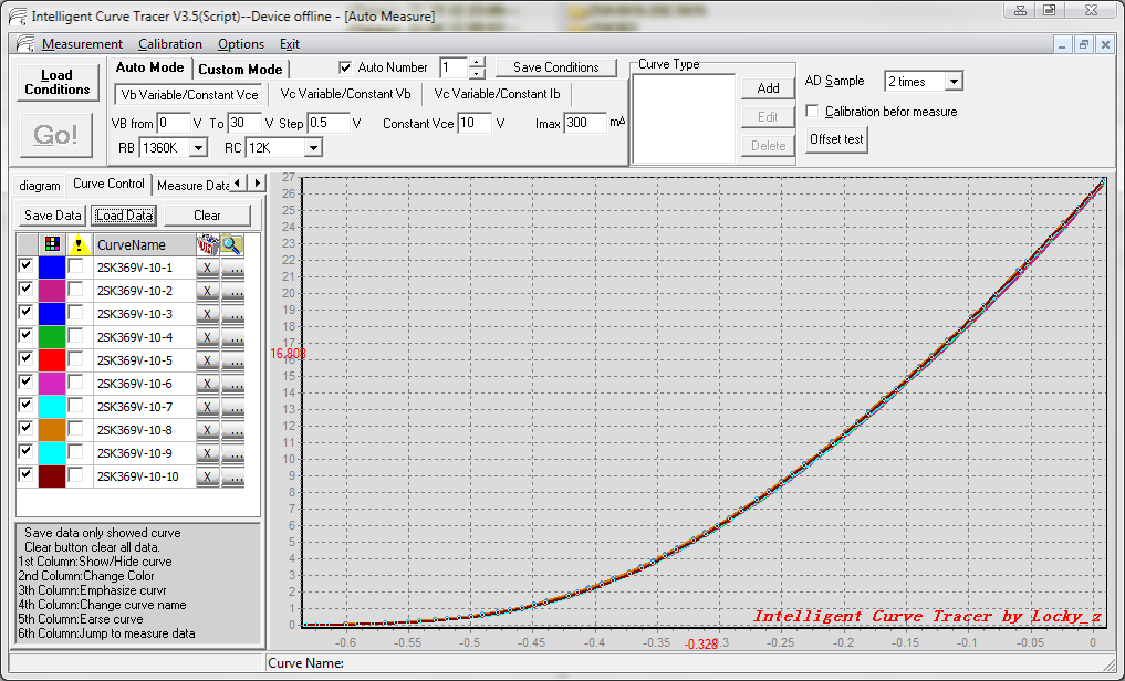

I try to measure only one 2SK170 for 21 times.
As in the attached file, the results are different among 21 measurements.
The error range is too high, so that I wonder whether I made any mistake or not.
Heating the same devcice multiple times will cause heat buldup in the fet which could easily cause slight alteration in test.
Forgot
you are kidding right?
The variation is in the avarage range of 0.02% or so, beside like it's been mentioned here, thermal plays a big rule and temperature changes over time and different set up can produce slightly different results too, especially considering that a Jfet is temperature dependent. This tool rocks!

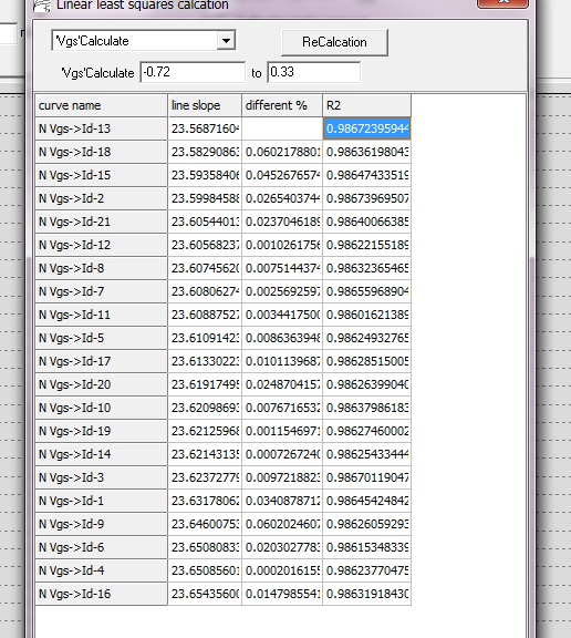

If you want to get the transconductance of a FET.
After you get the Vgs-Id curve, and hold down left mouse button and draw a rectangle.
When you release the button, It will display a menu, there are two menu item.
One is 'V=[xxx-xxx]Calculate' one is 'I=[xxx-xxx]Calculate'
You can select the 'V=[xxx-xxx]Calculate'.
It will display a data window as this:
The transconductance display in column of 'line slope'. and it also sorted.
Its units depend on your X-axis and Y-axis unit, if the Y axis is the mA, then it is measured in ‘ms’, if the Y-axis unit is A, then its units of ‘S’.
The 'different%' mean the 'line slope' value compare with previous 'line slope'.
example: second line,'different%' is 0.06021%
The calcute process is:
(23.5829-23.5687)/23.5687*100%=0.0602%

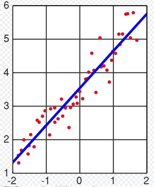

This calcuate use 'linear least squares' to get a straight line
y=a*x+b
Here 'a' is the transconductance. and show it in column 'line slope'.
The R2 is 'product-moment correlation coefficient '. It is closer to 1, then the original curve closer to a straight line.
You can change the calcuate range,you will get different line slope.
You can refer to wiki
Simple linear regression - Wikipedia, the free encyclopedia
