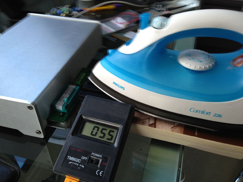

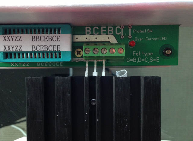

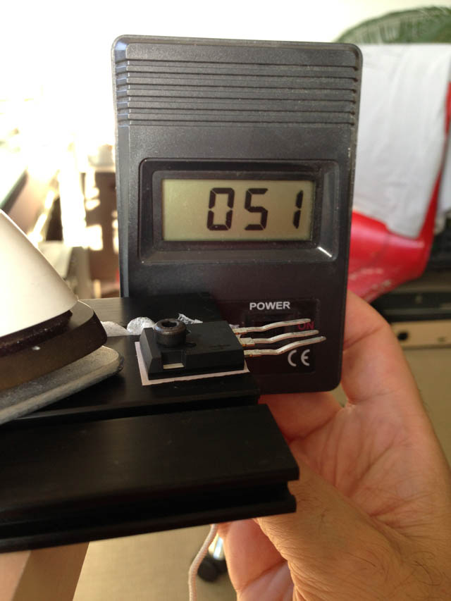

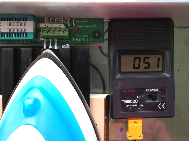

wanted to measure my transistors at operating temperature of my class-A amp. I found a way to do this and thought I share it here. May it be useful for others :D
Pictures speak for themselves....
You need:
- An aluminum strip, and transistor (isolated) attached to it.
- Digital thermometer attached to aluminum strip (probe close to transistor)
- electric iron (or similar)
What needs to be determined:
I noticed from other temp measurements in real amps- where the transistors are heating up the heat sinks: When heat sinks have 50 Degree Celsius, the transistors can have 70-80 Degrees Celsius.
If you are heating the heat sinks, to simulate such temperatures of transistors, you need to take that into account.
-Oliver

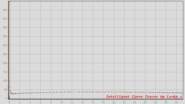

Measurement of hfe-ic curve, At the begin section have some a great value.
Becauserthe initial value of VB is too small, the Ib and Ic also small, then measure the voltage on RB/RC accuracy is poor, and hfe=Ic/Ib will change greatly.
To solve this , set the begin value of VB bigger.
