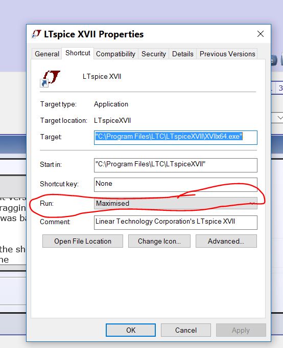

I've found one peculiarity, and its one of the most basic of all. I could not get the program to open in a 'maximised' state. I tried both the 32 bit version and the 64 bit on an old Acer and a modern Dell respectively. Both are running W10. Even manually dragging the borders failed to work in that as soon as the program was closed and reopened it was back to the 'restored down' size.
A simple fix that does seem to have worked is right clicking the shortcut used to open the program, selecting 'properties' and then changing the 'run' dropdown menu to show 'maximised'. Click apply after altering this.
Very strange problem because the default setting is to run as a 'normal window' but I just could not get the maximised setting to stick.

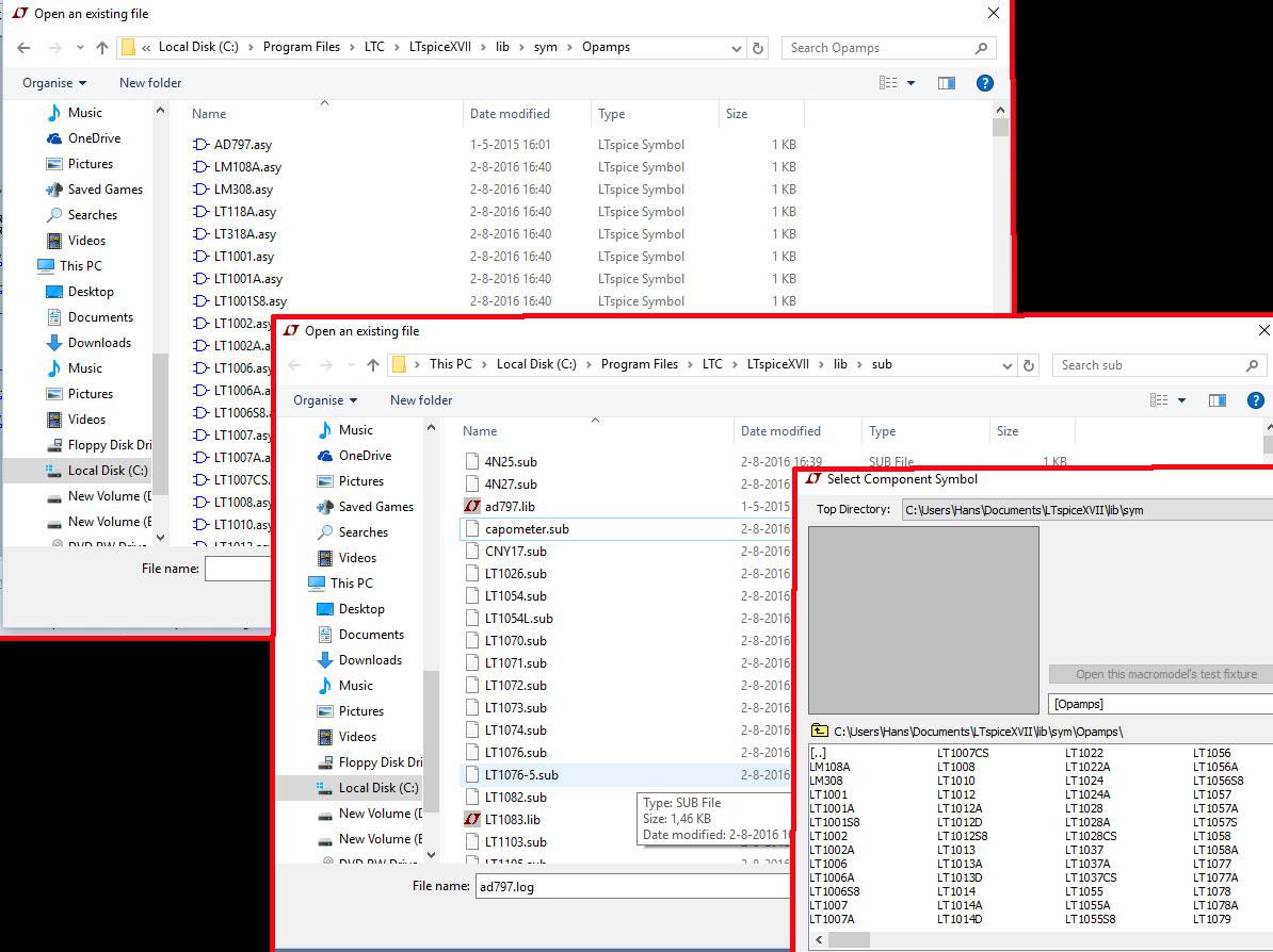

I have installed LTspice XVII, but although you can insert non Linear Technology OPA's in the LIB/SUB/ and the symbols in LIB/SYM,
however when trying to insert them in a circuit diagram the OPA does not pop up in the list ???
This differs from LTspice IV, where foreign OPA's can be inserted and used.
In this case it concerns the AD797
Hans

Thanks djoffe for your assistance.
I can add to this that you don't have to place the component in a separate directory.
I had the AD797.Lib already included in the LTspice/Lib/Sub and tried your trick with a rightclick on the .SUBCKT line.
It works like a charm, and the way to find the OPA is indeed by clicking on [Autogenerated] in the components list.
Hans
The funny thing is now that the whole "LTspiceXVII/LIB" is now also copied to "This PC/Documents/LTspiceXVII/LIB/"
In LIB/SYM/ you will now find the AD797.ASY file in /Autogenerated/.

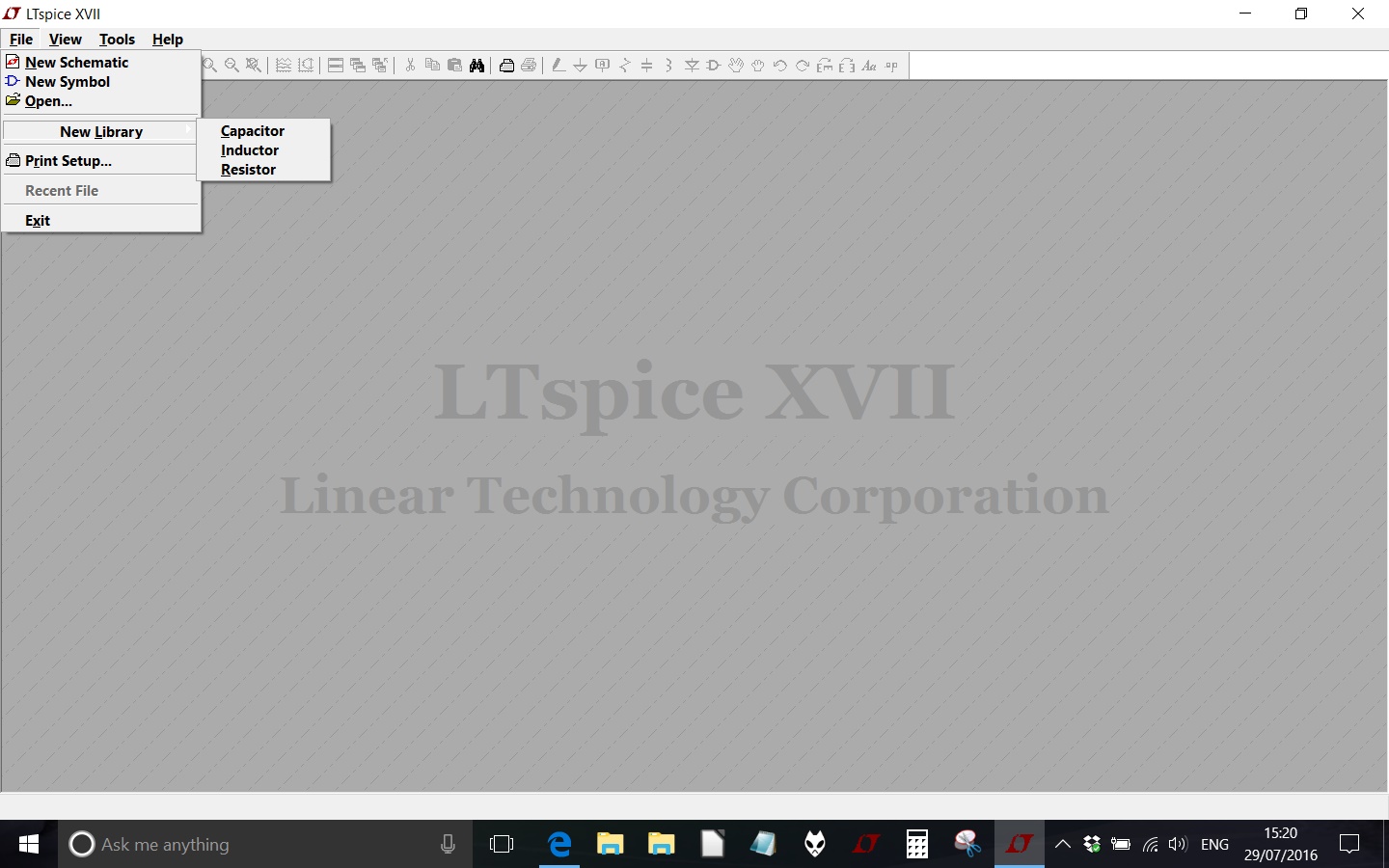

Noticed an obvious flaw... Parameters defined for the transient analysis in a current schematic appear not to be correctly read into the new version and are displayed in the AC department.. also other settings (octave, decade... etc.)for the AC transfer function are lost. One has to re-enter them to be able to run the analysis...
Verdict... some nasty details have to be fixed...
