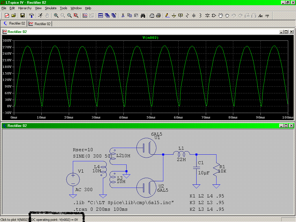

Hi all here.
I've some questions on LTSpice. As you can see in my threads, i use it not too extensively, but it is the clearest way to show how a circuit works. But sometimes I obtain strange results from it.
As an example, when trying a full wave rectifier with input choke filter, as in the image below, and placing the prove at both sides of the inductor, I have:
Note 0V DC ‼
Why?
Suggestions will be appreciated.
Many thanks in advance.

Inductors without DC resistance don't have DC V across them
to get the difference you left click the node, hold the left button down and move the probe to other node you want to difference
the waveform label should look like V(n001,n002)
you can add series R to a Spice Inductor - either a added R or invisibly to the schematic in the L model dialog box by right clicking the L body
you can probe the current directly too if that's what you really want to see

Thanks, but it is obvious, is a simple piece of wire. When I put the prove, i'm measuring between any of the filter inductor and ground. The circuit has a rectified senoidal wave, but appears to not have DC at the output. In both of them I must have the same DC voltage.
The filter inductor has a non visible 700DCR, and I tryied both tube and SS rectifiers in the simulation. The same strange end.

I've a hunch what Osvaldo is getting at here...
Because the only voltage source in the simulation is an AC one (and also because this design is transformer coupled) the only 'simulation type' that will run is the 'Transient' one. So you are viewing all the points in the circuit as if you were using a scope probe.
The DC voltage is shown as zero at all points because the circuit can not run the 'DC op Point' solution because there is no DC voltage source present.
Does that make sense

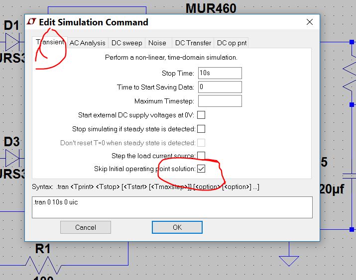

When you run a 'Transient' simulation, the program automatically does a DC operating point solution as well. The result of that is always going to be zero on circuits like this because there is NO dc source present.
You can disable it attempting to do this by ticking this box.

OK, excellent guy. Many thanks ;-D
