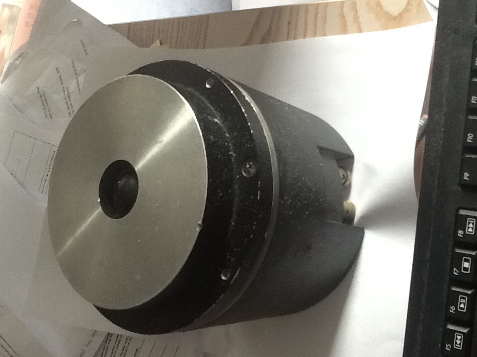

Info on the Yamaha JA-6681 compression driver

1) Meyer managed to patent the drivers that Yamaha produced (this is a US patent). There are two patents. How this happened is entirely unclear, especially since it appears that the production of the 6681B in Japan predates the patents.
The 6681B was only made by Yamaha, as early as in the 70's. Possibly Meyer first got that driver from Japan, found a way to "tool" it themselves, applied for a patent, which was in 1978. A clever move. That happened a lot. Peter Qvortrup from Audionote UK patented the name Audionote. Who was there first: Audionote Japan or Audionote UK? Guess who! Kondo-san was not allowed to use the name Audionote anymore. Thats business, politics, but does not say anything about who designed what first. Now we have an Audionote Ongaku UK. Is it the real one? There is no question about who designed, built and invented the 6681B. Period!
2) Meyer says a lot of things, but there is zero difference other than the doping that Meyer put on the diaphragms and the label on the back between them.
WRONG! If you had many of those Meyer 1401's in you hands and you did not find at least those dampers on the diaphragm, maybe the latter was misused as a contraceptive and those dampers were "in the way":eek:
3) The 6681B has always been a ferrite magnet. See their original ads. They show a cutaway. Yamaha did make another model that was Alnico. Afaik, it had a standard diaphragm.
Original ads in USA those are. Meaning when built for the USA, it was with ferrite.
4) I have owned, tested and taken apart at least 20+ pairs of these drivers, all originally sold by Meyer with his label, none have shown any signs of ferrofluid. Not one. Ferrofluid can be wicked out then the gap cleaned with solvent. It is a silicone oil with microfine iron particles, so it ought to have no effect on the VC or formers. Ought not harden or thicken over time. Maybe if the VC was burned at high temps it might.
And what if those had been back to Meyer, ferrofluid cleaned off?
The ones (Meyer Sound) which I received from Walt Bender all had ferrofluid.
When you clean the airgap, there might be particles left over. Remember, we are dealing with magnets. So to get any particles out you need a better method.
I use something similar to vaseline which I press into the airgap. Then I get it out with long toothpicks and then clean again thoroughly.
One must make sure that there is nothing in the way of the voicecoil.
But then... you show in your own webside, that you ad ferrofluid to those drivers!
5) I use and have used these drivers down to ~250Hz. with a first order filter, in a home system (mine) for years. No problems at all. Would not suggest doing this for PA/SR work, or if you want to run at PA/SR levels. Just FYI I have played live as a band mixed with my system as the only in-room monitor, modest levels, probably ~95-97dB SPL average. Again no problems with the drivers.
Well you are entitled to believe what you wish.
I know Peter Q, there is zero doubt that Audio Note Japan came first.
John Meyer never built the 1401 driver.
Some have dampers, some do not.
Some have dope on part of the diaphragm
Some have dope on the whole diaphragm
Some have no dope at all
Some have have dope on the VC leads some don't
Some have foam blocks some don't.
None of 40+ drivers I have had in my hands, from various sources showed any signs of ferrofluid. Doesn't mean it was never used or should not be used. Ferrofluid can be a big benefit in some cases.
Sorry, I have japanese language ads.
Doubtful given the number I have checked.
How many have you checked?
I knew Walt. It is possible that he installed the ferrofluid.
The ferrofluid isn't "in the way".
If you reduce the ferrofuild in the gap by a great enough amount, it will not even touch the voicecoil. So this is a non issue.
The people who sell ferrofluid will explain the proper way to remove it. Adding in vaseline is not part of the proper plan. I'd never introduce a petroleum product into the gap unless I was 100% certain I could solvent wash it out completely.
I do not believe that is the case. I may have made reference to ferrofluid in other HF units, in specific the Focal T120 series. Link me the page - however I did have the intention of trying ferrofluid on the compression drivers, but never actually got to it. :(

I have a pair of the matching and huge 4281B Yamaha bullet tweeters I'll be listing in Swap meet shortly. 108db/watt. Same physical size as a JBL 2440 mid driver
