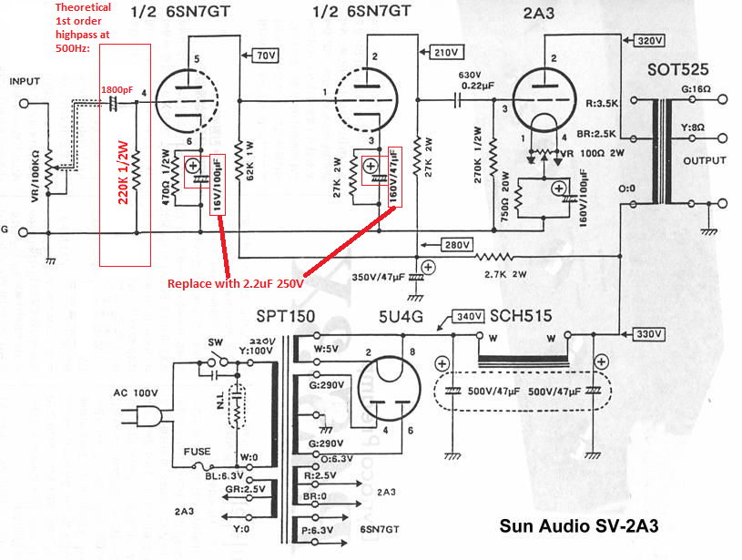

You mentioned before you put a passive crossover in the tube amp for a biamping the JA6681B. Would you explain to me how I could make this Sun Audio 2A3 tube amplifier have a 1st order highpass@330Hz before the output transformer? http://www.goodsoundclub.com/Site_Images/Sun-Audio_VT-2A3_3.JPG
With a protection capacitor at 330Hz value (30uf?) in series with the plus pole of the JA6681B I can get a 2nd order highpass in total. Right?
BTW, I am not willing to not use a protection cap with these unobtainium diaphragms. ;)
You cannot use the Yamaha (or Meyer) from 300Hz on. No way. It has to be used 450/500Hz.
You idea of a protection capacitor in series: Either you go passive-active, or you remain passive. To mix both is the sly-mans way of self-delusion. Why passive-active when killing it right away with a passive capacitor.
The protection of a C-R passive network at the input of a poweramp with 6dB is higher than a 12dB passive network.
You Sun-Audio, with its 100kohms input attenuator is a very straight usual design, the 6SN7 a kind of octal-version of the 12AX7.
Try (after the attenuator) 1800 picoF in series and then 200kohms resistor parallel
on ground (parallel)
A mathematical calculation is one thing, checking it with measuring instruments and fine-tuning another.
For the woofer-amp, no attenuator (no need for it, it has less efficiency):
68kohms in series, then 3000picoF parallel AND 200kohms parallel (first the C, then the R, i.e. on ground)
A better approach here for the wooferamp would be with high quality inductors, but those one would have to make oneself, as hardly available.
That .... in both cases is the -3dB point for 500Hz.
The midhigh-range amp can have much lower value cathode C's (AND HERE YOU
GET YOUR EXPTRA PROTECTION):
instead of 47uF and 100uF, use 2,2 uF high quality foil-capacitors. No need for V-Caps or similar, but I would use 250V or higher.
Is this what you meant?

passive-active network for bi-amping
Yes, thats right.
Start just with the 6dB network at the input and listen.
I have calculated the network regarding you using the Yamaha with its
107dB efficiency, matching an about 100dB woofer system.
The critical point is the attenuator, one needs it to attenuate the driver
for any compression-driver usually will be more efficient than the woofer.
Because here we have not a fixed impedance but a variable, the only fixed impedance is the input R of the 6SN7.
Try to find somebody with an oscilloscope and a frequency generator. Run
the frequencies from 1kHz down to 200 Hz through your amp and see when you find the -3dB point. Adjust accordingly. Then apply the kathode C's and check again. That's the way to do it correctly
Okay, I will try to change the bypass cap and see what happens. I can use a software tone generator and a record a cheaper speaker with a mic. According to the calculator a 2.2uF would start decreasing below 1kHz. I should try maybe a 10uF bypass caps as well.
Regarden the attenuator - the Sun Audio 2A3 clone is integrated and I have a 100K Alps volum pot. I will put the PLLXO after the pot like in the schematic. The 15" JBL woofers have a more powerful amp anyway (800W PA amp). My woofers are actually around 100dB (~105dB in the horn?). Why would it matter though? I will use two amps in this experiment, each with its own volume pot. Right? If so, I wonder about the split. I would like to run it directly from the DAC into the tube amp without an active or passive splitter.
I have ordered some nice silver micas and teflon caps from Russia to make the PLLXO crossover you suggested. But then I read a guide to PLLXO and in that sheet the values where quite different than yours...
The guide with schematics: TLS.org | Passive Line-Level Crossover
Link to the excel spreadsheet: http://p10hifi.net/TLS/downloads/PLLXO_Calculator.xls.zip
When I put in the same values I don't get the same results as you at all. Also, if I would try 2nd order PLLXO I would run into trouble because the Sun Audio 2A3 has a 100K input impedance. It says in the spreadsheet that anything above 50K means that you should not use 2nd order.
Filter
Okay, I will try to change the bypass cap ....
You don't change any bypass caps, you are going to introduce a filter 1st. order
into your poweramp. The input C acts as a coupling cap and with the R as a filter.
The other C's are kathode caps
...and see what happens.
I hope you don't see much (i.e. fire, smoke, explosions
but that you HEAR..... music
bad idea. minus + minus doesn't make a plus in this case or eliminate errors.
You need to use a correct set-up. Find an engineer who knows.
If you are building amplifiers and do not use an oscilloscope... well....
With 10uF you go down in frequency. This is a cathode C
It matters, because you do NOT have 100k input impedance. Think about it
and find out why!
Sounds terrible, to use a 800W PA mudmonsteramp with a medicore 15" JBL
(have not found any useful JBL woofer yet, Lansing yes, but not JBL)
Kind of disimprovement. Wonder what midrange horn you are using.
better Right and Left, you are running two channels
Bad idea. You DAC most likely is not low enough in output impedance and strong enough to drive two stereo poweramps.
And what are those silver micas for?
possible start
but:
what defines the inputimpedance of your amplifier.
If you do not understand this, you should not use calculators like that.
Which components are there in the input, and which components are
variable in value and have to be estimated in relation to a desired result?
When I put in the same values I don't get the same results as you at all..
Does it really?
And why the heck use 2nd order anyway? What good is it for?
Which DAC are you using?
Which preamp do you have at hand?
Which music is your favourite and you are going to listen to with this equuipment?
Addition: Filters for passive network in amplifiers
you have 3 x cathode C's:
they act as frequency filters (with their resistors).
You can calculate this very easely:
1/(RC)=2*pi*f
with f=frequency, pi=3,14...., C in farad, so *10^-6 for µF, R in ohms
For the input filter, the calculation is much more difficult because it needs to take into acount the capacity of the grid / cathode of the input tube AND the frequency filter of the cathode C and R
If you calculate just the first cathode C correctly and you have verified through measurement, that it works at 500Hz, only then you can start working out and calculating the input filter. Nevertheless, I would continue with all other cathode C's as well.
Lets put it like this:
An exact filter through corrected/altered C at the first half of the 6SN7 will work as a -6dB slope alone!
And that's already 1000 x better than ANY passive -12dB network between amplifier and horndriver. Period! I have verified this many many times. To me, passive filters are sound-killers. But everybody listens to them, is used to them. They act like a heavy curtain which obscures light.
This is the only reason why in certain circles high efficient horndrivers are despised, they say that horndrivers shout, have colourations. They hear something right there, i.e. the colouration and mess of the passive networks. Its not the driver!
So back to the passive/active filter:
To make it perfect, you calculate (and verify through measuring) the cathode C's of the second half of the 6SN7 and cathode C of the 2A3.
With this formula: 1/(RC)=2*pi*f you calculate, with frequency generator and oscilloscope you verify.
Then .... and only then, you can calculate the input-filter!
You have now the new parameters of the input tube, its capacity (grid/cathode) and you have a variable resistor at the input (100k log or lin potentiometer, log is better of course). The 220kohm resistor defines a given input impedance (I hope you got this from my first posting!). You need a fix input impedance to calculate because you cannot use a variable 100k potentiometer, because it is variable. This should be clear as springwater! The variable 100kohms potentiometer has an effect on the input impedance anyway! How could it be otherwise? But we know that this potentiometer is needed to attenuate the compressiondriver. So you could just use 4700 pF here if you can't measure. It then acts just as a savety filter.
You took it that your amplifier has an input impedance of 100kohms, but I hope now you understand that this is wrong! You need to "give it" a fix input impedance and thats what the 220k resistor is for. The 220k value is chosen because of the 100k potentiometer.
If there would be no potentiometer, you could also use 20kohms, but that is theory and depends on other factors (for example in studios they use 600ohms balanced via input- and output transformers. Here one would have to work completly different (i.e. cathode C's)
A third place where you can change the filter is the coupling C itself between the driver 6SN7 and the 2A3: here 2,2uF/630V.
You see, this is not so easy. It needs somebody who understands the basics and can work with these formulas and measurements like a professional cook works with salt and pepper: He does not need to think anymore about salt and pepper, or how much heat for which meal or how much water for noodles, he just "does it", it is in his system, it is almost an automatic process.
These formulas and verification are the salt and pepper for this very cook called engineer. But these days we have so many cobblers. They do not understand the basics but then produce tubeamplifiers which when on the table of a real engineer "shocks even monkeys" (Peter Gabriel)
I have now given a lot of time to explain this. You have now the basics, but you've got to do it right. I.e. you need a good engineer who understands and who will help you. This should not be really expensive, but it is worth it!
