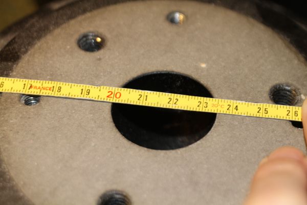

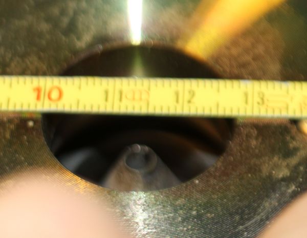

Hello Bear,
On one of my JA6681, opened for verification, I could measure 35mm for the main throat and for the smaller which appears after removal of the front part (throat part) I could measure 27,5mm (so not exactly 1 inch)
See attached pictures.
Best regards from Paris, France
Jean-Michel Le Cléac'h

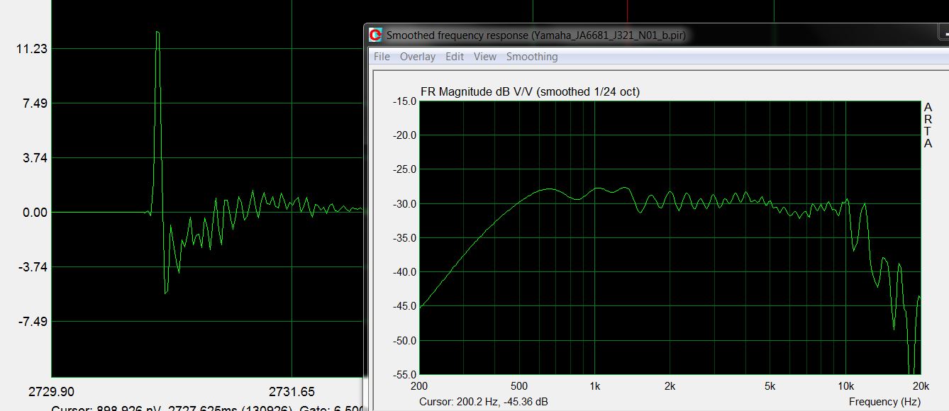

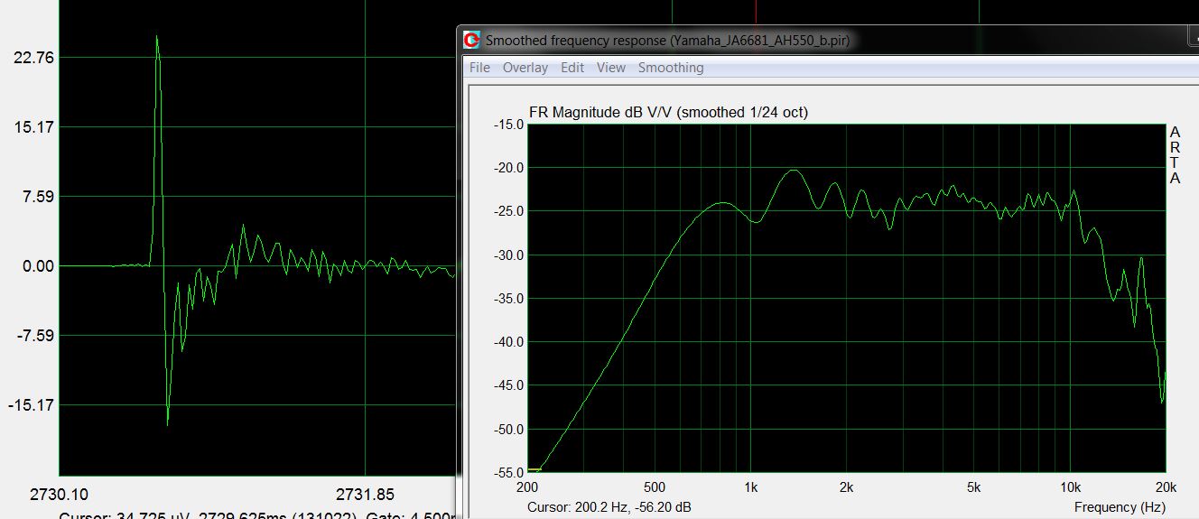

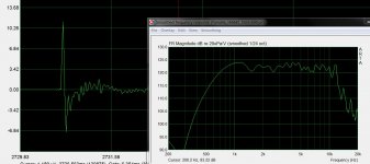

Hello,
Here are 3 screen copies (from Arta audio analysis software) showing the beautiful shape of an unequaized JA6681 on 3 different horns :
- AH550 horn (an axisymetrical Le Cléac'h horn with Fc = 550HZ, built by Martin Seddon in Australia and sold under the brand AzuraHorn),
- J321 horn (an axisymetrical Le Cléac'h horn with Fc = 320HZ, built by Marco Henry and used to be sold under the brand Musique Concrète )
- E-JMLC 600 horn (a non axisymetrical Le Cléac'h horn with Fc = 600Hz, built by Autotech in Poland).
If a better adaptation was provided between the JA6681 (27,5mm throat) and those horns (25,4mm throat) may be the treble will extend at 20kHz, but still the extension in treble is excellent.

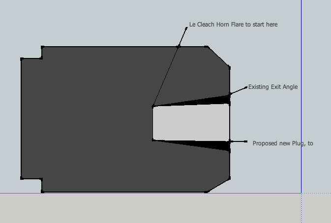

Jean-Michel,do you think a metal plug which fits tightly into the drivers throat and exits at what a LeCleach horn would be at 35mm along (a LeCleach horn profile) the y axis be a worthwhile improvement?
I imagine the 27.5mm to 35mm expansion to have some negative impact.
Hello 3GGG,
I would recomand to remove the throat cast metallic front part of the JA6681 and to start from the plane at the apex of the phase plug inserting some annular part in the 27,5mm throat and prolongating then in a Le Cléac'h horn. (an angle of 0° or lesser than 5° can be considered).

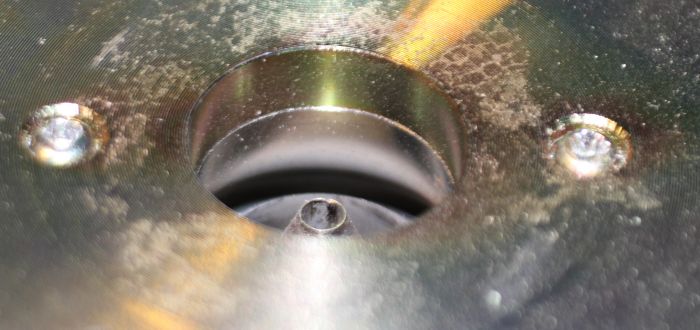

How would you attach the horn without the cast? The surface underneath is shiny metal without holes, and I don't want to drill so close to the magnet.
I used a digital dial caliper.
The smaller measurement was to the bottom of the pole piece, not the exit of the pole piece. I can do this since I have one driver that is truly completely disassembled. Pole piece removed from the magnet. Do not fear, I did not destroy a useful driver - it was submerged in salt water and was corroded and covered with salt deposits.
3GGG, if you have a lathe, there is enough "meat" in the casting to move the angle a few degrees. Otherwise you have to machine a new piece for the job.
Rewind, how is the present front held on? You could work off those holes with a new piece/adapter to mount the horn?
Those screws are too tight. And the driver is so beautiful with that fake alnico extension.

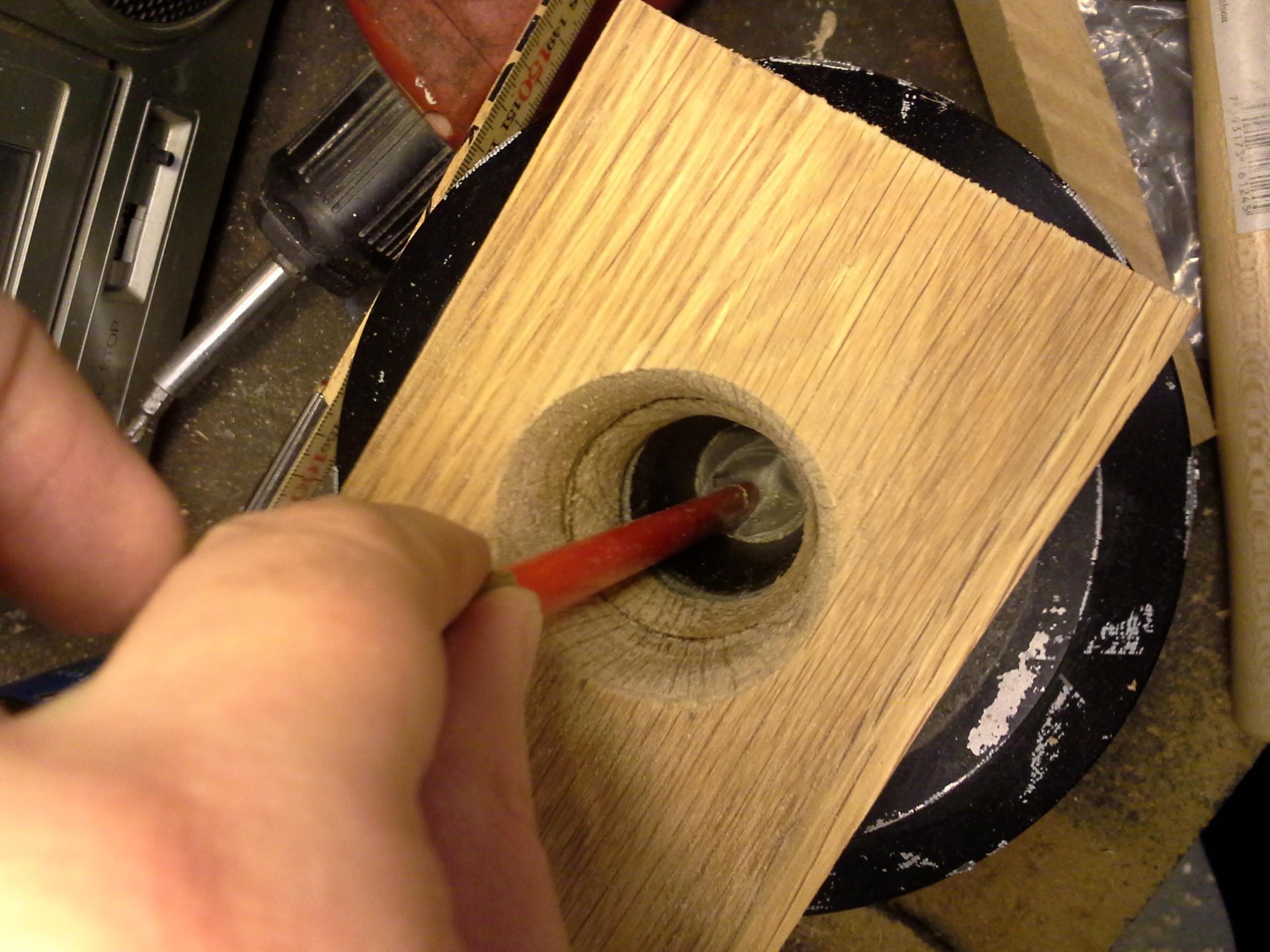

I managed with a method I have come to call the pen-trick!
If the pen is pushing away your new horn throat, when it is aligned with the drivers throat, then you still have some more grinding left to do.
