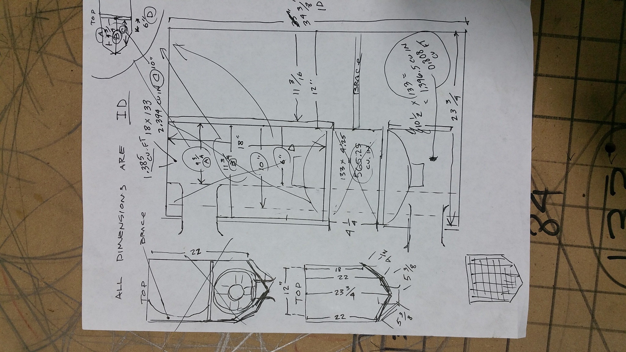

This is VERY preliminary and subject to change. Dimensions won't be correct but internal volumes of chambers are as stated in the drawing. The coupling chamber is completely ignored, it's not here at all. Ports are obviously in the wrong locations but I can't change that in Hornresp, that's a job for Akabak. Drivers are series iso connected and response is shown at 1 watt in reference to the 15.something ohm load.
Check my inputs and math.
3 7/8 inch diameter ports = 76.05 sq cm
6 inch port length = 15.24 cm
If there's any mistakes here let me know now.
I'll update the dimensional info when I get it. But assuming there's no glaring errors here it won't make a lot of difference.
Once I get the properly dimensioned Hornresp sim done I'll export it to Akabak, add the coupling chamber and see what difference that makes. I'm guessing none based on theoretically perfect cancellation.

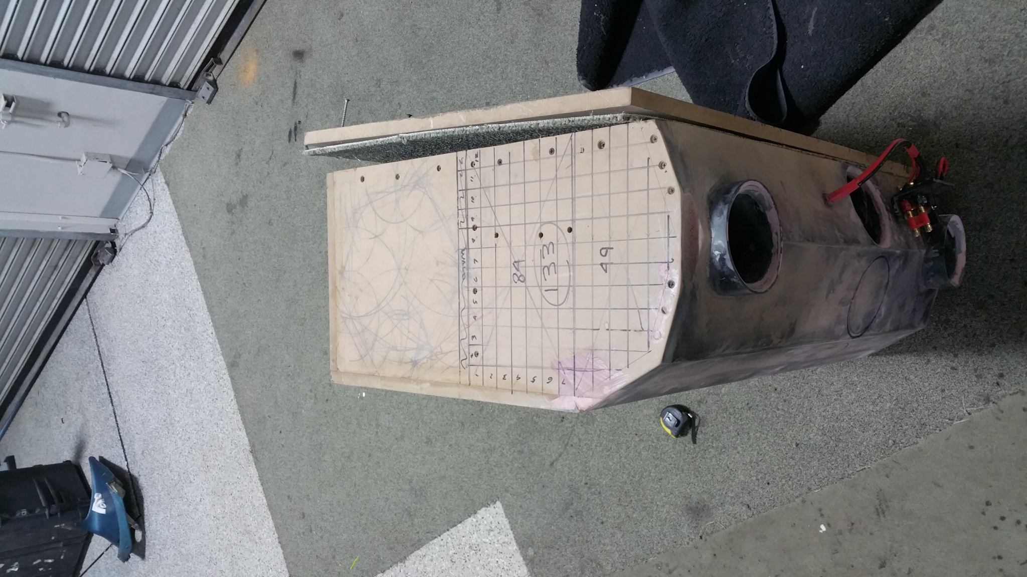

I made it difficult with those angled front panels.
I can't find my angle finder right now. Although the angles were based on platonic solid models from another project.

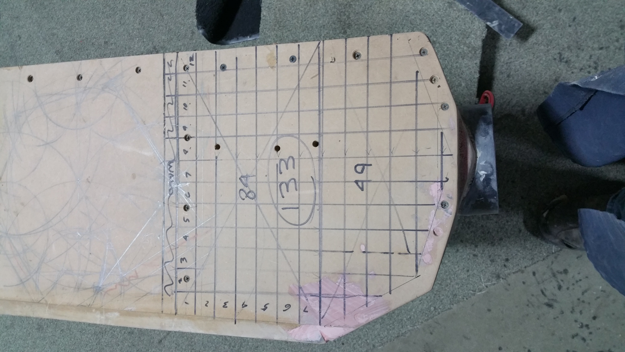

The way I got the cu. Ft. Is shown in the pictures.
I basically counted the sq.in in one layer then x x h
Sorry for complicating things you will think I should grow up, when you find out the reason for angles
Pics to follow.

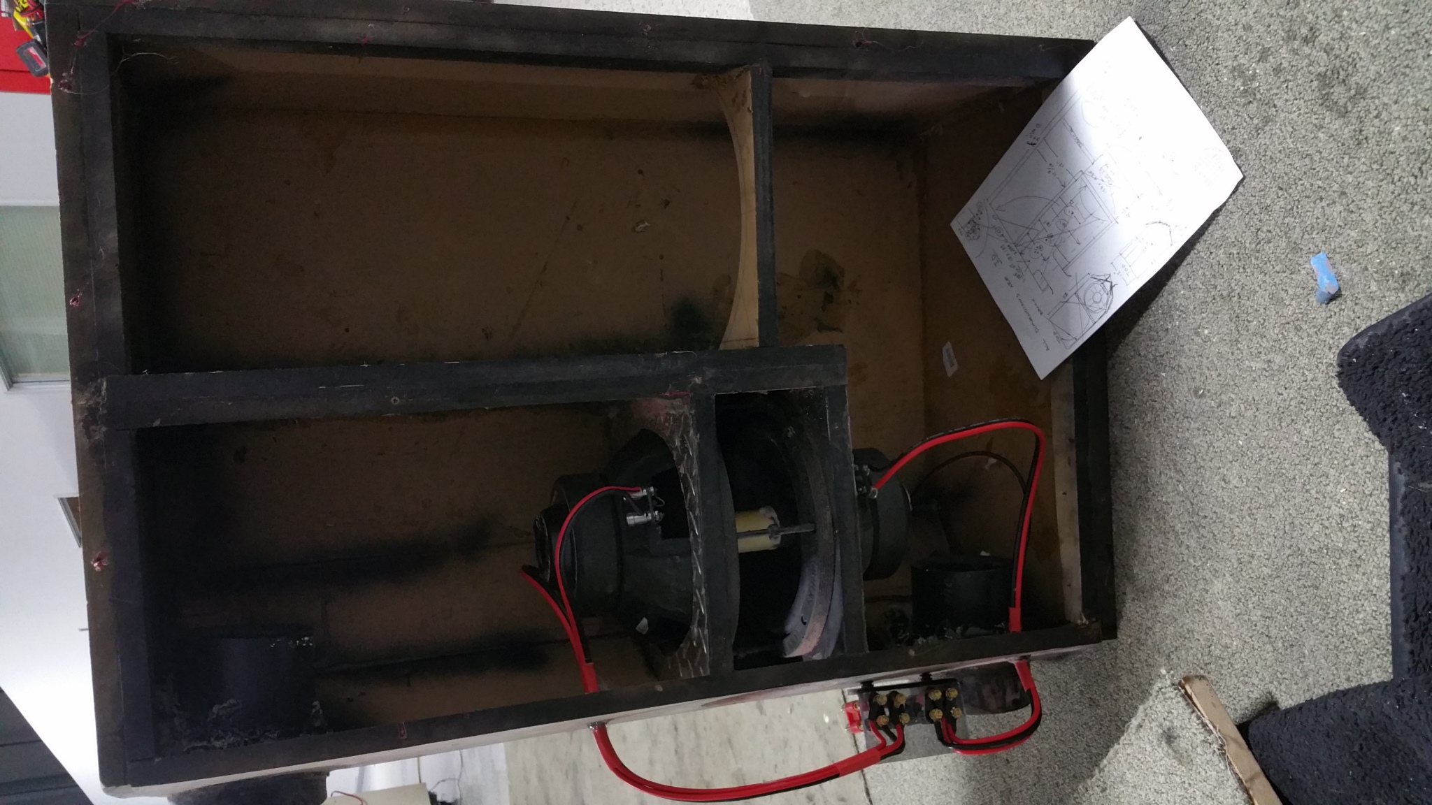

The center chamber makes a considerable improvement in the sound quality. Maybe the nearby ports are interacting interrupting stasis of the cancilation. ?
The port delay phasing with canciled wave
The biggest effect of having that small coupling chamber opened up is that it's going to let high frequencies out. The driver response will extend to very high frequencies and then you have cone breakup and stuff, noise, coming out of that hole.
But as previously stated, the net pressure and therefore net spl is theoretically zero as the volume of air in the chamber is theoretically always exactly the same. Thus theoretically there can't be any resonant output, and theoretically there shouldn't be any high frequencies coming out either. But in the real world you never have perfect cancellation even with physical coupling so any differences will sum to something higher than zero.
One thing you can be sure of is that there's no low bass coming out of the small coupling chamber. Anything that gets out is going to be at the frequency of the helmholtz resonance of the chamber or higher. The low bass should be almost perfectly cancelled out.
A frequency response measurement with the coupling chamber open vs closed would shed a lot of light on what you are hearing.

Upon further reflection I don't think there's any way to simulate this exactly as drawn, but I don't think it matters.
I can sim it without a closed coupling chamber just fine (which should be accurate). Or I can sim it without the ducted coupling chamber but without the physical connection between the drivers (this will not be accurate because the bandpass chambers are differently loaded). i don't think there's any way I can set it up to sim both the ducted coupling chamber AND the physical connection between the drivers.
If we have consensus that the small coupling chamber isn't doing anything but letting out high frequency noise that will not impact the simulation in any way I can go ahead with the sim. If not then I can't simulate it.
Because of the angles things are more difficult but the important dimensions are cross sectional area and segment length.
The smaller chamber has a length of 18 inches and a volume of 1.385 cu ft, correct? if so I can figure out the cross sectional area from that information.
The larger chamber, the straight section has a length of 34 3/8 inches, a width of 11 3/16 inches and a depth of 12 inches and this section has no angles, correct?
The last part of the larger chamber has 11 3/4 inches and a volume of .808 cu ft, correct? If so I can figure out the cross sectional area for that segment. The end of that segment will have a slight mass loading at the end due to the angled exterior but I really don't want to break that last segment into 3 segments to reflect the exact narrowing as it comes to the end of the segment. The mass loading effect would be pretty negligible anyway.
So can we agree the small coupled chamber does nothing but let out higher frequency noise? And are the dimensions I just listed correct? i'd like to wrap this up.

So check my math. The smaller chamber has a length of 18 inches and a volume of 1.385 cu ft. This translates to 38.23 liters and 45.72 cm, input into the Vrc and Lrc input boxes.
The larger chamber, the straight section has a length of 34 3/8 inches, a width of 11 3/16 inches and a depth of 12 inches and this section has no angles. This translates to a cross sectional area of 866.24 sq cm and a volume of 75633.72 cu cm (75.6 liters) input into the Vtc and Atc input boxes. I had to use the throat chamber inputs or I wouldn't have enough segments to complete the sim.
The last part of the large chamber is 11 3/4 inches long and has a volume of .808 cu ft. If this part of the path didn't have angles it would translate to a cross sectional area of 766.5 sq cm and a length of 29.85 cm.
That last part of the large chamber is a problem, as it does angle down towards the port end which will provide a bit of mass loading. But I don't have enough segments in Hornresp to accurately simulate that and it won't make a huge difference.
Both chambers have a port that is 3 7/8 ID and a length of 6 inches. That translates to 76.05 sq cm cross sectional area and 15.24 cm length.
The ports in this sim are not in the right spots, I would have to use other software to simulate their correct positions. It won't make a huge difference though so I'm not sure I should bother.
The coupling chamber is completely omitted in this sim. I did fool around with adding it in Akabak, both with the coupling chamber ported and closed. And since I was not able to physically connect the cones it did make a bit of difference in the sim (since both drivers have a different load presented to them they won't move in identical fashion) so the frequency response was slightly different and there was a bit of output from the port. But theoretically, as we discussed, with the cones physically coupled there should be no pressure changes ever happening in the chamber and no spl coming out of the port. In real life there will be some output since there can never be perfect cancellation, especially with each cone seeing a different load.
So anyway, this sim is definitely not completely accurate but it should be pretty close. As I mentioned, the small changes in dimensions do not make a huge difference compared to the original preliminary sim.
