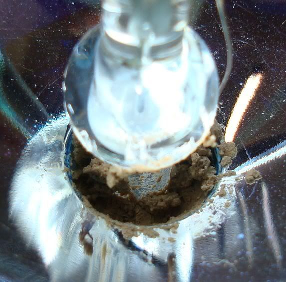

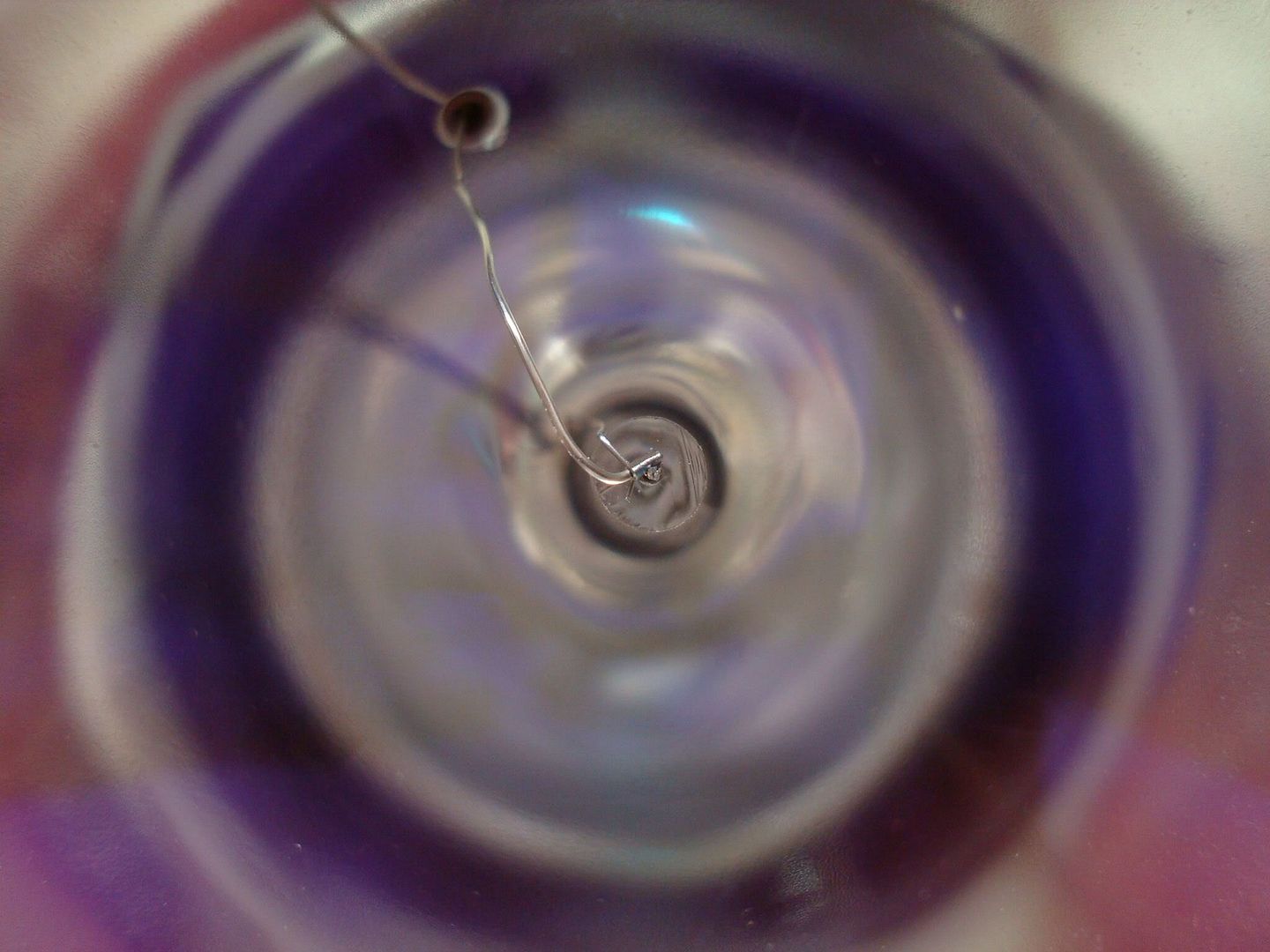

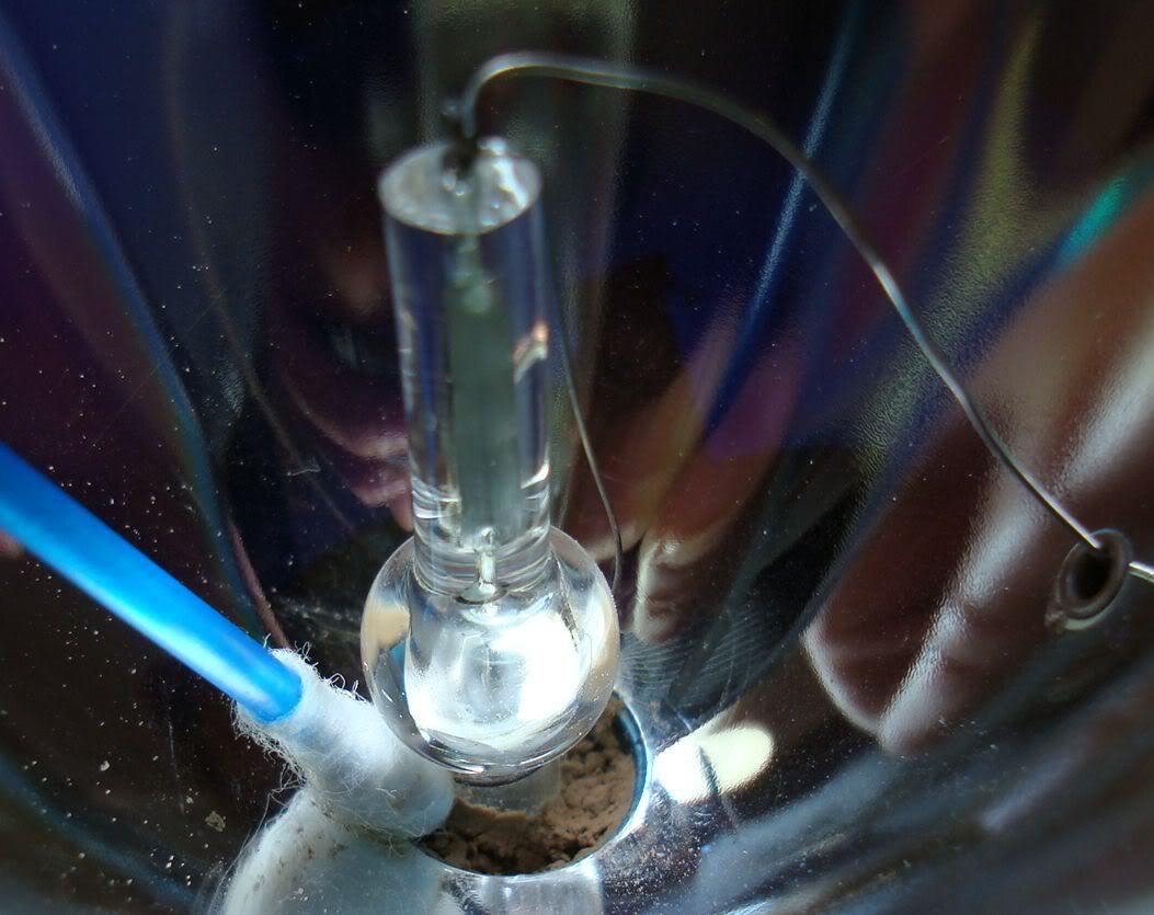

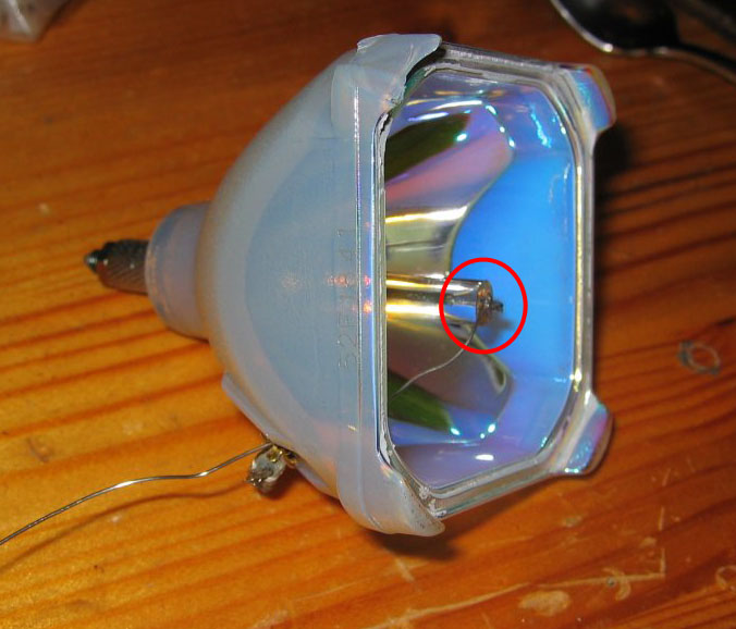

zeims said:I have problem connecting wires in this point... because the wire wasn't connected in it when i got it from ywh. what you use to connect it ?
look at the picture( it is not from my lamp) but shows the problem point.
the only way I can think of without spot-welding is to use the "thingy" I mentioned earlier cut in 2 pieces and filed down to the desired size. See pics below.. I make one for demonstration with my old lamp.
maybe due to its small size it wont affect performance inside the reflector.

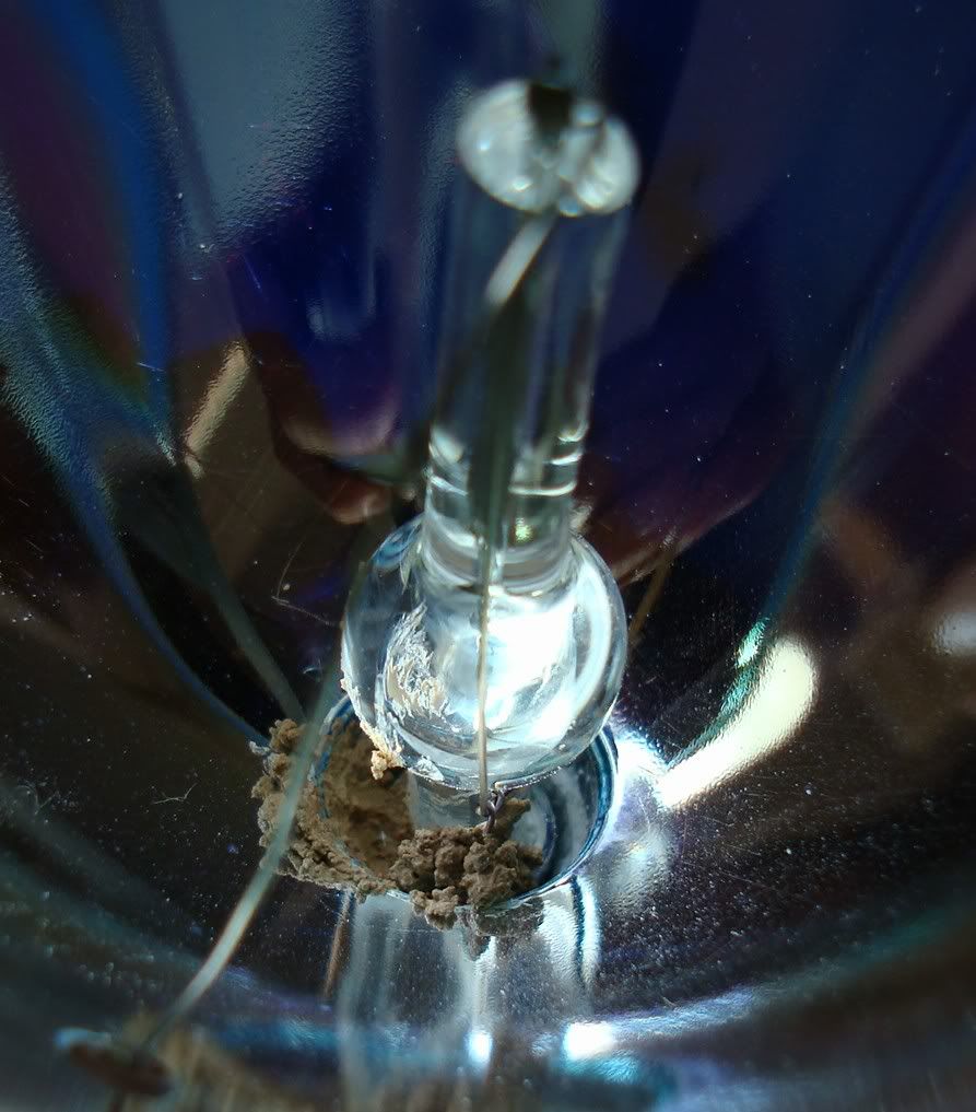

Hi folks!
I finally have installed my new lamp!
The candidate was Epson ELP-3000.
The original lamp is small than new one but the new lamp fits perfect in the reflector and in the original wiring.
The gain in the brightness was incredible and now the colors are natural again!
I'm very happy and thankful to ywh!
Tomorrow I will glue the new lamp with the cement!
Hugs!

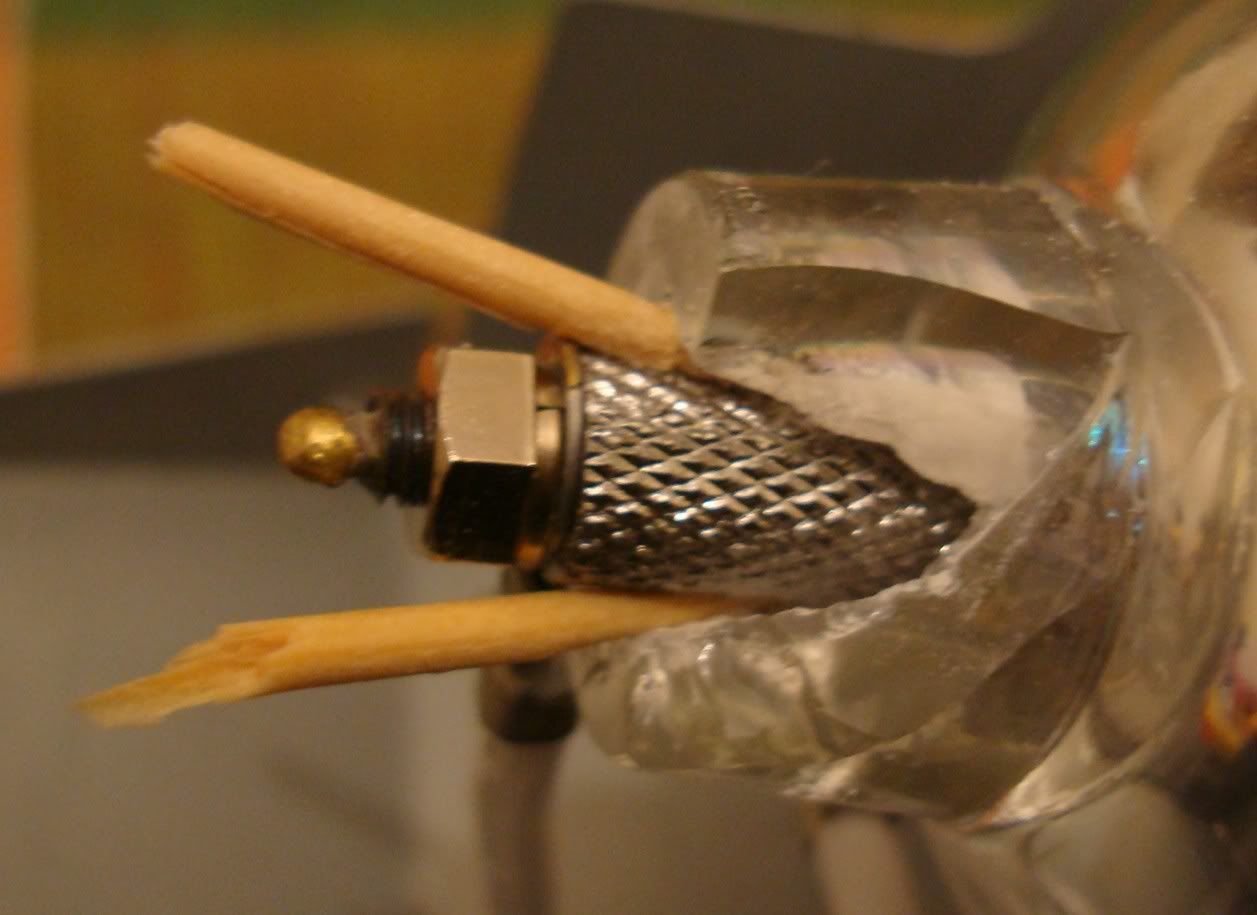

Ri7 said:Hi folks!
how did you perform the test without glueing the lamp?
That's my plan!
The old reflector is fragile...in the photos you can see the broken part.
I will fill up everything with the cement.
Another thing...the original lamp was smallest than new one...but I've measured the distance from the "ball" of the original lamp and put the new one in the same place.
I'll post new photos as soon as I finish it!

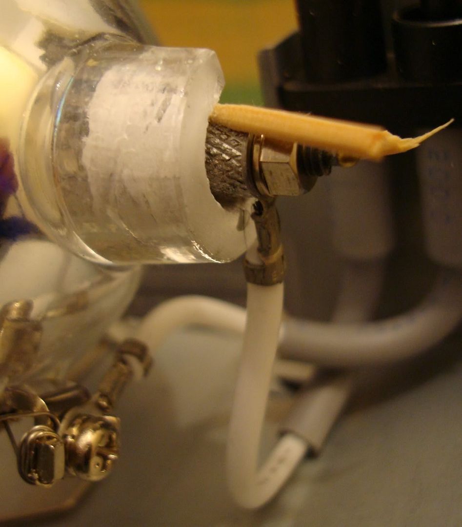

zeims said:TonyMontana
Where did you get/take off that "thingy" ??
You can buy them in batches in electrical equipment stores... see pics:
they come in various sizes and they are cheap..
Keep in mind that I have not tried what I suggested it is just an idea ...hopefully it will work. Good luck man.
zeims said:thanks ! I just found those before you made your post !! I'll buy one tomorrow. I hope it solves my problem
thats good just check which size suits you best...

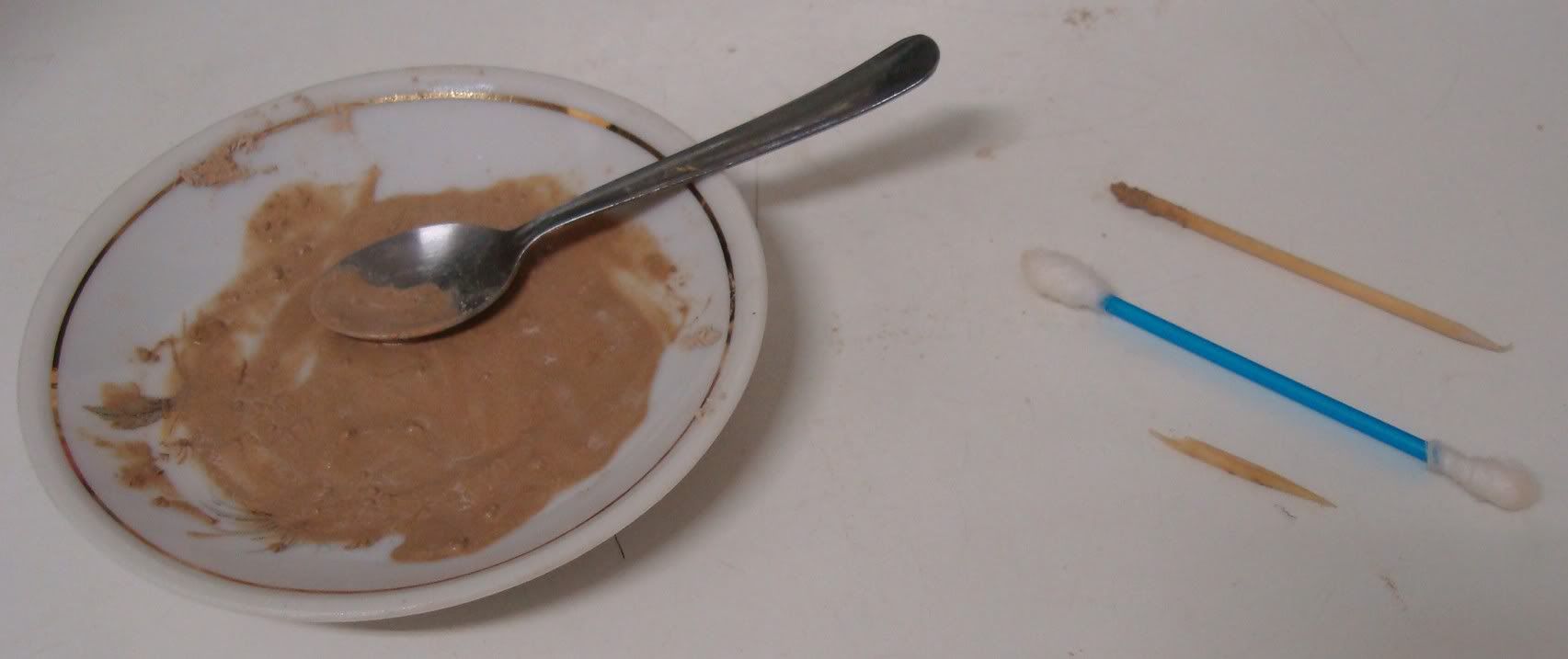

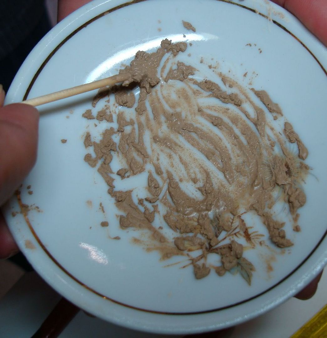

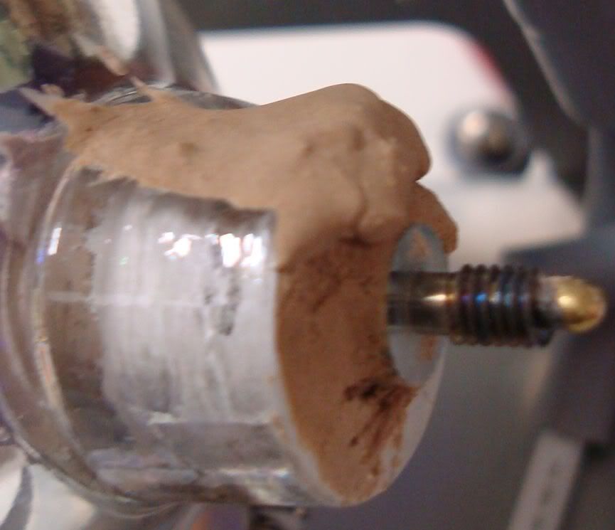

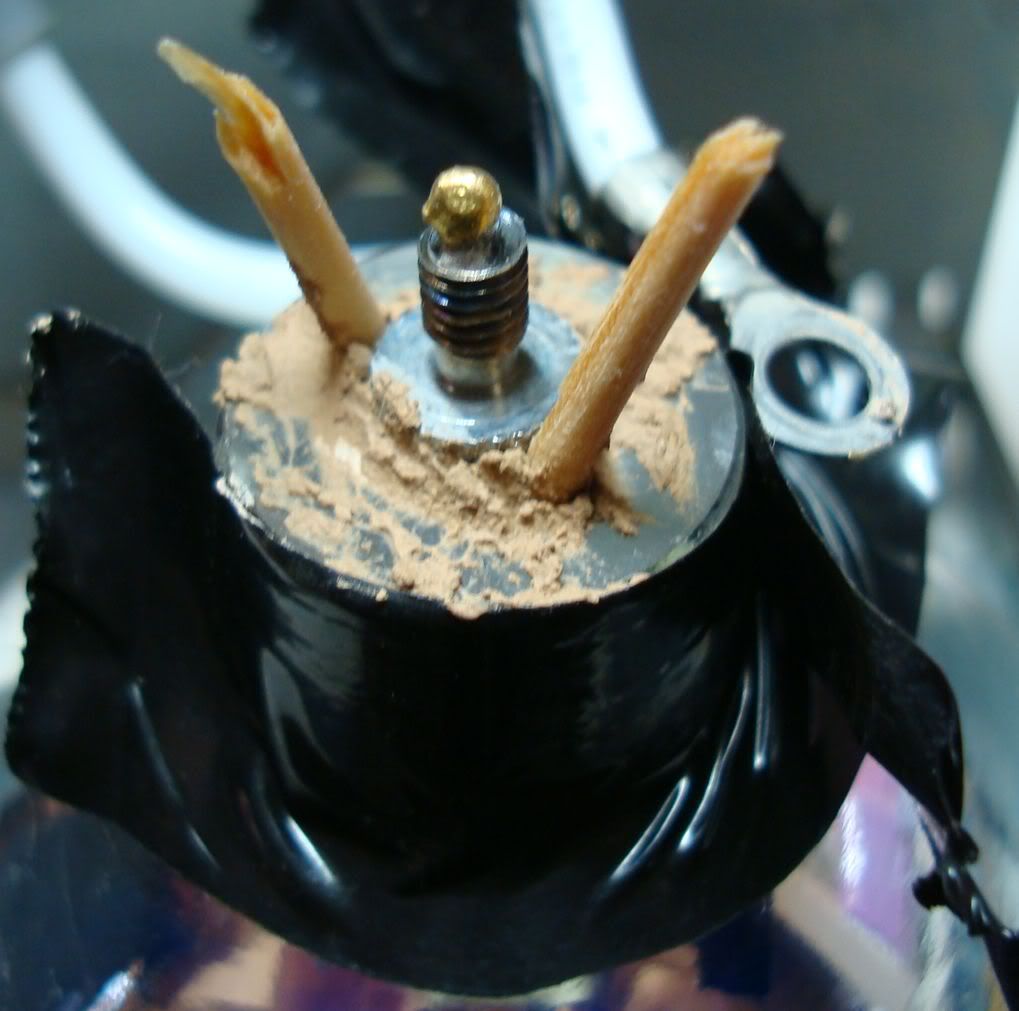

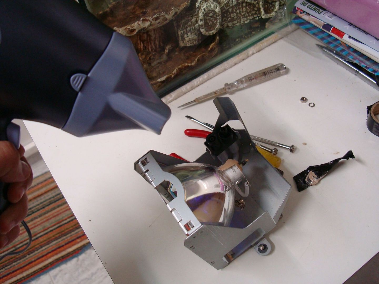

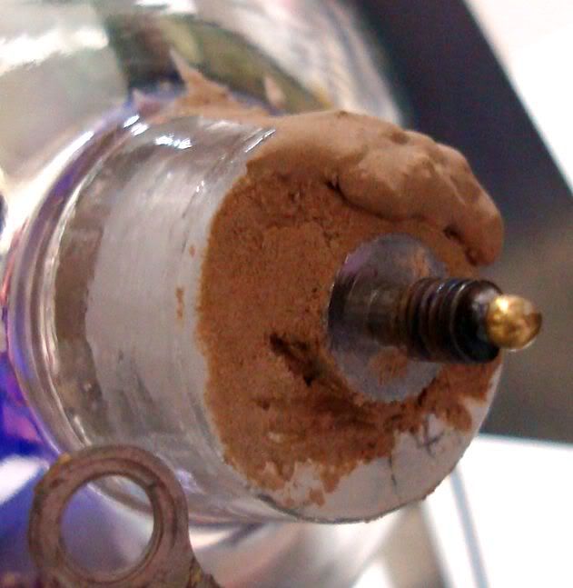

Hi folks!
As I promessed yesterday, here comes the pictures of the final process!
I'd started putting some cement in the lamp side:
Then I covered the reflector with insulation tape and start to fill up all spaces between reflector and lamp:
That's the place where I made the cement with a little water:
Then, I've made a "fine" adjust in the cement by the side of the lamp:
After that, I removed the black tape and fill the broken part of the reflector with cement:
I've used a hair dryer to accelerate the drying process:
My workbench:
And the final result:
Thanks everybody for the help in the process and special thanks to ywh who made all this possible!
Hugs
Ri7
