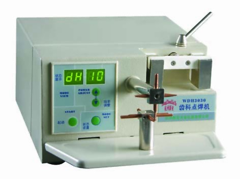

HUH ! at last !! I had problems with wiring.. because I had bad solder.
Now I use the projector and the image, colors, lumens.. everything are just wonderful. Maybe this last longer(1000h) than original bulb!! ;)
Thanks YWH ;)
My test started relatively ok but the brightness went down after some time.. What kind of soldering problems did you have? I also soldered the reflector wire.. should I crimp it instead? I will open the projector again...
I had very interesting soldering problems ;) The solder "exploded/melt" everytime I put the projector on.. next time it didn't turn on, so I had to solder it again :bigeyes: So I decided to use basic copper wire to lace the lamp wire and connect/power wire together (same for both ends). Sounds maybe stupid, but it works because the copper has much higher melting point ;) So you need little finger skills :smash:
Tell me if you have better ideas ? ;)
I was thinking of using this "thingy" that connects together electrical wires (dont know the english word for it) since I only have to do this with one wire of the lamp.. the other end has a screw connection..
Have you considered the copper expanding due to heat thus making the connection loose?
I also need an alternative to cement cause I ran out.. could I use clay? or some cement which I can find in a hardware store?
That's good way ro connect wires, better than mine :D
Yes, I have considered the copper expanding. But I have used projector 3 hours now, works great ;)
I have heard that using chemical metal is easy. It works great ! Maybe you get it somewhere ;) I think u can use any material which holds the bulb and doesn't melt/burn in the heat. So any cement should be fine.

about solder, you can ask a dentist to help you if that is free;-), he has a spot welding instrument, look the picture.
you need spot welding wiring.
