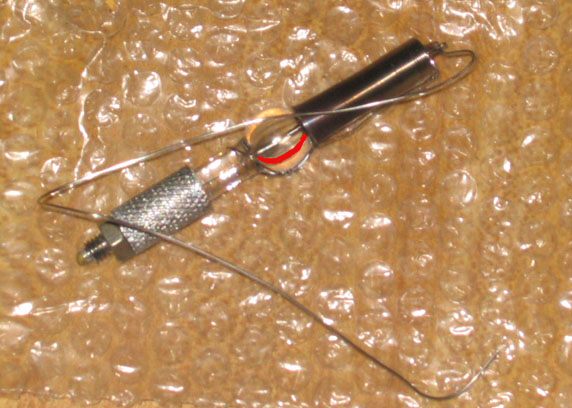

This is whats left of the lamp pulled out of the housing:
This is the lamp that arrived:
I guess I needed a singled ended lamp? I thought because
there was wires on both sides it was double ended. Is there a way
I could send this back for the correct lamp or will I be able to use this lamp?

AFAIK, the lamp you've got is the correct lamp and the same one as I received for the InFocus X1. The coil of wire around one end is because it's a DC lamp, so it should be fine as long as you can physically fit it in the lamp housing.
You need to watch out for a few things when fitting the new lamp. Firstly, you can't let any of the cement / plaster stuff come into contact with the actual bulb part of the bulb.
If any dirt, plaster, or even fingerprints get onto the bulb part, the bulb won't last more than a few minutes because it needs to expand during use and any contaminants on the bulb will weaken it and very probably cause it to crack, or maybe even explode!!!

AND.... you've got to make sure the wires are connected with the correct polarity with the JYd / JYs DC bulbs - The end of the bulb with the screw thread and nut on is the positive connection.....
If you look at the lamp connector on the InFocus itself, the top hole on the connector should be a square, and the bottom hole should be round. The top / square should be the positive connection.
Please don't rely on this info 100% - If you want to be sure about the polarity, you can test the voltage of the lamp with a multimeter, but ONLY AFTER the lamp is already lit. If you have a multimeter connected when the lamp first ignites, your multimeter WILL be FRIED!! (yep, I tried this with an old MM to see what would happen, and it wasn't pretty).
Alternatively, if you open the InFocus and look inside, the pink wire to the lamp should be the positive connection.
(The bulb will probably light even if the connections are reversed, but this is obviously very bad for the bulb in the long term.)

Bad news on my end though, I connected the lamp to make sure
it fired alright before I went ahead and glued it in the reflector.
The bulb does not work or fire at ALL. I have 2 infocus projectors
that I believe are outputting something like 66.5 volts to the bulb.
The bulb didn't start, didn't blow up, didn't flicker.... NOTHING...

Are you sure the polarity is correct? ie. is the wire going to the square hole on the InFocus lamp connector joined to the "screw-thread end" of the new bulb? I was probably wrong about the bulb igniting even when the polarity was reversed, as I've never actually tried it with a DC bulb, so it was just an educated guess.
The fact that you can measure the 66V on the lamp connections doesn't necessarily mean that the ballast is creating the ignition pulses to start the lamp. The design of some ballasts may mean that the low voltage is present across the lamp at all times when the projector is on, but this is probably not the full current to run the bulb. So, when the projector needs to start the lamp, it ramps the "low voltage" current up to full power, then generates the ignition pulses to start the lamp.
If your original lamp was close to 3000 hours (or whatever the lamp timer limit is, which is dependant on the firmware version), then you might need to try resetting the lamp timer on the Infocus..... Just turn off the mains switch on the side of the PJ, then hold down both of the "volume up" and "volume down" buttons at the same time, then (while still holding the buttons down), turn the mains switch back on and keep holding the volume buttons for about 30 seconds to be sure the timer is reset.
Then again, it could be that a similar thing has happened to your new bulb as what happened with my bulb for the same projector? It was working fine for hours on the first day, but when I tried it the next morning, the bulb didn't start at all, and I noticed a crack in the actual bulb part (like a small end-to-end slice in the side of the bulb.)

@fuerio...... I was just wondering, I zoomed in on the photo of your bulb, and I thought I could see something similar to what I noticed on my JYd bulb.
I've attached your photo, but I've highlighted the "crack" on the bulb in red - Is there actually a crack in your bulb in this sort of direction, or is it just a reflection? Or, is it meant to be there from the start?

I reset the time, I reversed the polarity and tried the bulb in both
of the projectors I have... That isn't a crack you see. There was
some sort of big imperfection in the bulb I don't know how to describe
it other than it looks like someone took a piece of sandpaper to some
of the bulb and it's scuffed up. In the end I'm not very happy I payed
for something that dosn't work out of the box.
I'm very surprised the bulb never worked at all, but hopefully ywh might be able to sort something out for you. I'm pretty sure I broke my new bulb by getting the cement on it, then attempting to clean it off. It ran for a while, but stopped working the next day.
I'm still running the JYd AC bulb in my Sharp PG-M15X which is now up to around 40 hours, and it's been working perfectly so far.
Maybe there's a problem with using the DC bulbs on the Infocus ballasts, or maybe the arc gap is too wide on the new bulbs?

jeah you recieved something out of the box, not working at all bla bla .. :)
hey JYD lamps doesent run with every projector.....
BUT normaly every lamp is flickering or lighten short upr if you test it....
i think it your lampdriver....
