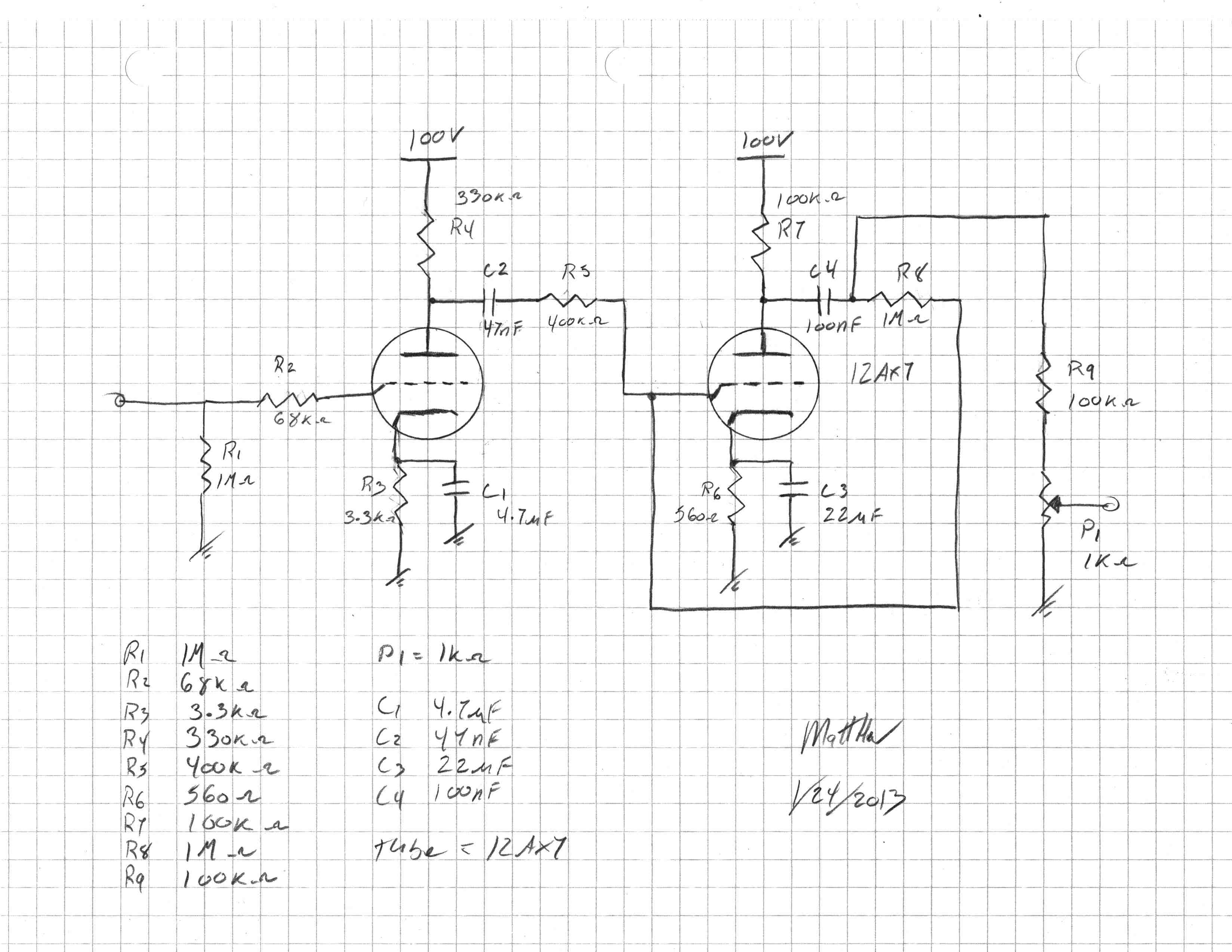

I fount this transformer, VPS28-6250 Triad Magnetics | 237-1282-ND | DigiKey and run my total again. I think I will use the 40W chip-amp. Anything wrong with electrolytic cap in the signal path, I have heard mixed things about it.
Do you mean at output? It's unnecessary unless you are doing single sided supply. I can't see a electrolytic on your 40W schematic.
If you mean input, remember this isn't hi-fi, it's guitar, so you only have to pass things from 80Hz. If you set the input cap for 40Hz you can do this with a cheap film cap easily. The 0.1u on your schematic is fine, the 10u unnecessary, as I've already said.
For single sided guitar amp speaker cap, where a bit of distortion is ok, it's not a problem to use electros really, provided you get the value and voltage right. You don't want it rolling off the bass, or being burned out by the signal peaks.
If you want to do it completely right, you make sure that the input cap has a higher roll-off than the speaker cap and nfb cap. That way the good quakity cap (at input) does the work, and the electrolytics don't

After some thought I have come up with this design, I'm actually pretty sure it will work this time. I have double checked the cap values with a simulation. I'm 76.2% sure I have the tubes biased right. The second stage uses local negative feedback. The tube supply transformer will be VPS230-570 Triad Magnetics | 237-1272-ND | DigiKey I still need to draw up a supply. For the power amp section I decided to cheat and go with this Kemo M033N 18 Watt Universal Mono Amplifier Module 320-553 I'm not sure if the specs provided on the parts express website are correct they seem kind funny to me, but i'm going to take a gamble. To power the amp module and tube heaters I'm going to use this ALS75-24 Triad Magnetics | 237-1296-ND | DigiKey I have double checked the specs on all supply's and transformers and they should supply sufficient power. I value your guy's input so please let me know if I'm in error. Oh and the tubes are clipping fairly symmetrically I used B2 spice to model everything, thanks in advance.
