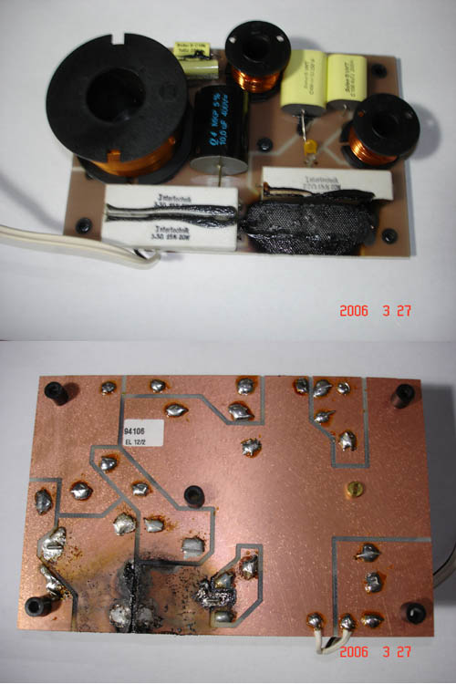

Running a Pair of 6L6GC's
390 ohm 10W shared resistor
36V across the resistor,
440V measured between the Cathode Pin 8 and anode pin 3
Dissapation around 19W, 43ish ma per tube
The Xiron cement had the lead come loose and pull out of the end after about 4 hours heavy use.
The Vitreous enamel Ohmite went open fairly quickly.
BTW, the ohmite may have been partially defective to begin with. I bought a small box of them from mouser, and had 2 of 12 open right out of the box.
It ran about 25 minutes before intermittently opening.
I suspect I need to get something more along the lines of the Ohmite 270 Series hollow wirewound ceramic resistors around 20 watts maybe more.
Trick is locating the correct value, mouser does not seem to have 390 - 400 ohm in that wattage.

Here is a picture of the 10W 390 ohm Xicon Resistor,
As shown in the photo, the lead is only inserted about 3/32" into the resistor body.
Most of the ceramic dust came out with the lead though some was present before I lifted the resistor for the photo.
As far as heat goes, I still have not gotten and actual temp reading (waiting for more parts).
It does get fairly hot to the touch, Not burn/blister your finger hot, but noticeable.
It does not get hot enough to dis-color the Fiberglass Board Material which is .125 thick Electrical Grade Fiberglass (GP03) with an Operating Temperature Range 0° to +284° F
I mounted it flat and snug to the board, but it had no kinks in the lead nor was it abused in any way.
Picture Below
Xircon 390 ohm 10W

I bought a bunch of these types, they came in a separate bundle wraped in bubble wrap. I thought , wow these must be fragile, and so I never used them...
Trout said:
Hot resistor in close proximity with 85 degrees electrolytic cap?
That would be a pretty typical failure for a circuit board mounted on a shaker table. Wait, no shaker you say? IMHO, it's just bad construction, probably because cost was the overriding factor. As for temperature, I like my semicons under 160F, but almost any resistor can operate way over that even when derated. The finger test isn't as useful as a good thermocouple reading. Even though the PCB material may be rated for hi temp, I don't like it discoloring over the years. I either keep the temperature lower or mount the resistor off the board somewhat. And certainly away from the caps! There are some flat power resistors from various sources (MEC Holsworthy, Tyco?) that might be useful. They're thick film, but I've used a few 5W parts in parallel with some success. Never had the leads fall off.

Try to have the resistor stay below 100C for the planned power dissipation. The resistors can take the heat, but not necessarily the case for adjacent components.
It's best to test both capacitance and voltage isolation when the resistor is heated up from the planned dissipation.
