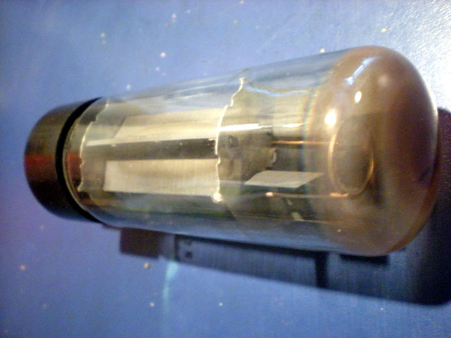

badly burned out EL34
Here is the pic of the tube (aka as voltage controlled nonlinear resistor) I promised to post. Look a the stain on the anode and the now silky see-through getter...
That one also sent the mains tranny to heaven... of that rare Hiwatt 50W guitar top...
