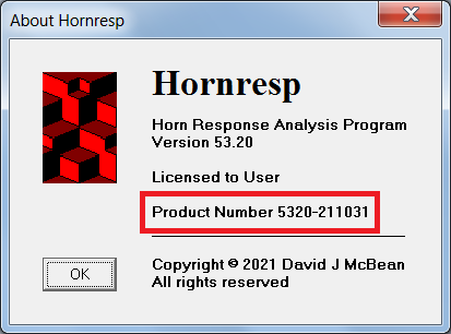

I installed the new version, but it keeps on asking if I want to install the newer version?
Hi b_force,
This is very weird indeed. I have no idea how it could possibly happen if you are using Product Number 5320-211031. Everything works just fine for me if I open the program while connected to the Internet - no update message appears.
Could you please check that you are definitely using Product Number 5320-211031, by selecting the Help > About Hornresp menu commands.
Kind regards,
David
Sorry for the inconvenience.
Not a problem, thanks for confirming that everything is now working okay.

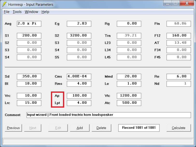

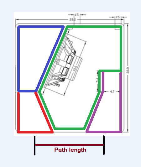

You could perhaps try modelling the design as a compound horn.
Attachment 1:
Use Vrc and Lrc to specify the blue chamber.
Use Vtc and Atc to specify the green chamber (exclude driver volume).
Use segments 1 and 2 to specify the purple port.
Use segment 4 to specify the red port.
Because two sides of the ports are sloping and two (the top and bottom) are parallel, segments 2 and 4 should have Par (parabolic) flares.
Attachments 2 and 3 show an example of the basic design (not to scale).
thanks! Will try that.
I forgot to mention that the acoustical path length parameter value should be set equal to the distance between the centres of the two port mouths, as shown in Attachment 1. From the drawing you provided it seems that the required value to use is 43.2 cm (equivalent to a length of 17 inches) as specified in Attachment 2.

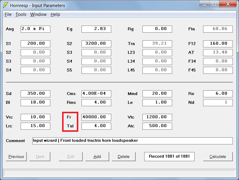

BUG FIX 1

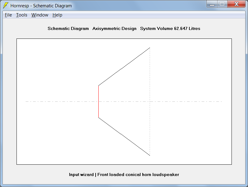

A coding change was made some time ago that inadvertently prevented a rear chamber port, throat adaptor or passive radiator from being specified when the Fr or Tal label was double-clicked on a Bes, Hyp, Lec, Obl, Rad, Sph or Tra type horn. This bug has now been fixed. Attachments 1 and 2 refer.

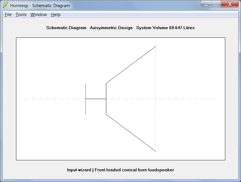

If a passive radiator was specified on a back-loaded horn (Vrc * Lrc = 0), the schematic diagram and combined response results were incorrect. Attachments 4 and 5 refer. This bug has now been fixed. Attachments 6 and 7 refer.
