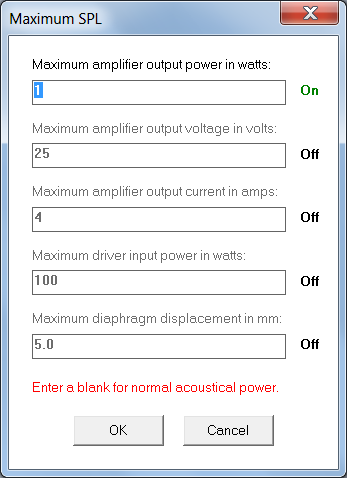

The actual power delivered will vary considerably from the nominal power value because the input voltage is constant, and the input impedance changes with frequency.
I should have perhaps mentioned that the Maximum SPL tool can be used to specify a constant input power rather than a constant input voltage. This could possibly make "1W @ 1m SPL" a little more meaningful :).
