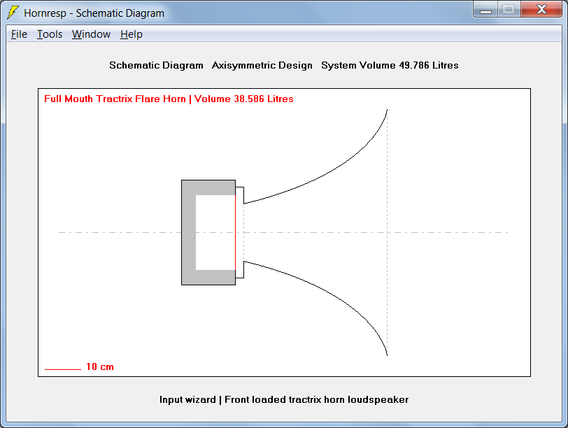

Can anyone make sense about of the Schematic view in HornResp, I'm looking at a tractrix horn for example and I have no idea on how to intepret its length/mouth width etc...no mater where I put the mouse cursor I just get a notice showing a "dash" and "10cm" rofl! Plz be gentle.

The Schematic Diagram shows an axisymmetric view of the specified horn. The drawing is accurately scaled, with the red line in the example shown representing a scaled length of 10 cm. The scale line is included to give the user an indication of the size of the horn.
Select the File > Export > Horn Data menu command from the Schematic Diagram window to export detailed dimension data.
Read the 'Schematic Diagram' and 'Export Horn Data' sections in the Help file for further information.

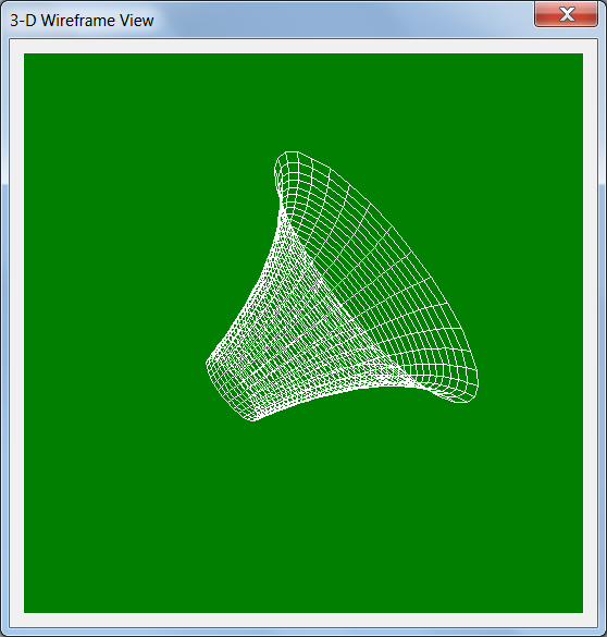

Further to my message above, selecting the Tools > 3-D Wireframe View menu command from the Schematic Diagram window displays the image shown in the attachment (for the given tractrix example). Clicking and dragging the mouse changes the orientation of the image.
The '3-D Wireframe View' section in the Help file contains further information.

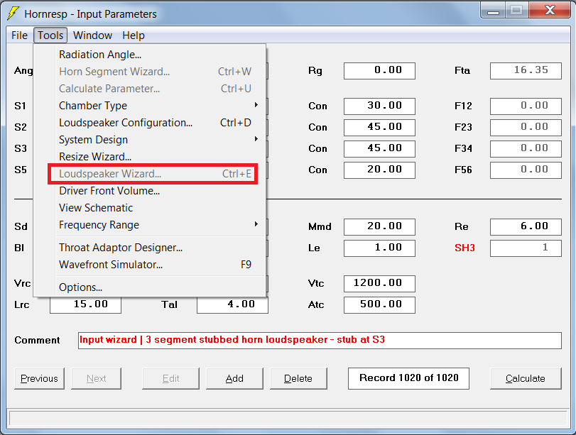

The Loudspeaker Wizard menu command was being disabled when a new record was created using the Input Wizard, even if the newly-created record was one that could normally be opened in the Loudspeaker Wizard. This bug has now been fixed.

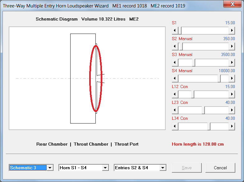

Schematic 3 in the Three-Way Multiple Entry Horn Loudspeaker Wizard was showing the size of the composite ME1 driver diaphragm, rather than the size of the composite ME2 driver diaphragm. This bug has now been fixed.
