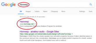

Please forgive me for asking a silly question, but where can I actually get the HornResp-programme?
Regards
It's at the bottom of David McBean's current posts:

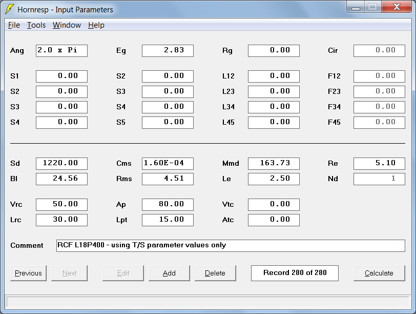

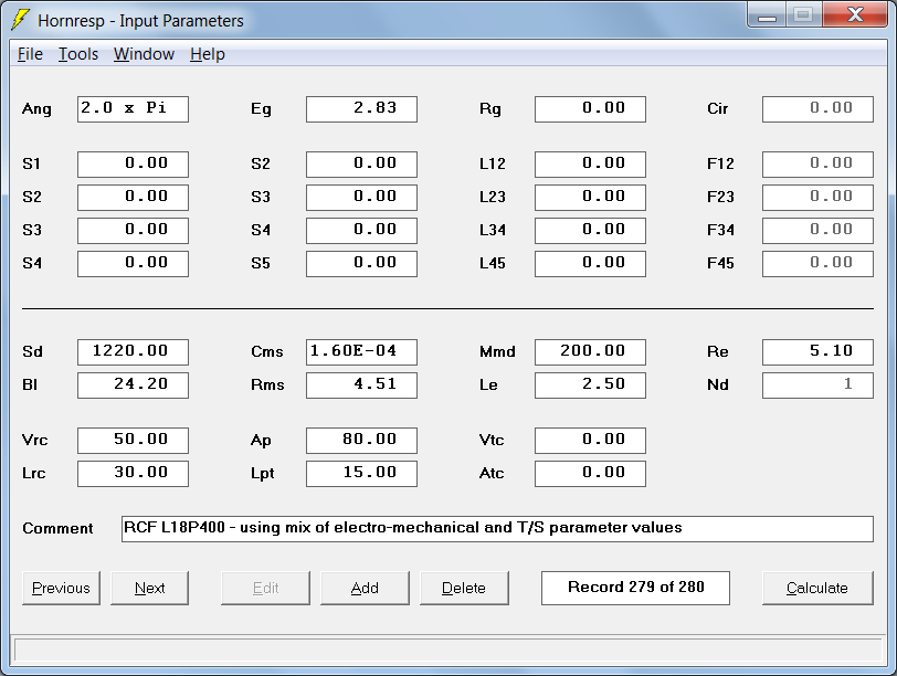

Wanting to compute a simple vented box, here's my driver file (hand crafted):
RCF L18P400
Sd=1220.00
Bl=24.2
Mmd=200
Le=2.50
Re=5.10
Pmax=1000
Xmax=9.0
LossyLe=0
Qes=0.29
Qms=7.6
Qts=0.28
Vas=340
fs=29
Following your recommendation...
> Select the 'Rear Vented' option from the Chamber Type tool and set S1 to L45 = 0 and Vrc, Lrc, Ap and Lpt > 0.
However, after pasting the driver into the record I got "Invalid result. Change input data."
The format, contents and parameter order of the driver file should be as shown below:
RCF L18P400
Sd=1220.00
Bl=24.20
Cms=1.60E-04
Rms=4.51
Mmd=200.00
Le=2.50
Re=5.10
Pmax=1000
Xmax=9.0
LossyLe=0
Attempting to "hand craft" a driver file is definitely not recommended :).
Always let Hornresp generate your driver files using File > Copy Driver to Database, after first having entered the driver parameter values via the Input Parameters window.
the RCF T/S params are missing Cms and Rms
Double-click on the Cms and Rms input boxes and follow the instructions to enter the equivalent Thiele-Small parameter values. If you would rather specify the driver using Thiele-Small parameters only (rather than a mix of Thiele-Small and electro-mechanical parameters) then double-click on the Sd input box.
Using your given driver electro-mechanical values and calculating the required Cms and Rms values from Thiele-Small equivalents, your input parameters window should look like Attachment 1. Alternatively, using your given Thiele-Small values only, your input parameters window should look like Attachment 2.
Double clicking on Le showed the following values in the Semi-Inductance Model window: RE', Leb, Le and Ke all filled in, but the Rss field empty.
If the driver data is entered correctly, the initial values of the Semi-Inductance Model parameters (including Rss) will all be zero.

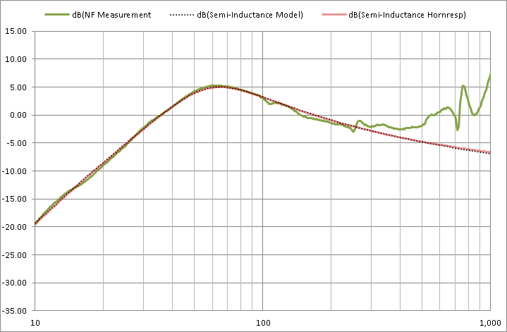

Semi-inductance and frequency-dependent damping (FDD) models have been added.
Many thanks for figuring out an elegant way to work these more advanced transducer models into Hornresp. As you can see in attachments #1 & #2, the semi-inductance model output from Hornresp provides a satisfying match with nearfield measurement for the Dayton Classic 12” subwoofer posted previously here: Inductance Cancellation Techniques

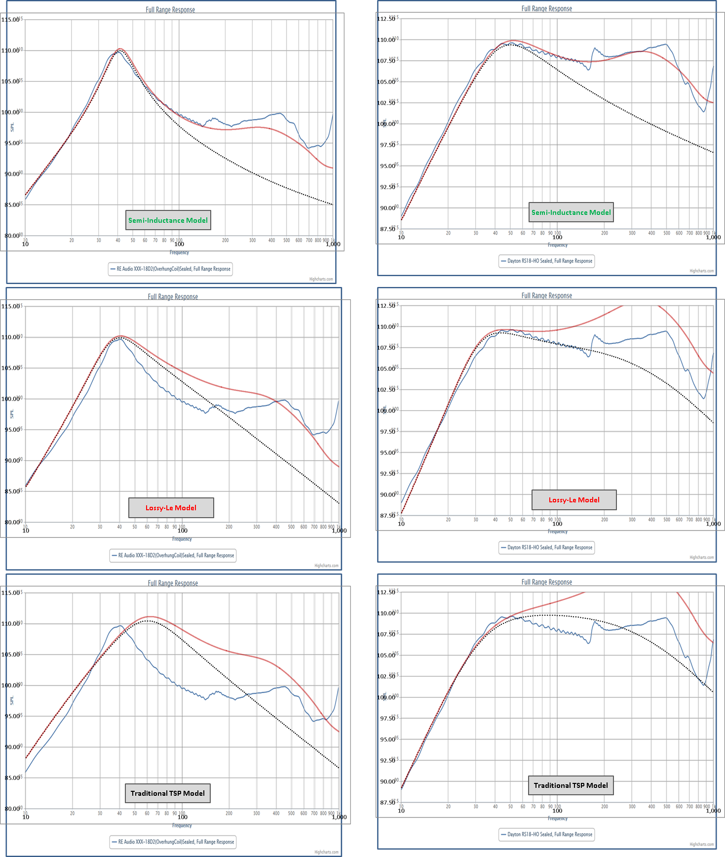

As another test, I decided to try and use the free-air impedance curve images posted on Databass to determine the semi-inductance parameters by hand. I chose two drivers that were on either end of the Lossy-Le correction spectrum, the Dayton HO18, and the ER Audio XXX 18. It would have been nice if a nearfield measurement was included in the Databass plot set, but I understand why it isn’t. So, to try and compare prediction to ground plane measurements an enclosure diffraction increment needs to be added(aka baffle step). I used the BTM diffraction method (Baffle edge diffraction with dipole radiation), although I think the EDGE diffraction tool would get you pretty close in this case.
For each woofer I calculated response with the Traditional TSP model, the Lossy-Le model, and the Semi-Inductance model. Each plot has 3 curves: blue= databass measurement, black dotted = 2pi calculated response, red = 2pi calculated response + diffraction. Pretty nice agreement considering the hand work involved in selecting the Semi-Inductance parameters and the estimate of diffraction. One thing I found interesting is that the HO18 inductance nearly provides built in baffle step compensation.

Hi bolserst,
Excellent information - many thanks for posting it!
Kind regards,
David

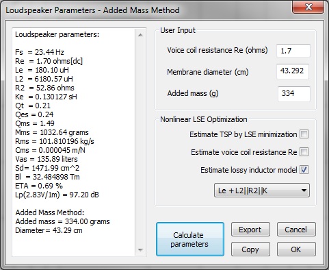

REW can calculate parameters from imported impedance curves. Verified by exporting text files of measurements taken in LIMP.
Examples using RF T3S2-19 driver. Parameters calculated are slightly different but it should be close enough for modeling and to derive lossy inductance parameters to use.
If you can export text files of the impedance measurements you should be good to go by importing them into REW. I believe the S&L WT2/Pro and Dayton DATS can do this?

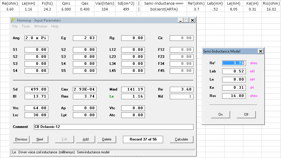

Is there any way to derive these enhanced parameters from standard Thiele/Small measurements?
If you have the standard TS parameters and a text file with free-air impedance data (magnitude & phase) I have a spreadsheet that can determine the semi-inductance parameters. If you have text file for not only the free-air impedance, but the "added-mass" or "in-enclosure" impedance, you can just important them into REW for the parameter calculations.
I think you know my email address !
I would be most interested in getting a copy of that spreadsheet. My Smith&Larson WooferTester Pro does indeed give the text file with the free air impedance data.
