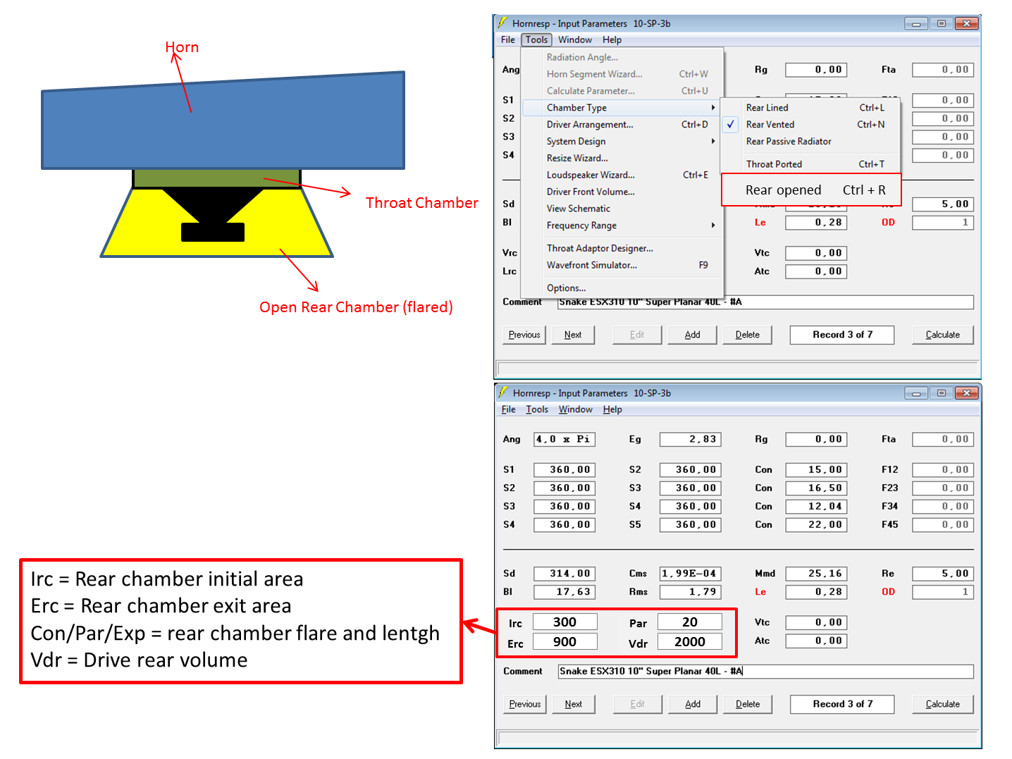

Hello David,
May I ask for a small change in hornresp?
I've been simulating a cab design named Super Planar Top shared by Matthew Morgan J, and the results are very impressive in terms of output SPL vs cab complexity (you passed by that thread). One think I'd like to simulate is different flares in front of the driver but hornresp have some restrictions. Currently that design is simulated as OD and the "ressonator" is emulated using vented rear chamber with Vrc and Vtc = 0 + a big port, basically is like rear chamber being "opened" and hornresp has just one port flare (cylindrical, right?)
My proposal is to add another rear chamber type: Rear opened
Maybe, there are different ways to implement it, but as you can see in the attached image it wouldn't affect the current interface and all math already exist inside the hornresp.
10" top design - Open discussion
Thanks in advanced
Marcelo

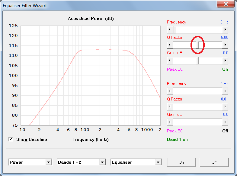

Very minor usability suggestion to save my clicking the same slider many times
change the default Q factor in the filter wizard from 0.01 to a more reasonable default. A sane default probably varies by filter type but I would guess ~0.7 is a reasonable default for shelf filters and high/low pass.
Hi Marcelo,
Seemlessly integrating the requested change would be not as easy as you might think .
I will have a look at the possibility, but only after the release of the next update - I have more than enough work to do already.
Hi 3ll3d00d,
Drag the slider bar control (highlighted in red in the attachment) to somewhere near the value you want and then click on the bar either side of the control to adjust the value in 0.1 increments, or click on the arrows at each end of the bar to adjust the value in 0.01 increments.
Alternatively, when the slider bar has the focus, simply key in the exact value you want and press the Enter key.
