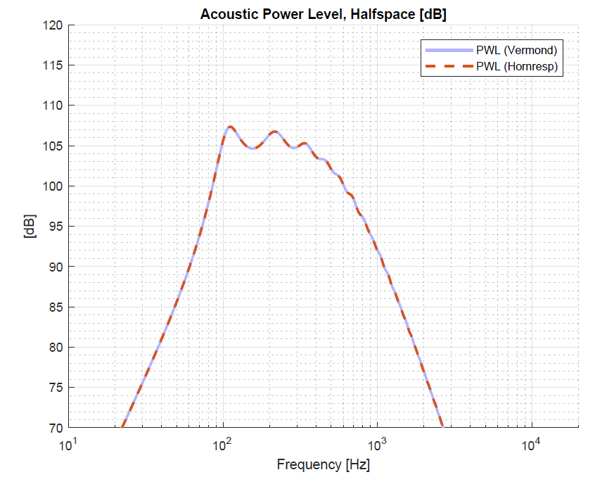

Hi Bolserst and David,
both your corrections did the trick. Thank you very much! See the attachment for two matching curves. Although this may sound silly, but I was struggling for some time now with this circuit, and these matching curves made me very happy .

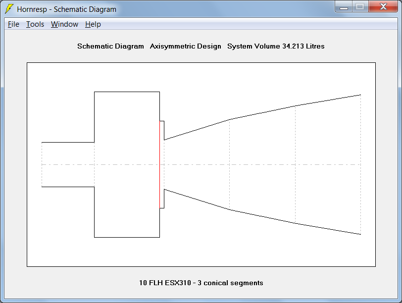

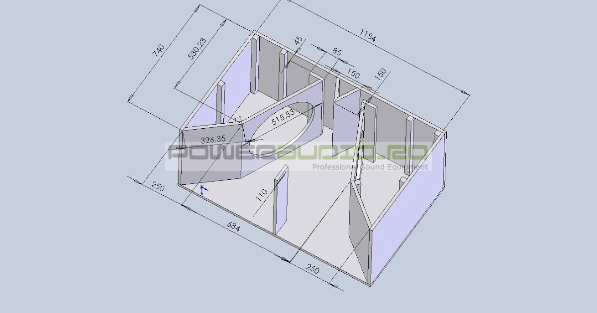

Hi M1 Audio,
From the appearance of the cabinet, perhaps it was modelled as a "Horn-Loaded Vented-Box Enclosure With Port Exit Located Inside Horn Mouth", using the tapped horn option, as described in the Hornresp Help file?
The attached schematic shows such a tapped horn design. The horn is specified using three segments, the length of the first segment being 0.1 cm. The red dashed circle represents the front side of the driver diaphragm, facing into the horn. The green dashed circle shows the rear side of the driver diaphragm, facing into the rear chamber specified using Vrc and Lrc. The large black dashed circle is the rear chamber, and the small black dashed circle is the port tube from the rear chamber into the horn, specified using Ap and Lpt.
It would of course be better simply to ask the person who posted the design in the first place, but I guess it has not been possible to do this .

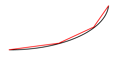

I'd like to try to reproduce using 3 straight line segments at possible real build.
Hi Marcelo,
Export the horn data for your 45 cm parabolic horn and note the cross-sectional areas at 15 cm and 30 cm.
(You should find the area at 15 cm to be 333.33 cm^2, and the area at 30 cm to be 566.67 cm^2).
3 segment design:
S1 = 100.00
S2 = 333.33
S3 = 566.67
S4 = 800.00
L12 (Con) = 15.00
L23 (Con) = 15.00
L34 (Con) = 15.00
The results will be effectively the same as those for your original parabolic horn.

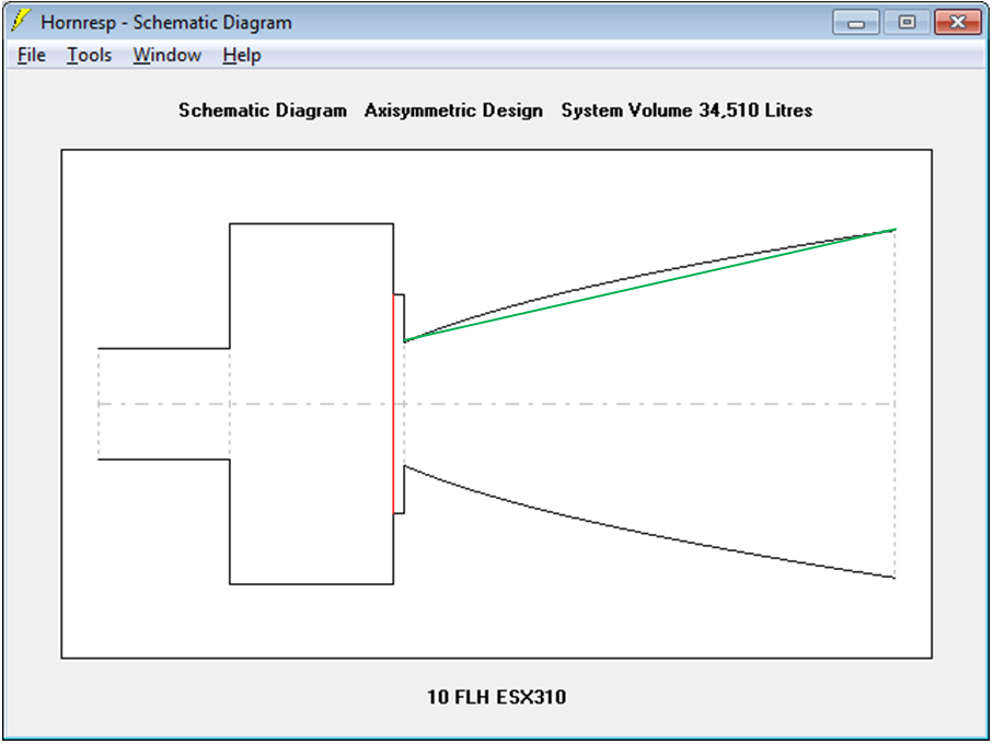

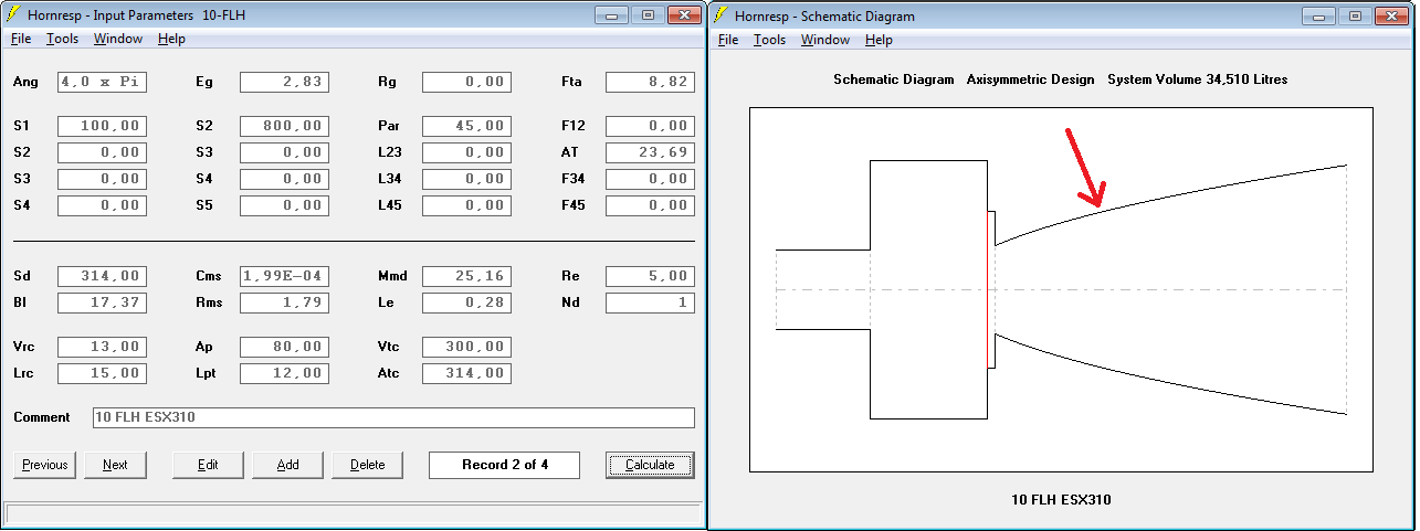

One think is strange to me is the visual feedback (Schematic Diagram), it indicates a kind of flare that isn't straight line (attachment #1 - black vs green), and this was the reason I asked for the equation, but checking the data after export, it's exactly a straight line (Y=aX+b) but it not correspond to the visual feedback. Is this right?
So when using PAR flare or CON one, the hornresp will use straight lines?
Hi Marcelo,
The radius of a Par flare axisymmetric horn increases parabolically with axial length, as shown in the Hornresp schematic diagram. The cross-sectional area increases linearly with axial length.
The Y=aX+b straight line you plotted would have used the cross-sectional area data.
Because the cross-sectional area of a parabolic horn increases linearly, a rectangular horn with two parallel sides and two tapered sides will be a parabolic horn.
Even the legendary Paul Klipsch got it wrong in his original bass corner horn paper, when he described the initial front expansion as conical. He later corrected this to parabolic.

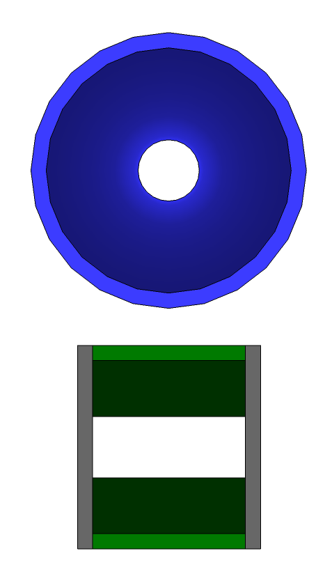

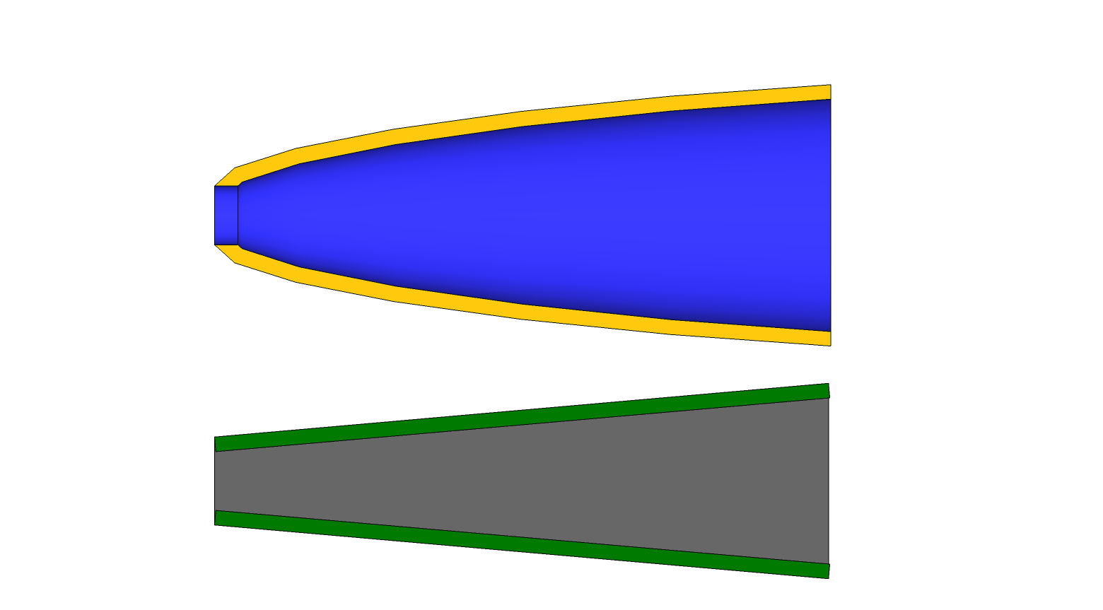

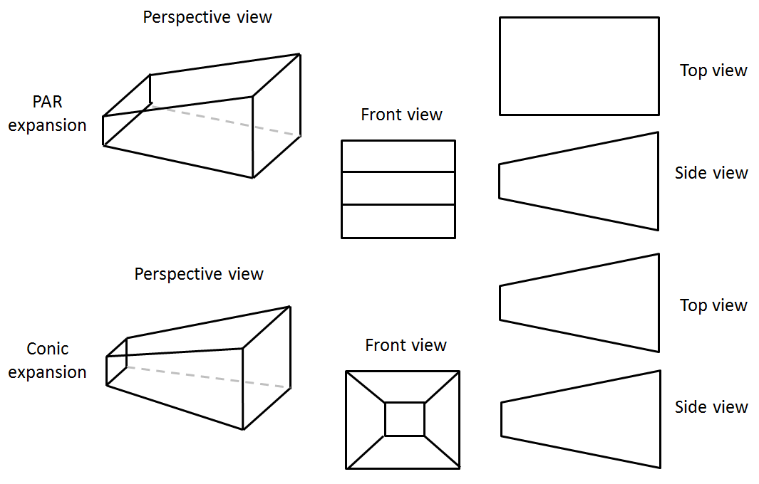

Thansk David, but thinks still intriguing me
The schematic diagram is composed by 2D lines, and a rectangular horn with two parallel sides and two tap

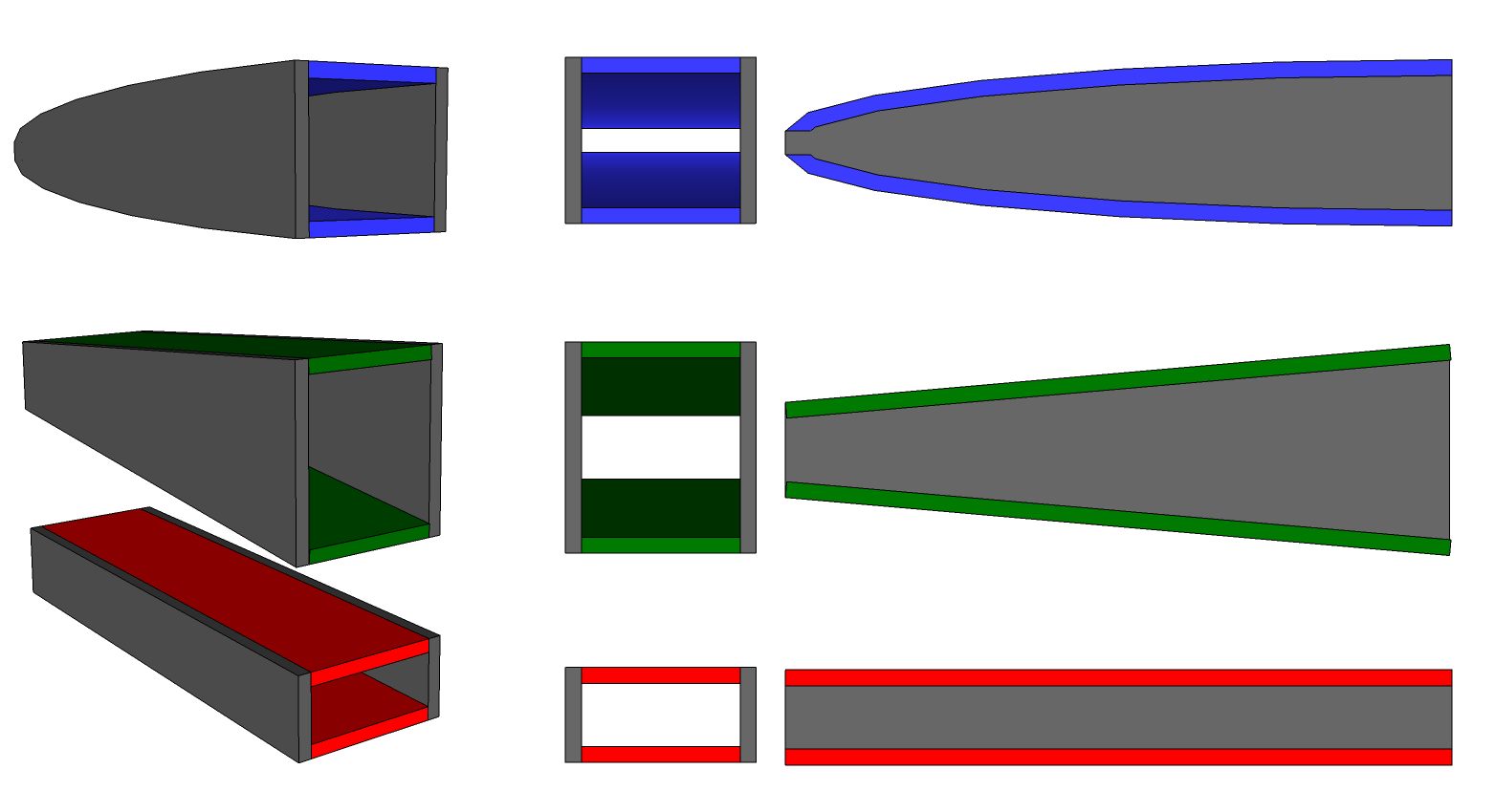

See the example below, 3 different horn flares, all of them with parallel sides (gray) and all of them generates rectangular coss-section area.
Leegend for the attachment #1

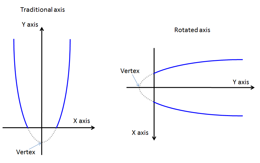

Yes, confirmed.
And parabolic things will follow the equation below.
Y = aX^2 + bX + c but what you plot is symmetric ay Y-axis with the vertex below S1 so I assume that the Schematic Diagram use the equation Y = aX^2 - c (with Y and X axis 90º rotated) - See attachment #2
Would you mind to clear?
Marcelo
ered sides can never generate a 2D parabolic projection, to project parabolic curve, the horn needs to be parabolic, or what hornresp is plotting is something different and it isn't a horn 2D projection as I'm supposing.See the example below, 3 different horn flares, all of them with parallel sides (gray) and all of them generates rectangular coss-section area.
Blue = Parabolic flare
Green = Taperad flare
Red = Constant flare
Left side = Perspective
Center = front view
Right side = Side view (what I was thinking that the schematic diagram is)

Hi Marcelo,
The Hornresp schematic diagram shows the side view of an axisymmetric (circular cross-section) parabolic horn. The radius increases parabolically and the cross-sectional area increases linearly. A rectangular cross-section horn will only be a parabolic horn if the area increases linearly.
While your blue example flares parabolically in one plane, it is not defined as a parabolic horn because the overall cross-sectional area does not increase linearly. Your green example is a parabolic horn because the cross-sectional area increases linearly. Your red example is not a parabolic horn.
Hornresp uses the two formulas given in my previous message to calculate the radius of the axisymmetric parabolic horn shown in the schematic diagram.
The defining characteristic of a parabolic horn is that the cross-sectional area increases linearly. The horn will only actually look like a parabola if it is axisymmetric (i.e. has a circular cross-section).
It can be confusing sometimes - as indicated earlier, it even caught out the great PWK .
Kind regards,
David

Not sure that it makes things any clearer, but the description given in the book "Acoustics - Sound Fields and Transducers", by Beranek and Mellow states: "A parabolic horn can either have a rectangular cross section with two parallel straight walls and two non-parallel straight walls, or a circular cross section with a curved wall following a parabola."
Now everything is clear, Thanks you.
We have two different shapes that are equivalents if they respect the rule for the cross-sectional area to increase linearly with axial length.
The attachment is just illustrative but it represent the equivalents shapes
The cross-sectional equivalence is:
rectangular vs circular
The side view equivalence (axisymmetric)Tapared (linear) vs parabola (2nd order)
The equation hornresp use: Rx = (Sx / Pi) ^ 0.5 is a second order equation
Circular area (Sx) = Pi*Rx^2 that the general equation is Y = aX^2 - c (the c just move the curve up and down, it don't change the shape - I like some algebra)
