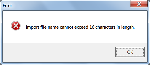

Hi Jack,
Thanks for providing the file.
Hornresp only accepts filenames up to 16 characters in length, excluding the .frd extension. 'Base Bin Room Gain Profile' is 26 characters including spaces. If you rename the file as 'BB Room Gain.frd' for example, you will find that it works just fine.
The program should automatically check for filenames longer than 16 characters and advise the user, but this functionality is obviously not working correctly. I will investigate and fix in time for the next release.

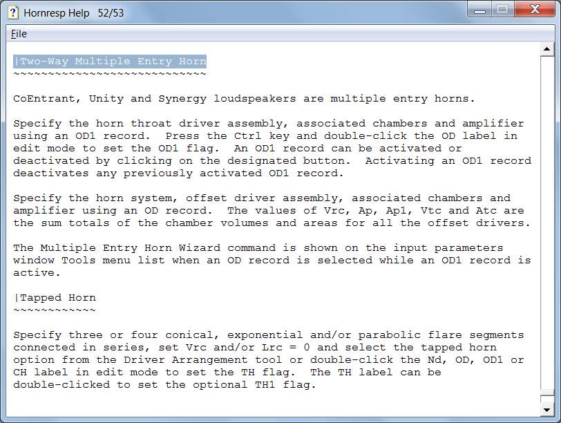

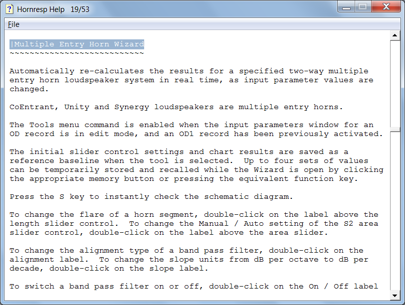

Hi Kees,
The two relevant sections in the Help file are:
* Multiple Entry Horn Wizard
* Two-Way Multiple Entry Horn
Kind regards,
David

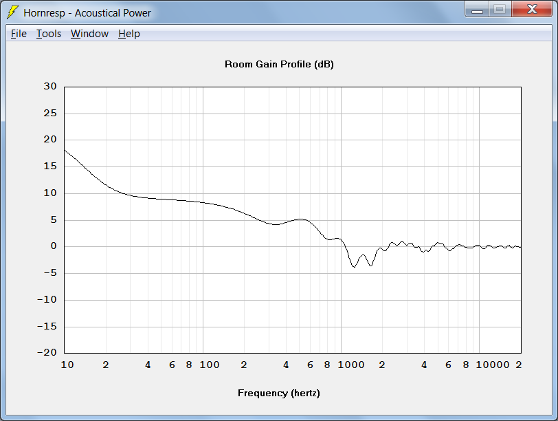

What were the boundary conditions for the room gain calculations?
Because that really does not look right.
I don't know the math behind the spreadsheet but this is the result of the room gain section alone. You can select the room's longest dimension and the percentage of leakage, that's it.
Like I said, by necessity this is the least accurate part of this spreadsheet, it's impossible to address all the data that would need to be used to get a more accurate result, but the boundary bounce and diffraction part are very accurate (within the limitation of infinitely rigid boundaries).
If you are not familiar with the spreadsheet why did you say:
Great to hear you are getting successful implementation of the room gain feature.
For that area you can get some semi useful results in the overall performance of your project.
Using Jeff's spreadsheet for anything further is chasing something you will not really catch.
They are simulations. And not even all that accurate simulations of boundary effects in the first place.
It isn't right, its a test file, combining boundary support and room gain.
The boundary support is generated as a power response, which I now know is incorrect by comparing imported profile vs 1/2 pi sim. The distances from the wall and floor were set unrealistically low so no nulls would show up.
The room gain parameters are based on 29' longest dimension and either 50% or 60% leakage.

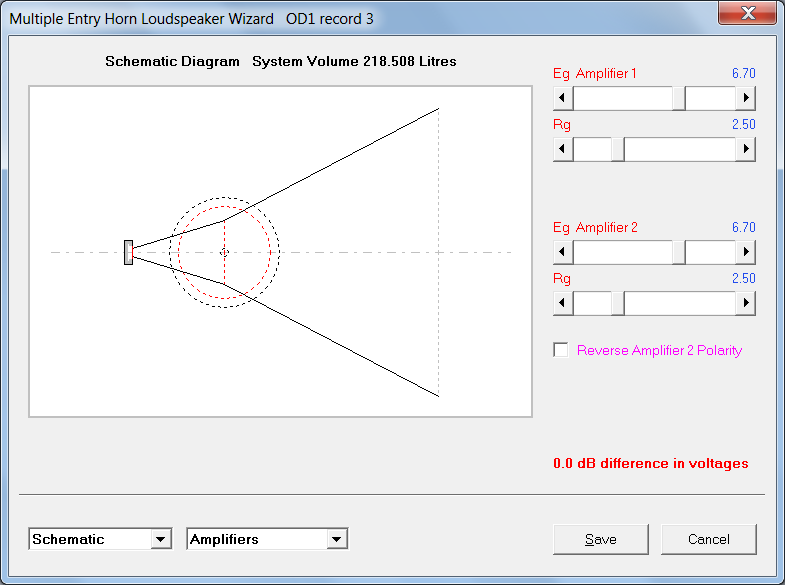

Hornresp Update 3700-150220
Hi Everyone,
CHANGE 1
The bug identified by Jack in Post #5248 has now been fixed.
CHANGE 2
Pressing the Ctrl key while adjusting an Amplifier Eg or Rg slider control in the Multiple Entry Horn Wizard will cause the other Eg or Rg slider to be set to the same value.
Kind regards,
David

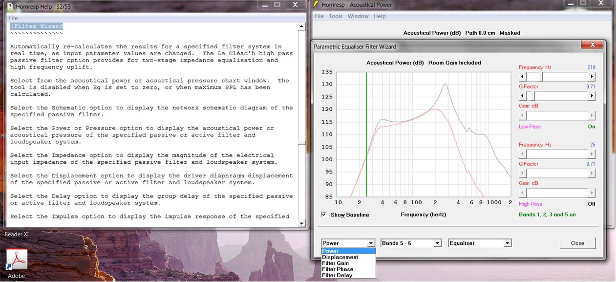

Hi David:
Sometime in the last couple of iterations I've lost the ability to display "Delay" in the Filter Wizard. This screenshot is from your version ...220, downloaded this AM. Help says that Delay option should be there in the drop down menu. Notice that pressure is also missing.
Jack
Hi David:
Sometime in the last couple of upgrades I've lost the ability to pull up the "Delay" screen in the Filter Wizard. This screenshot is from your version ...220, downloaded this AM. Help says that Delay option should be there in the drop down menu. Notice that Pressure is also missing from the drop down menu but the Help implies it should be there.
Yesterday, it was driving me crazy. It appeared that on some sims, I could pull up the Delay screen but on others I couldn't. Today, I've cleaned up all the old revs of HR from my system and Delay is consistently missing.
Meanwhile, importing boundary support files has been enormously helpful. Oops, overlapping posts from a mis-click...
Thanks and regards,
Jack

Hi David:
I understand you are having browser problems. This problem was still bugging me so I dug deeper and at least found out what triggers it and how to avoid it.
The Delay screen is available until I import and include a room gain profile. Once I've have done so, I'm not able to see the Delay screen option in Filter Wizard until and unless I exit HornResp and re-simulate. That had me going for a while:)
Thanks,
Jack
Hi Jack,
If room gain is added to the power response, or if the Filter Wizard is selected from the Loudspeaker Wizard, then the Filter Wizard group delay output option is not available.
If the default acoustical power response is calculated and the Filter Wizard then selected, the wizard output drop-down list indicates 'Power' rather than 'Pressure'.
If the Directivity Response tool is used to calculate the acoustical pressure response and the Filter Wizard then selected, the wizard output drop-down list indicates 'Pressure' rather than 'Power'.
It should not be necessary to exit Hornresp. Just set the Tools > Room Gain menu back to the Excluded option, and the Filter Wizard group delay option becomes available again (provided that the Filter Wizard is not selected from the Loudspeaker Wizard).
