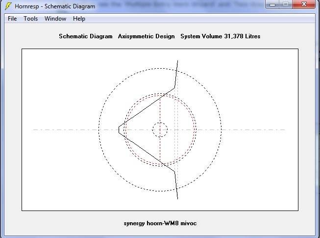

you say make a OD1 can you explane how to get it.
Hi Kees,
It's all in the Hornresp Help file .
"Press the Ctrl key and double-click the OD label in edit mode to set the OD1 flag."
In other words, select an existing OD record, click on the Edit button, hold down the Ctrl key while double-clicking the red OD label to change it to OD1.
Use the OD1 record to specify the driver assembly at the horn throat.
Use a standard OD record to specify the rest of the system.
Activate the OD1 record if you wish to use the Multiple Entry Horn Wizard with the OD record.
Kind regards,
David

Two-way multiple entry horn loudspeaker systems can now be simulated.
THIS is a major event. I wasn't expecting this. This is good news.

Hi David
Thank you, I will look at it, this I did not find in help file, or I was blind that day, as more diy people proberly have when do learn things.
