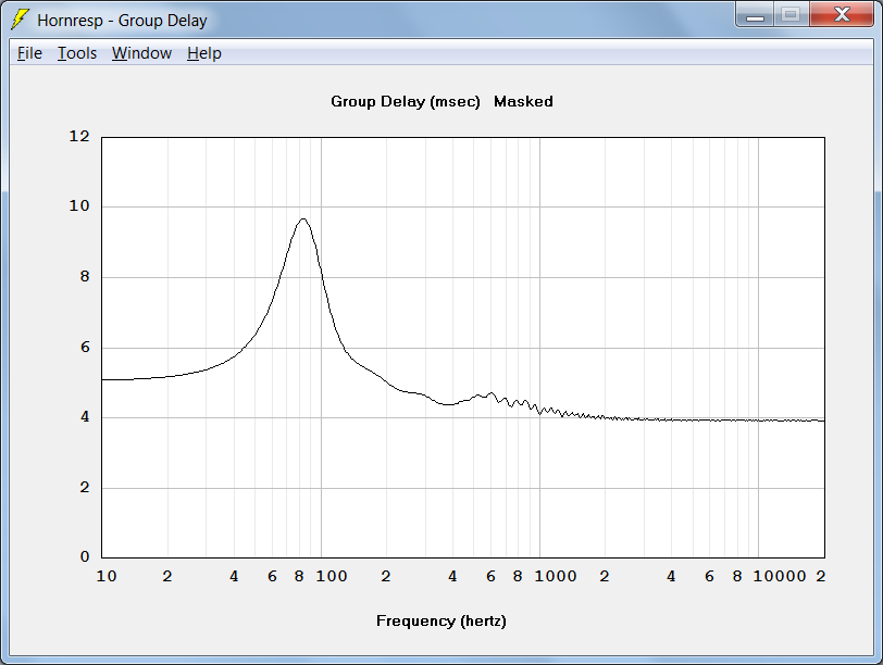

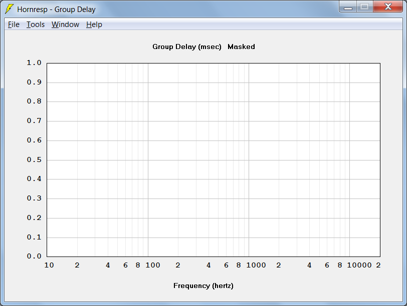

I found another bug. The sequence of actions leading to the generation of the error is as follows:
1. Calculate default record #1 results
2. Select Filter Wizard
3. Select Filter Delay output option
4. Close Filter Wizard
5. Calculate default Maximum SPL result
The group delay chart is displayed as shown in attachment 1.
It should be as shown in attachment 2.
The bug has now been fixed.

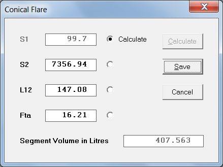

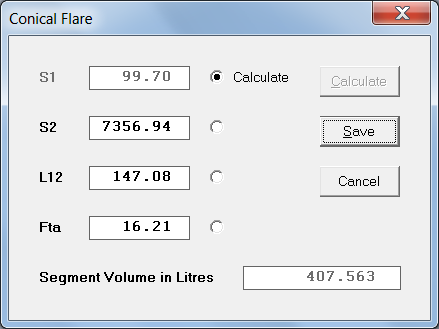

I found yet another bug. I am amazed that it has taken so long to notice, as it would have been present since Version 4.10.
Results calculated by the Horn Segment Wizard tool were in some cases not being formatted to 2 decimal places - see the value shown for S1 in attachment 1.
The correct format is shown in attachment 2.

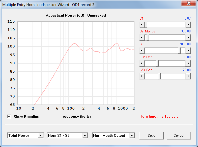

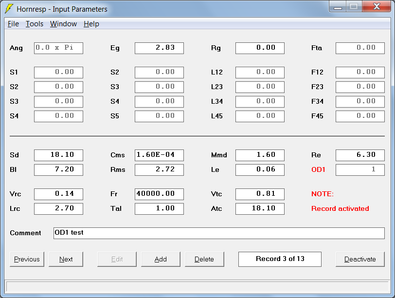

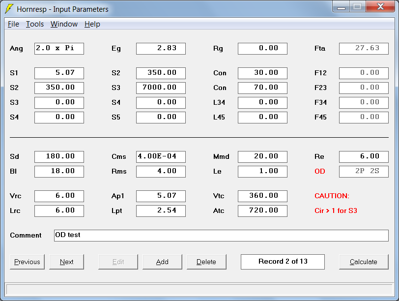

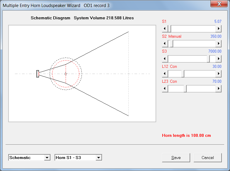

I've only now just updated hornresp to check out the multiple entry horn wizard.
I'm a bit confused by how it works (A, how to set it up, and B, what it actually let's me do)
If I'm looking at the schematic correctly, it allows you to design a horn using front driver taps at both s1, and s2 (s1, ND, s2, OD). What I'm confused about is it seems like you would always have a compression driver at s1 (not dimmable by hornresp afaik), and then a cone driver at s2. What am I missing here? It seems like I would rather have multiple entry points at s2 and s3, so I could sim a 3 way synergy horn (say, with 2 5s and 2 12s)
Hi sine143,
A - How to set it up:
1. Create an OD record.
2. In Edit mode, press the Ctrl key and double-click the red OD label to change it to OD1.
3. Specify the amplifier, driver and chamber details for the driver assembly at S1.
4. Click the Activate button.
5. Create another OD record.
6. Specify the amplifier, horn, driver and chamber details for the driver assembly at S2.
7. Select the Tools > Multiple Entry Horn Wizard menu command.
B - What it lets you do:
Simulate a two-way Unity / Synergy horn using the real-time Multiple Entry Horn Wizard.
If I'm looking at the schematic correctly, it allows you to design a horn using front driver taps at both s1, and s2.
Correct.
(s1, ND, s2, OD).
(S1, OD1, S2, OD)
If you choose to use a compression driver at S1, then provided that the input parameter values are known, it can be simulated in Hornresp just as accurately as for a cone driver.
But then you wouldn't be taking into account the driver at S1, which is what I wanted to do.
Attachment 1 shows an example set of OD1 input parameters, with the record activated.
Attachment 2 shows an example set of OD input parameters, with 4 drivers at S2.
Attachment 3 shows the system schematic diagram.
Attachment 4 shows the system power output.
See the Hornresp Help file for further details.
