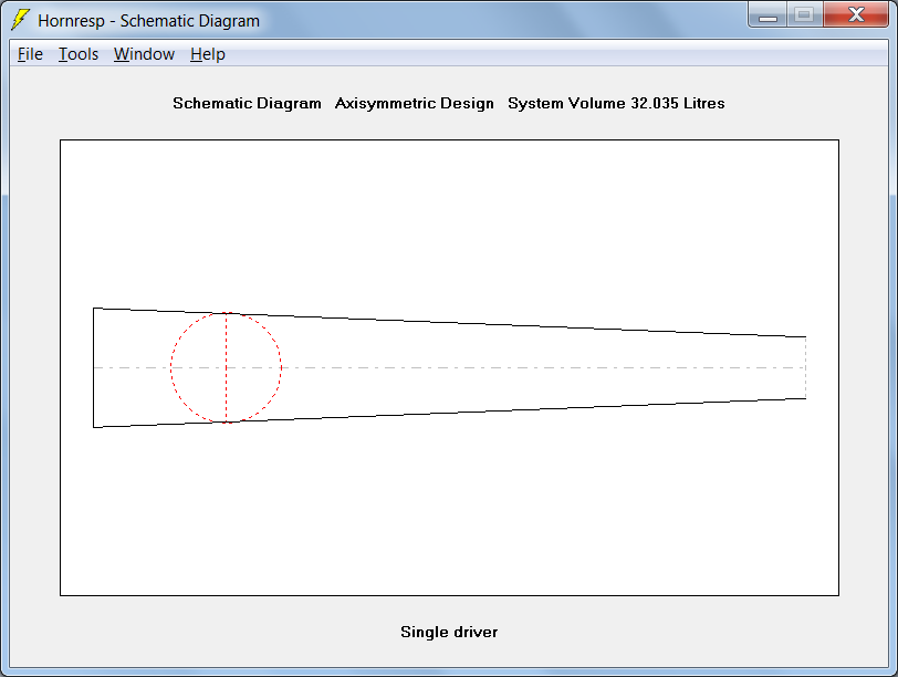

I was wondering how the program takes into account drivers position in case you set up a number oh drivers equal to 2? I am trying to simulate a tapered TL (similar to the Thor design of D'Appolito) with two drivers and trying to find out if hornresp accounts for driver positions in this configuration.
Hi PKI,
Bill (WHG) has summarised the situation very succinctly.
As far as Hornresp is concerned, multiple identical drivers are assumed to act as a single composite driver, with the driver parameter values being automatically modified by the program as necessary. When the drivers are located close to each other acoustically (which is usually the case with bass systems, where the wavelengths are relatively long) the composite driver model can be surprisingly accurate.
If you are using the OD option in Hornresp, then the composite driver is assumed to be located at S2, the same as for a single driver.
Attachment 1 shows a tapered transmission line loudspeaker system with a single driver.

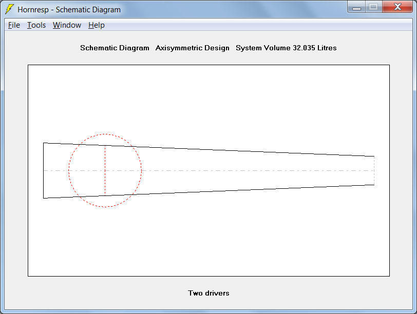

Attachment 2 shows the same system but with two drivers. The diaphragm area is shown to be twice that of a single driver.
Parameter values for a composite driver are calculated as follows:
Sd = Sd1 * SeriesDrivers * ParallelDrivers
Cms = Cms1 / (SeriesDrivers * ParallelDrivers)
Mmd = Mmd1 * SeriesDrivers * ParallelDrivers
Re = Re1 * SeriesDrivers / ParallelDrivers
Bl = Bl1 * SeriesDrivers
Rms = Rms1 * SeriesDrivers * ParallelDrivers
Le = Le1 * SeriesDrivers / ParallelDrivers
Where SeriesDrivers = 1 and ParallelDrivers = 1 for a single driver, and Sd1, Cms1, Mmd1, Re1, Bl1, Rms1 and Le1 are the parameter values for a single driver.
