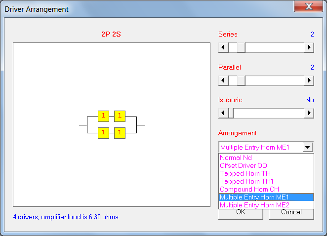

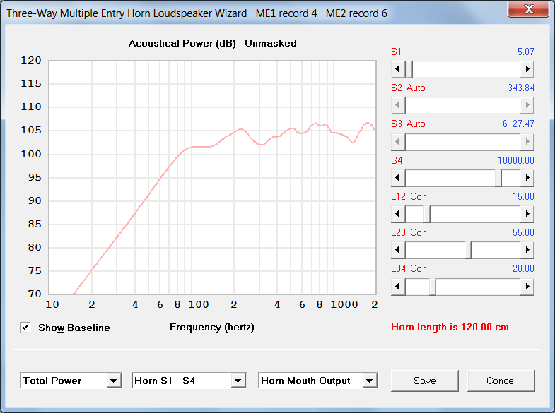

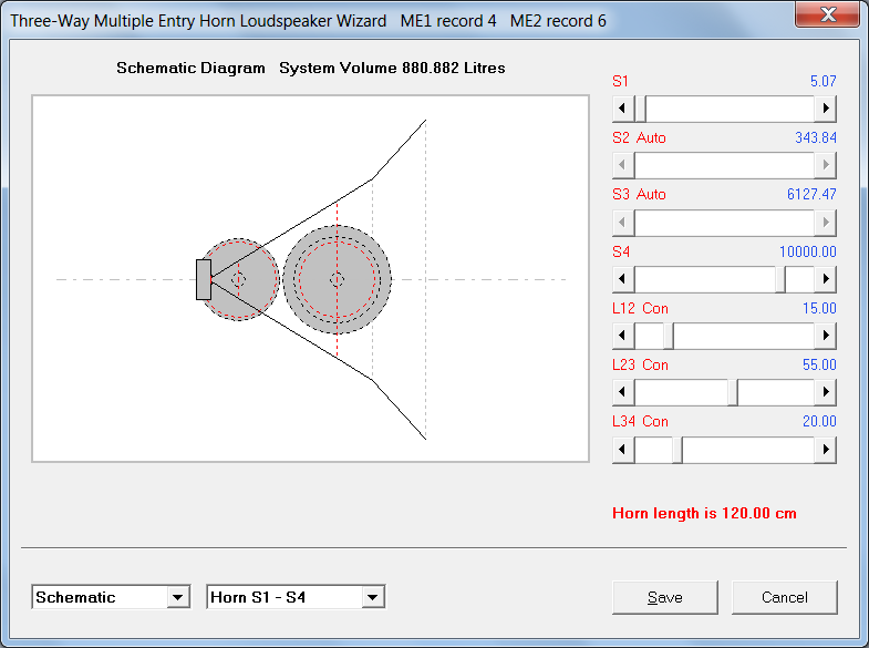

Hornresp Update 3800-150425
Hi Everyone,
CHANGE 1
The Multiple Entry Horn Loudspeaker Wizard tool can now also simulate three-way systems - see Attachments 1 and 2.
To accommodate the new three-way option, the method used to specify the multiple entry system has been modified.
Previously for two-way systems, an OD record was used to specify the horn system and MF drivers at the offset entry point, and an OD1 record was used to specify the HF driver at the horn throat.
Now a Nd record is used to specify the horn system and the HF driver at the horn throat, with the MF drivers at the first offset entry point being specified using a ME1 record and the LF drivers at the second offset entry point being specified using a ME2 record.
A three-way system requires the Nd record to have at least three segments, with both a ME1 record and a ME2 record activated.
A two-way system requires the Nd record to have at least two segments, with a ME1 record activated. If a ME2 record is also activated it will be disregarded if only two segments are specified in the Nd record.
Further details can be found in the 'Multiple Entry Horn Wizard' and 'Two-Way and Three-Way Multiple Entry Horn' sections of the Hornresp Help file.
CHANGE 2
The existing TH1 and the new ME1 and ME2 options can now be selected directly from the Driver Arrangement tool - see Attachment 3.
As always, could you please report any bugs.
Kind regards,
David
