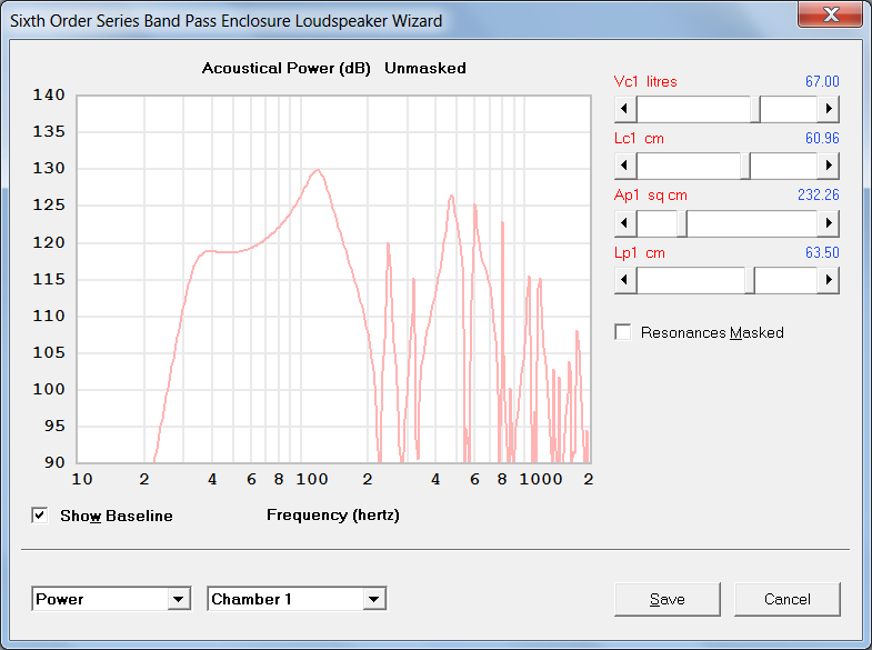

The real-time Loudspeaker Wizard can now simulate:
1. Sixth order series band pass enclosures
2. Eighth order triple reflex band pass enclosures
3. Aperiodic bi-chamber enclosures
See the 'Sixth or Eighth Order Band Pass Enclosure' and 'Aperiodic Bi-Chamber Enclosure' entries in the 'Loudspeaker Models' section of the Hornresp Help file for further details.

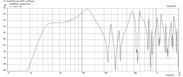

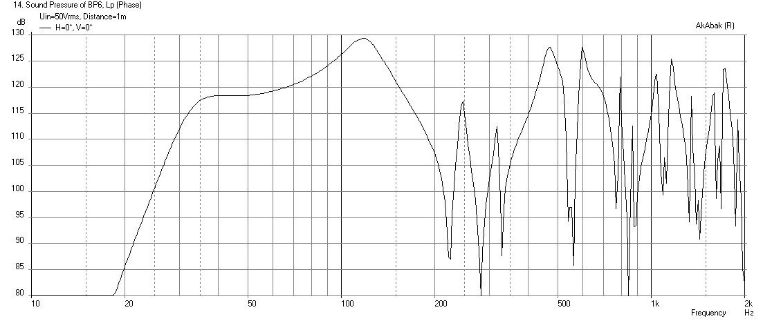

Now I see why you were asking me about the topologies of the 6th order series bandpass that I modeled in Akabak with 9 lines of script.
Hi xrk971,
There is method in my madness - I always have reasons for my questions :).
In the attached comparison, the subtle differences at higher frequencies are due to your AkAbak simulation showing the pressure response, whereas in Hornresp the power response is calculated (because the directivity characteristics of the system are not accurately known).
Other slight differences in peak amplitudes are due to differences in the number of plotted frequency points.

Hi David,
I have always, well for a while, wished that I could hit control C while looking at the acoustical power response in the filter wizard and then
compare to another simulations power response in the filter wizard, like can be done with the raw graphs using the Compare Captured command.
The filtered power, in some cases, looks much more like the final results the system will have, especially with low LP filters.

Hi Dave,
I will add it to my list of 'things to look at' :). Can't promise anything at this stage, though. To compare filter responses I normally just take a screenprint of the Filter Wizard form by pressing the Alt + Prt Scr keys, and then paste the image into an open blank Word document, where I can refer to it while doing further simulations.

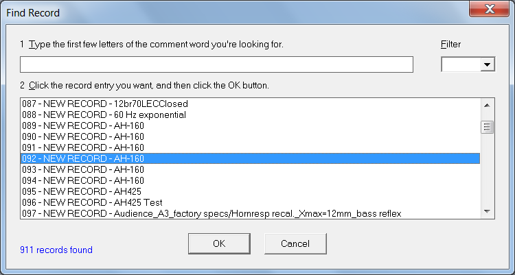

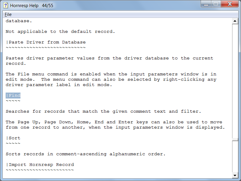

Also, a question, is there any way to get to record 92 without clicking on next 91 times.
As Dan has pointed out, Crtl+F is the shortcut to the File > Find tool. To find record 92 specifically, I would normally just scroll down through the list to the 092 entry and then double-click on it to select that record. Note that in many cases it is not really necessary to use the Find tool, as it is possible to quickly 'home in' on a particular record using the Page Up, Page Down, Home, End and Enter navigation keys when the input parameters window is displayed.
It's all in the Help file :).

Hi xrk971,
Kind regards,
David
