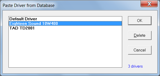

That is helpful, but upon first entry, does one still need to put the values into the little dialog entry boxes on the front panel?
My question comes from the fact that I have a database that looks like this (but with about 200 drivers) which I simply copy and paste for use in Akabak. I don't want to have to type the data into dialog boxes for each entry. I also like to have ability to have a comment that lets me add notes. Akabak can take the following info in order, and it has units as typed.

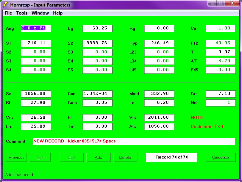

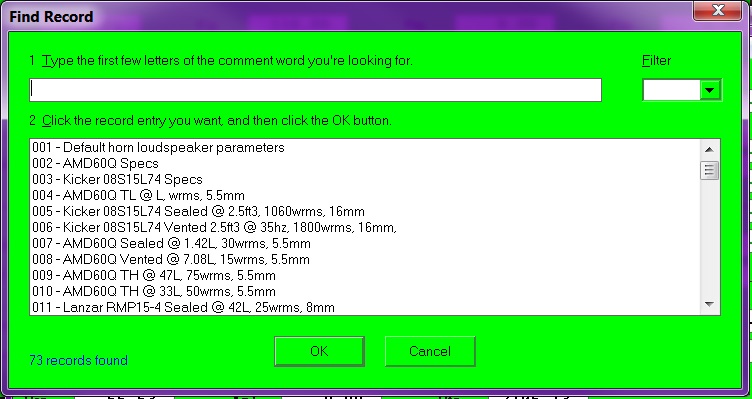

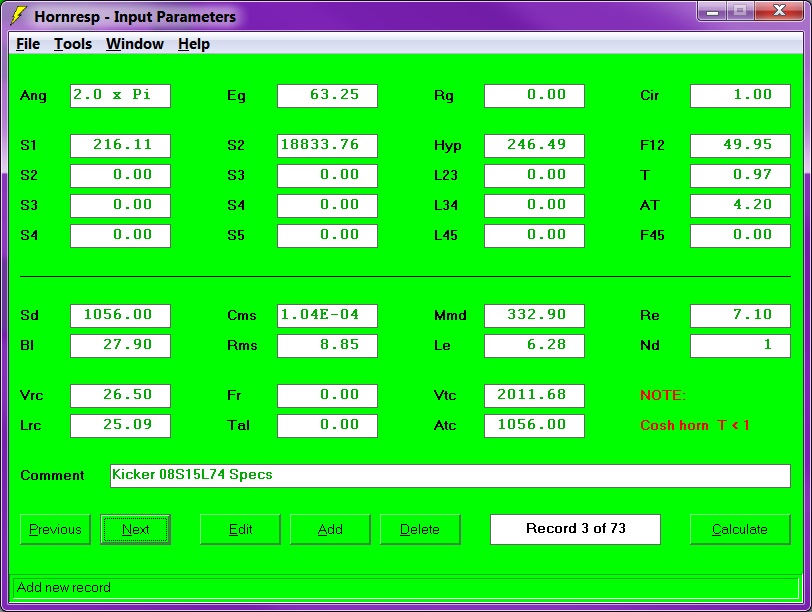

All you have to do is create a new file from the initial model from the input screen. There is a text field at the bottom of the input screen. You can always do a Find on any saved model when you launch HR. When I get back to my desk, I'll send a screen shot.
I hope the pics explain the process to you X! Just type over the red text. When you save the file, the new text will be saved.

Hi xrk971,
Yes one does - and that is not going to change .
It is actually not too bad once you get used to it - if you spent 10 minutes a day entering the data for 10 drivers, after 20 days you would have all 200 of your drivers in Hornresp .
Each record in the driver database is stored as an individual text file in the Hornresp \ Drivers folder. This approach was taken because people were talking about setting up a common driver library from which Hornresp users could download files as they needed them. Unfortunately nothing came of it, though, so that each user is obliged to progressively build up a personal database from scratch.

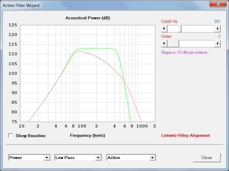

Hornresp Update 3910-150524
Hi Everyone,
CHANGE
Pressing Ctrl+C when the power or pressure response chart is displayed in either the Filter Wizard, Loudspeaker Wizard or Multiple Entry Horn Loudspeaker Wizard, captures the current results. Pressing Ctrl+V shows or hides previously captured results. Not applicable when room gain is included. The captured trace is shown in light green.
The feature was requested for the Filter Wizard by Dave in Post #5435. The functionality has also been added to the Loudspeaker Wizard and the Multiple Entry Horn Loudspeaker Wizard.
