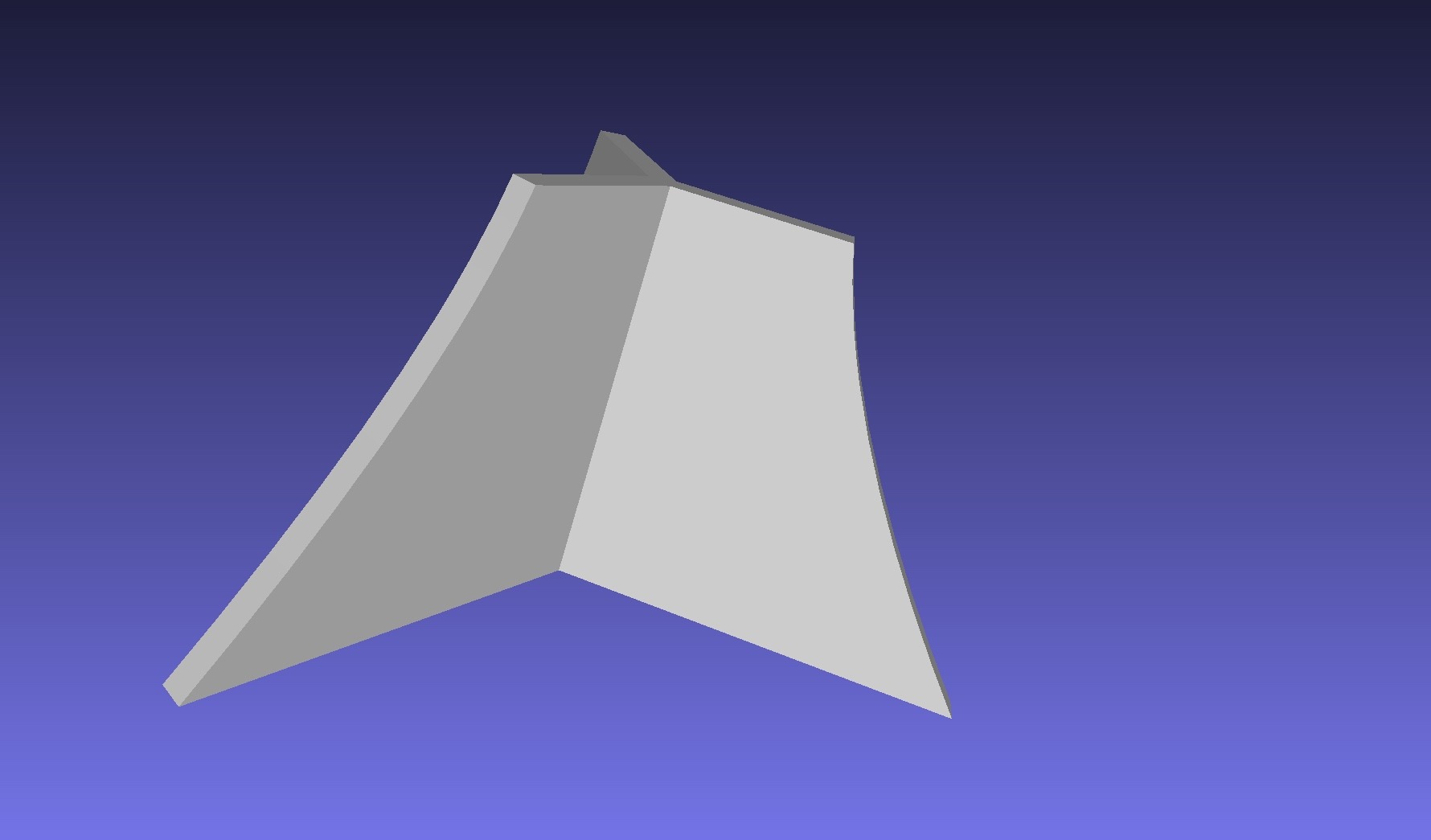

I'll post them somewhere, especially if I have time to try them in application and perhaps even try to record any differences if there is. Not sure yet how to do it. Currently I have only one waveguide, RCF H100, that has mounting points for all the drivers. There is plenty all kinds of evaluations of drivers on the web so I'm not sure how to contribute. The test is for me mainly, to be able to listen. Tests from others are just textAha - that fleece is actually felt and it is set around like a scarf - it was initially to fill the void between the WG and the concrete housing but it happened to double as diffraction catcher... now still do fill duty but diffraction job is now the duty of Chewbacka...
I'll will later post the print file for the fins I made for the 260 so you could try them.

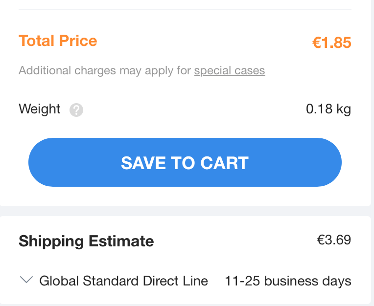

I haven't been able to buy one yet. But pile of prototype plans seem to grow so it perhaps makes sense to consider investing in one unfortunately, I haven' been able to find any affordable local service to have prototypes made, luckily there seems to be plenty available online.
https://3d.jlcpcb.com/3d-printing-quote?from=homepage
Just add the file I posted above - wait 20 days... or shorter but then shipping is expensive...

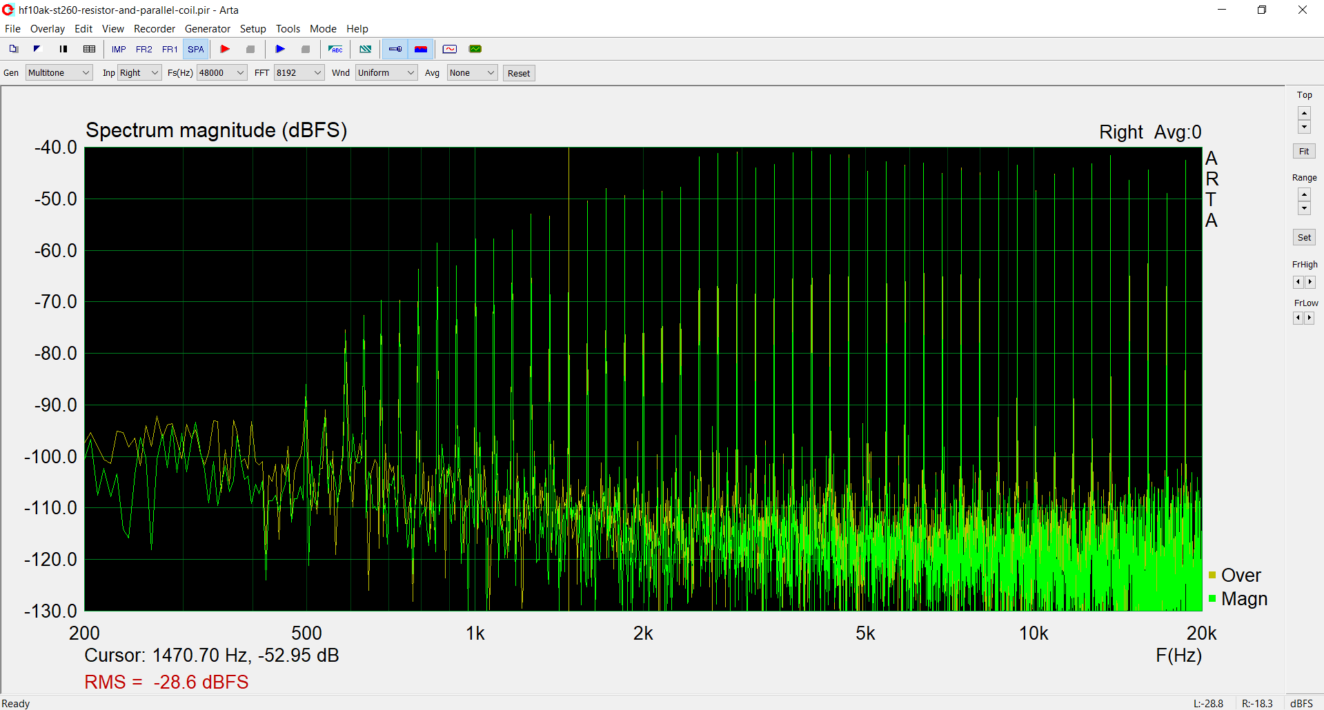

Since started posting about this stuff here I'll continue to keep everything in same place, if you don't mind TNT? Had some time today to make multitone test.Hi, I was silly and forgot to take multitone measurement before modifying both waveguides! took some on axis mesurements though, but any differences seem to fall within error margin. I was in a haste though, and excited that a layer of viscoelastic glue behind waveguide rim seemed to make quite a difference. Adding more and more, tapping with finger and listening the ringing, gradually making it less noisy sounding. Listened stereo only one waveguide treated and phantom center seemed awkward so it must have made some difference, although there is still some improvement with the finger technique and it was late night and so on. In other words there seems to be a difference. Should have recorded the tapping as well

Finger technique doesn't seem to show meaningful difference in multitone test, but now I have the treated waveguides only, perhaps it would have shown earlier.

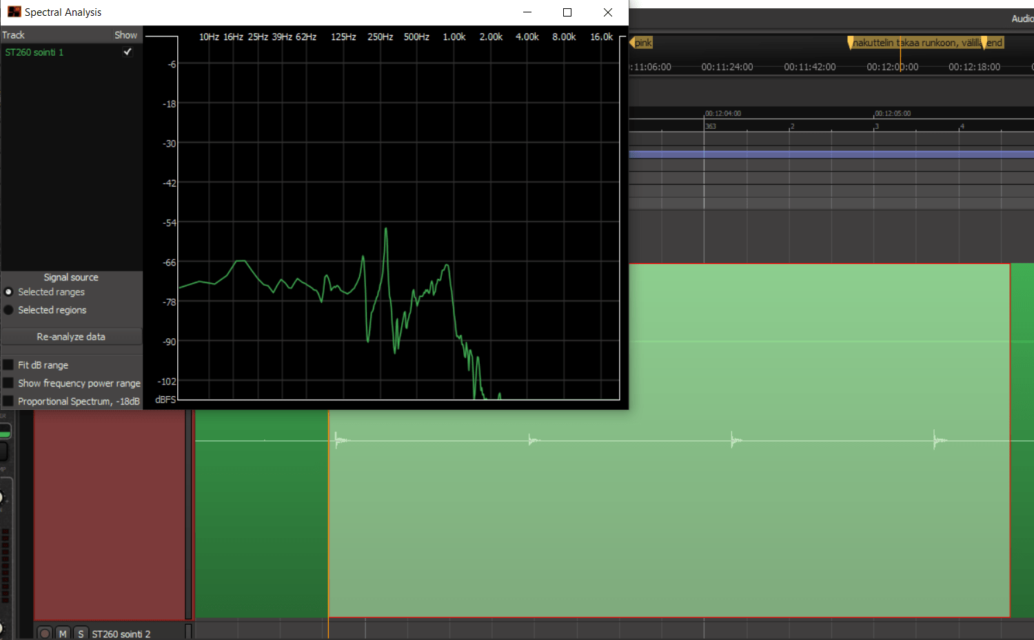

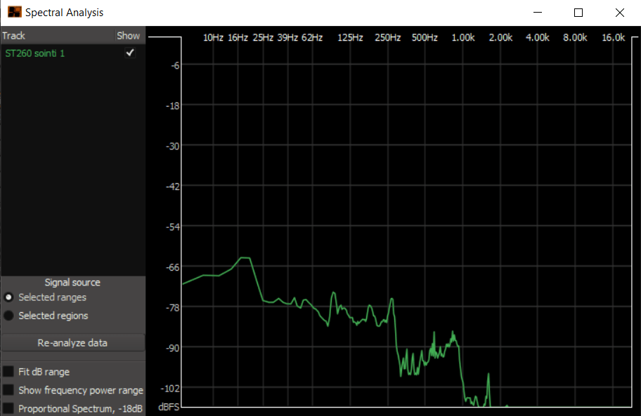

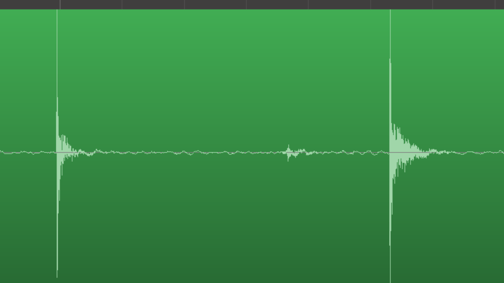

Found out that knocking the speaker structure from behind close to compression driver the waveguide ringing was audible, no music playing. Recorded the knocking with mic and sure enough the resonances seem to be quite low in frequency, below pass band. Here "spectral analysis" of the recording, first image showing the ringing, second image is damping the waveguide with hand. Most difference seems to be somewhere around 200Hz and below 1kHz.
Zoomed waveforms, first knock is with finger damping and second is not. Listen mp3 file, first four knocks are with finger damping and last four without, ringing readily audible.

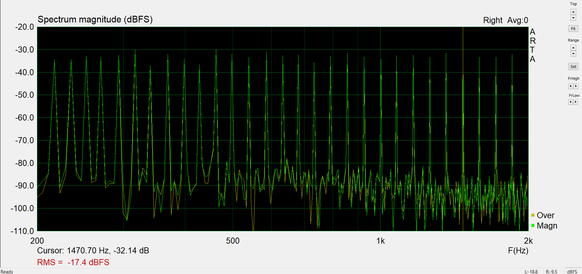

Since the resonances are is so low in frequency played the whole speaker. Here multitone measurement with mic perhaps 50cm away trying to capture any difference, but it's about in the error margin.
The ringing is easily audible while knocking the waveguide, but hardly audible anymore with music playing and using the finger technique.
Anyway, the multitone signal was quite ruthless showing cabinet resonances for touch, much more so than music. With music it's hard to tell if hand feels a vibration for some reason, but with the multitone playing it's very evident the structure resonates. Not sure what to think about it but anyway, if there is need to analyze cabinet vibrations try multitone signal.

What was the DUT? Just the WG or whole speaker? Multitone was from 200Hz - was this only WG?
In the mp3 the bigger peak (5th) in the middle of the recording sound really nasty - it has that resonance ring to it - awful!

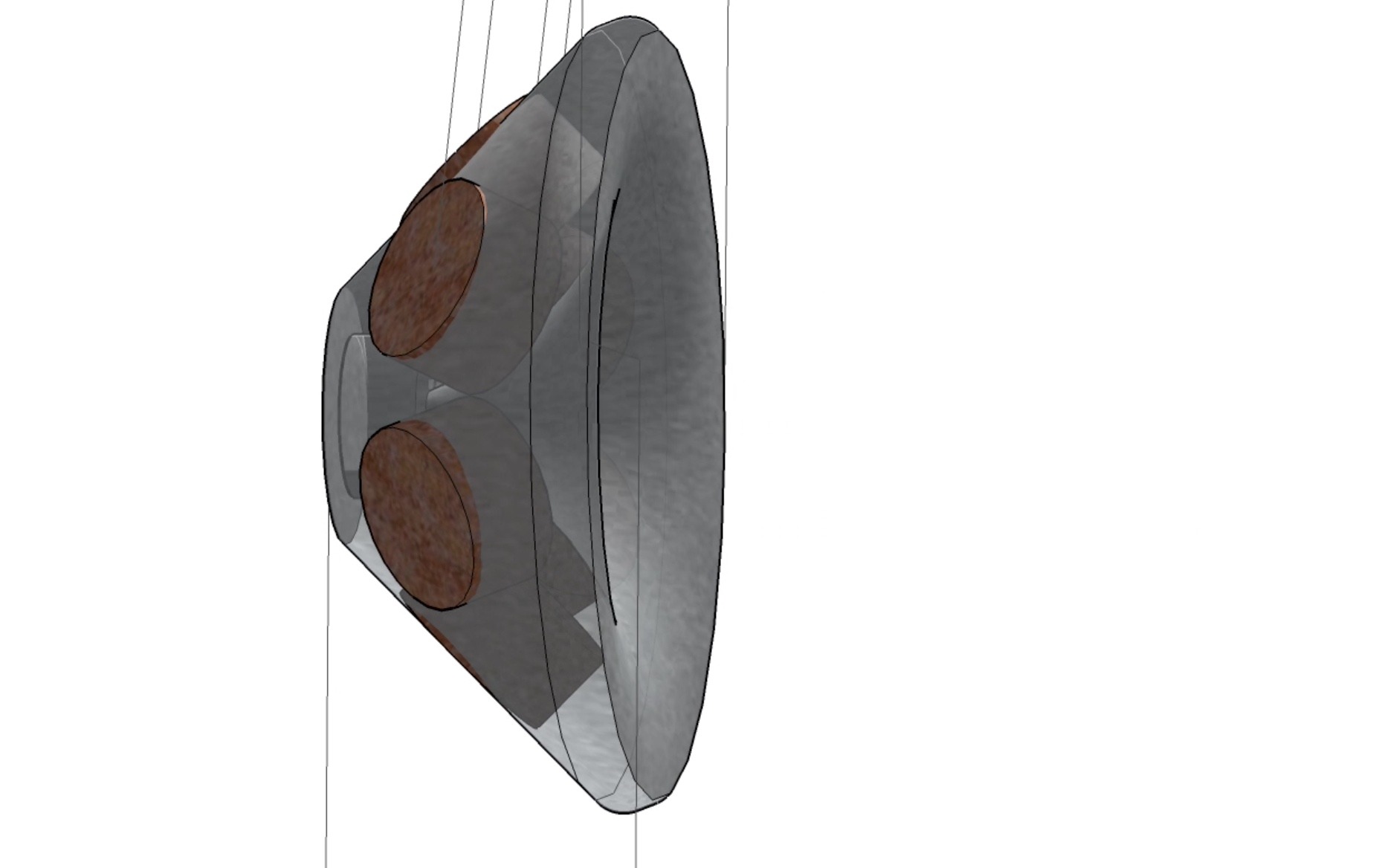

I think it is important to see to that noting else than the membranes in a speaker moves. I'll go long to achieve that. I'm nor sure I succeeded fully in the Horflowers - probably more to be done. But I''m contemplating a bigger model
60cm dia WG and 6 pcs of 5" bases per speaker....

The whole speaker silent, just me knocking back of the thing, and resonance transmitting to the waveguide which then rings. Mic was perhaps 10cm in front of the waveguide. Four first knocks is damped with my other hand, last fpur knocks without damping and it rings
Luckily, knocking around mid driver or woofer portion of the system, and the waveguide doesn't make a sound, but only if I knock behind the CD the resonances transmit and make it sing.

I not sure I still can follow... Can you post a picture of the speaker? Do you mena that you knock on the Compression Driver backside?
