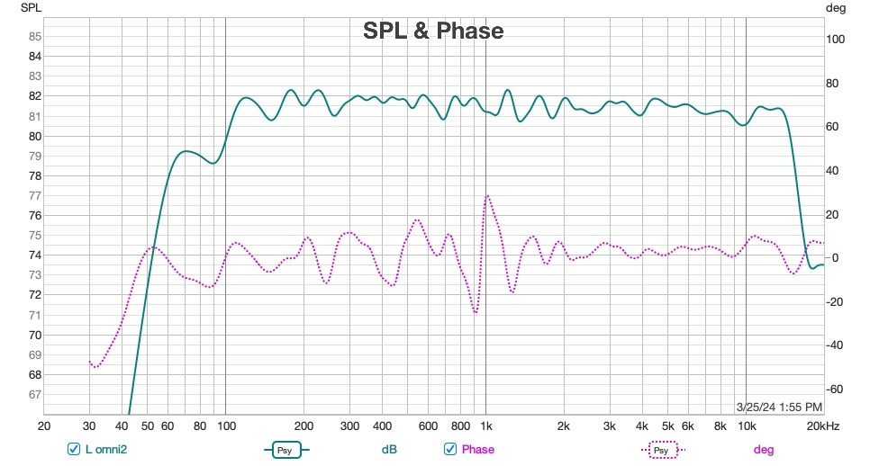

Okey I'm back true to the concept architecture and play the WGs with the Topping HP amp. Now for some reason it works wonders

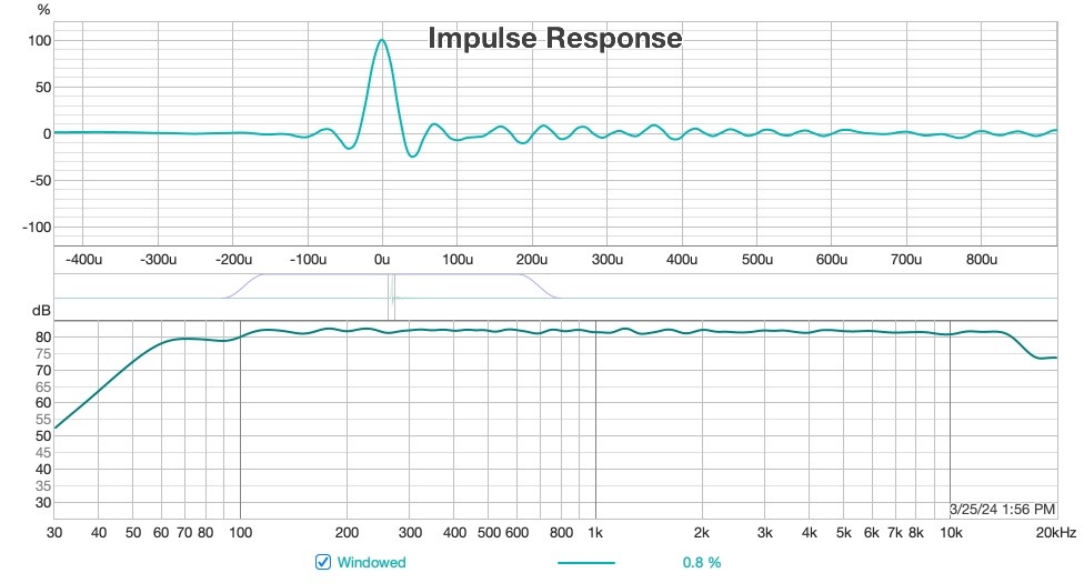

Changes are: the "fins" and but also now FIR EQ. FIR is in two steps; FR + phase. And made individually per channel.
It now looks like this in the sweet spot: (I have made one per for a bit a lowballs lift - REW, as usual, ignores the extremes....)
They sound full, resolved and relaxed... jipiie so bloody fun!

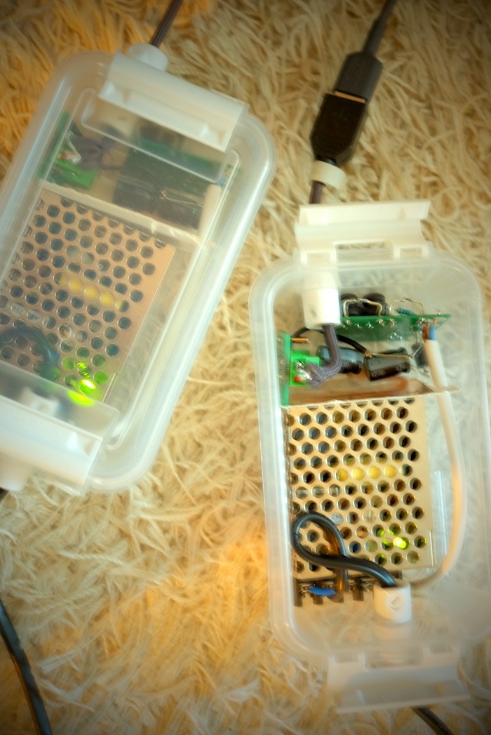

So, I switched DACs. They costed 69€ each. Now it sounds better. No evil tones sticks out any longer. The speakers dissapear to a much greater extent. And the soundstage is bigger, so is the envelopment. Everything took one step back. And it's generally cleaner. The new ones are SMSL SU-1. They use AKM chips and not ESS so the esshess are much nicer ,-) They are powered by its USB inlet so I first used IKEA 5€ units. It was OK - still beter then the SU-6.
I then built 2pcs of 5V supplies based on Meanwell 15V smps (@12) -> a 5V zener -> an RCRC filter -> a PO89ZB filter -> an ldovr LT3045 reg; now it all got really nice.
I'm really happy with this.

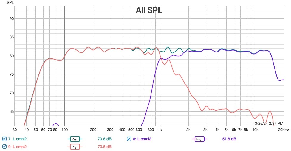

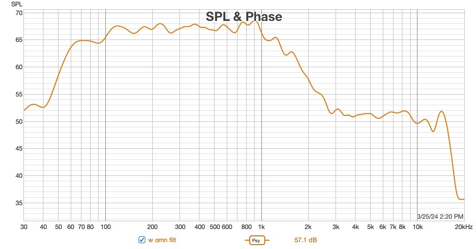

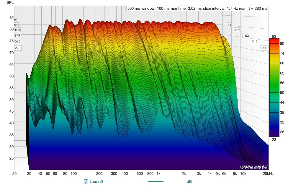

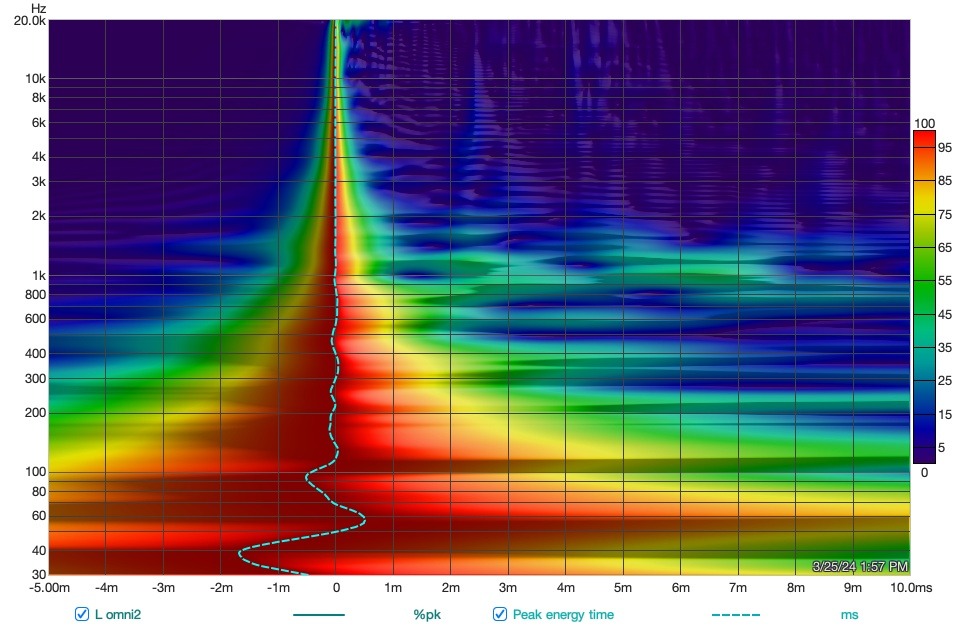

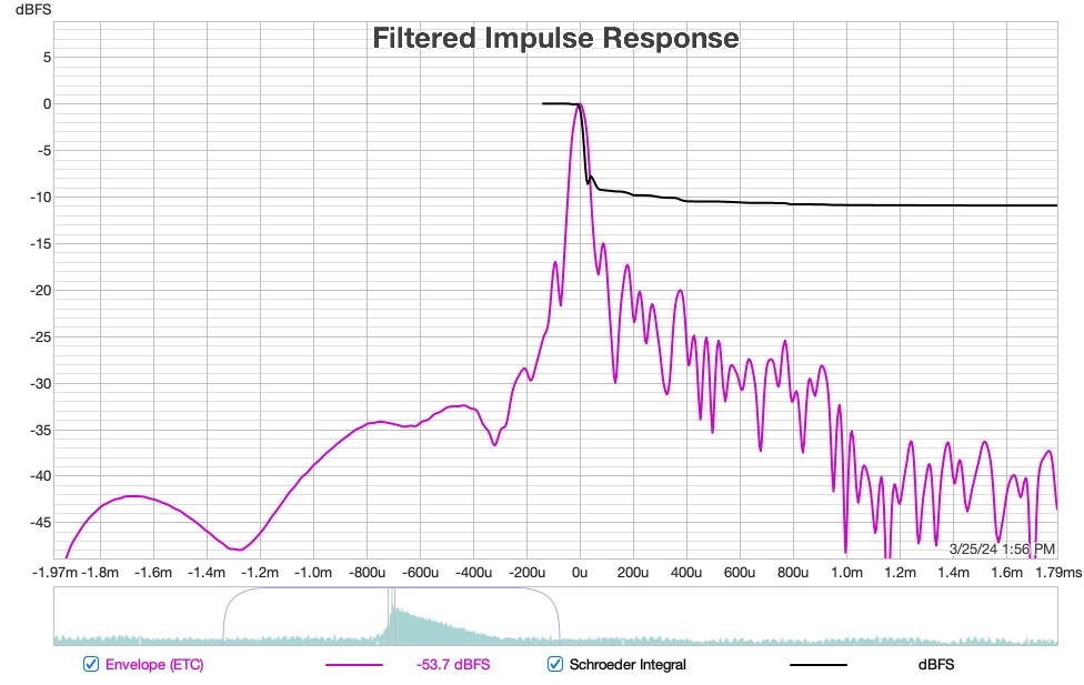

Made a new round of measurements and filters. I had an idea that I could use the 4 backwards reflecting woofers per speaker to add some broadening of the directivity in the higher half part of the speaker to match that of the lower. I made a new filter with low level high shelf to accommodate the increased energy upwards. So no XO for this "way"...
... and seeing the other...
This sound wise seemed quite promising to me so I continued to make a full implementation which in the end measured as follows 70cm from WG mouth. Levels not calibrated.
Please mind the scales:
Still some room for improvements around 1k XO tries to be 1,6k ... the steepness towards the low level shelf dont match the HF one..

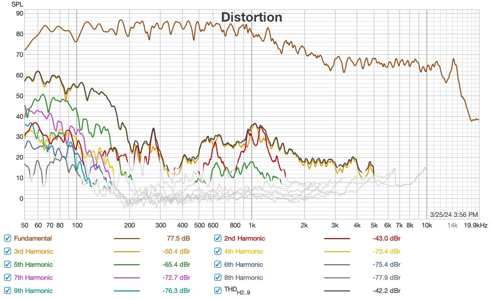

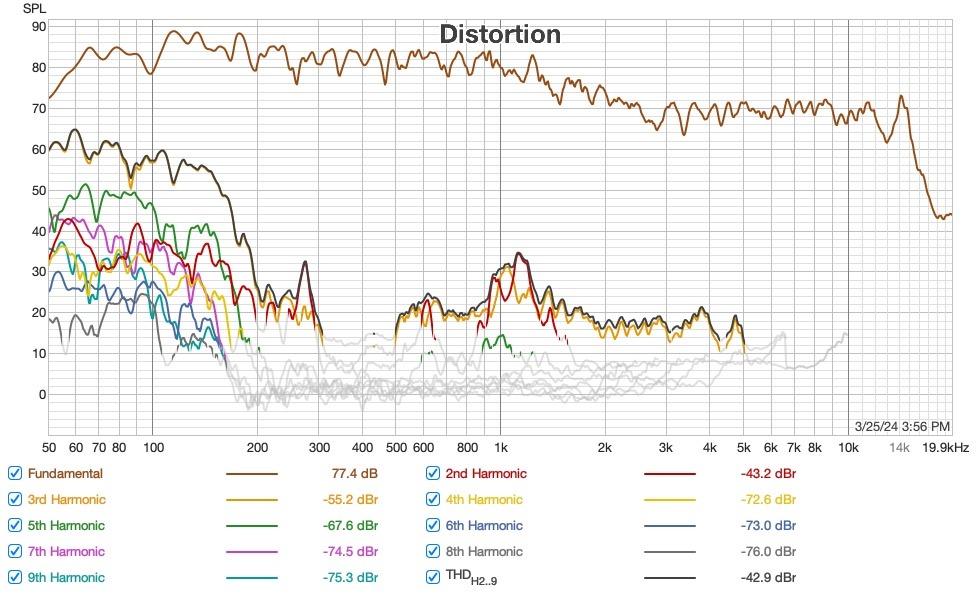

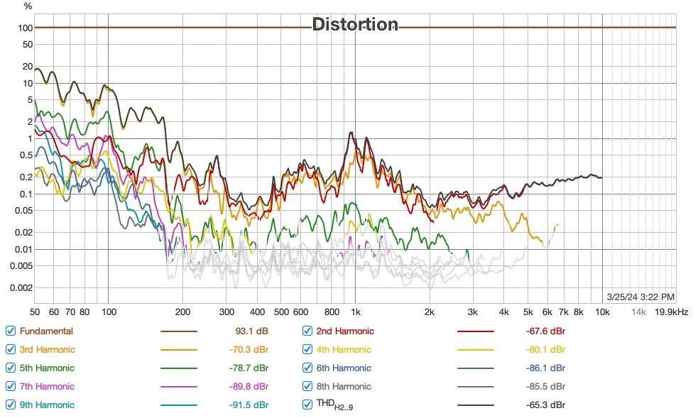

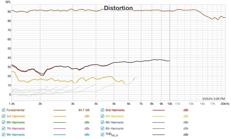

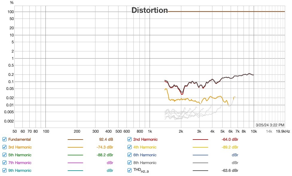

Distortion at calibrated levels:
Measurement setup: 70cm to WG mouth.
Low frequency levels are not surprising given that there is 4 pcs of 4" woofers in a too small closed box playing
Just to verify that it is not the HF part that is contributing
200 and up looks quite good ;-) but would lie to see 1k region drop to 0,1% ...
Hi, you could try increasing impedance to see if the midrange distortion reduces Quick test would be to just put resistor on speaker input and see if it affects the distortion bump there. If it does, you could then individually test both mids and tweet which one is it and perhaps come up with more permanent solution. If not, it's likely some resonance / noise.
The source of the distortion was already determined if you check what I posted.
8ohm Resistor on the LF "way" (HF off!):
No resistor - I adjusted the level son that the 1k regions was the same for the two measurements.
A small difference in favour of the resistor, distortion wise - the peak at 1,3 was not effected. One also see the impact on the FR - but no problem to EQ out...
