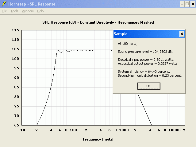

Not until one reachs efficiencies of 30% or more does this happen. But at these efficiencies the devices are not very usable because the compression ratios are so high that the amplification of the parasitic effects makes things difficult.
Efficiencies that high is not very hard to achieve in bass horns, even with moderate compression ratios. Efficiency in the order of 70% was achieved in the bass horn of the so-called Fletcher-system developed by the Bell labs, with a compression ratio of 4.5.
This assumes efficiency defined as (Acoustical power output / Electrical power input) *100%.
The theoretical concept of cutoff comes from an infinite horn in Websters Eq. Infinite horns are impossible and Websters Eq. is incorrect, so the entire concept is obsolete.
I would rather say that Websters eq. only gives a limited amount of information. It's an approximation, and should be treated as such. It is not usable for designing horns intended primarily for directivity control.
To make it clear for everyone, cutoff is the frequency where the acoustic throat resistance of an infinite exponential or hypex horn is zero. This point does not exist in a finite horn, where throat resistance will never be zero. The reason is that the radiation impedance at the horn mouth is not zero at any frequency.
But, taking for example an exponential horn, at some point the throat resistance will drop quickly, and this is always above the cutoff frequency of the corresponding infinite horn, higher in frequency the less the difference between throat and mouth areas, especially with undersize mouths.
So strictly speaking, the concept should not be applied to finite horns.
If the maximum power transfer occurs when the source impedance equals the load impedance, then 50% efficiency is the maximum that could ever be achieved. How could one ever exceed this number? The driver itself would have to have NO electrical impedance at all.
I would guess that bass horns have about 10% efficiency max. And even that would be very hard to do. Most LF drivers are about 1% efficient.
From Keele, "Maximum efficiency of Compression Drivers", AES Convention Paper 6193, October 2004:
"Small-signal calculations show that the maximum nominal efficiency of a horn loudspeaker compression driver is 50% and the maximum true efficiency is 100%. Maximum efficiency occurs at the driver’s resonance frequency. In the absence of driver mechanical losses, the maximum nominal efficiency occurs when the reflected acoustic load resistance equals the driver’s voice-coil resistance and the maximum true efficiency occurs when the reflected acoustic load resistance is much higher that the driver’s voice-coil resistance."
Bell Labs used the "true efficiency" value, not the "nominal efficiency" value. IMHO, true efficiency makes most sense to use, as it relates directly to how much power is converted to sound.
The efficiency of bass horns depend on many things, but by using an efficient driver it can easily reach 30% and more. A quick simulation in Hornresp using a Beyma 102Nd driver gives efficiency in the order of 50-70% efficieny in the pass band, depending on frequency. (4Pi space, 4:1 compression ratio).
B

gedlee said:Efficiency - in numbers - is not something that I deal with regularly, but your numbers seem highly suspect to me. It would be very very difficult for the acoustic impedance to be greater than the electrical impedance. Your numbers seem to be based on HornResp calculations and I'm not sure where those come from. The only definition of efficiency that I know of is the nominal, which cannot exceed 50% as I said. I don't know what "true" efficiency is.
If what you say were true then compression drivers would not even get warm, but the fact is that they melt down regularly.
Hi Earl,
Just to clarify, Hornresp calculates loudspeaker efficiency based on the net power available to the loudspeaker, not on the total power generated by the constant voltage source (some of which, as you say, is absorbed by the amplifier output resistance).
Kind regards,
David
