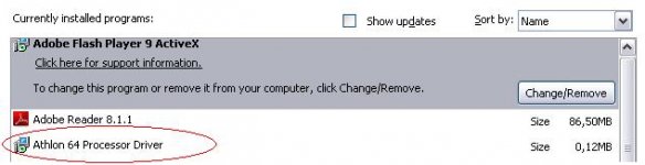

David McBean said:
Thanks for confirming that you have an Advanced Micro Devices Athlon processor. Unfortunately, this means that you are out of luck as far as running Hornresp on your existing computer is concerned.
I can run Hornresp on AMD Athlon XP, Athlon 64 and Athlon 64 X2. I know that the x2 have some rare problems with certain applications. Installing the AMD processor driver has cured the few problems I've had with the dual core processor (x2).
It's a mystery why MS does not include this driver through MS update, when driver being WHQL certified and all.
I don't know in this specific case but this could be something that might help get Hornresp up and running.

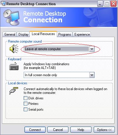

gedlee, do you have this driver installed, pictured below?
What does Remote Desktop have to do with anything?

gedlee said:I have five computers and two laptops - not one of them uses Intel. This explaination does not make sense to me either since SPEAK is written in VB (version 3 through 6) and it never had a problem that was CPU dependent. And its not like AMD is some abscure hardware - all HP computers use AMD. I now only use HP computers because of the performance and reliability that I have seen over the years.
Hi Earl,
It would seem that sometimes, Hornresp just doesn't like AMD Athlon processors . There is a note to this effect in the "Known Problems" section of the Readme.txt file (supplied as part of the progam download package). You can see from the fault list that very few operating problems have been reported, even though Hornresp has a relatively large user base.
I have only one computer - a HP Pavilion desktop - it came with an Intel processor.

4fun said:I can run Hornresp on AMD Athlon XP, Athlon 64 and Athlon 64 X2. I know that the x2 have some rare problems with certain applications. Installing the AMD processor driver has cured the few problems I've had with the dual core processor (x2).
Thanks 4fun. I was not aware that there might be a relatively simple solution to the Athlon problem.
