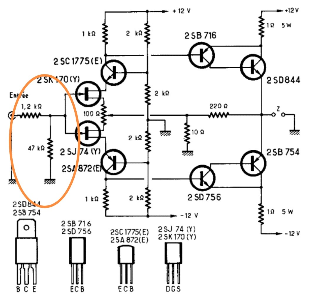

I'm considering changing the input impedance of my Le Monstre as I want to use it with a DHT pre, and for that I believe I'll need to use a 100K shunt resistor (rather than 47K). Can anyone can advise if this is a silly idea (or not).
I'd also find it really helpful if someone could walk through the input impedance calc for this amp.
I'm trying to understand why JLH chose a 1K2 input series resistor, rather than 1K. Is this front end really that different to any of the Pass designs (M2 etc).

Very probably Jean Hiraga tried some values for the gate stopper and 1K2 worked a tiny bit better than the others.
For the 47k is probably the value that works the best in most situation. Of course of you have a preamp with high output impedance raising it will give better results.

At the time, an input impedance of 47k was considered the "standard" for line preamplifiers and power amplifiers.I’m thinking about reducing the input sensitivity of my 8w le Monstre and have a couple of questions for the knowledgeable folk contributing to this thread.
- am I right in thinking that if the 1k2 and 47k resistors on the input are both changed to 10k this will reduce the sensitivity by half?
- if so, does this have knock on effects on the rest of the circuit, or is it a benign change? For example, would this change input impedance?
Grateful for any thoughts. I realise there are alternative solutions such as changing other components in the chain, but would like to focus on the Monstre at this stage.
Since this is a jFET input stage and jFETs have a very large gate to source impedance, you can safely raise the value of the 47k input resistor on the expense of a slightly raised input noise.
10k over 10k is a -6dB divider. Most sources (this day) can drive line loads down to 10k without issues. (This example yields to 20k.)- am I right in thinking that if the 1k2 and 47k resistors on the input are both changed to 10k this will reduce the sensitivity by half?

Rin resistor can be placed first and then gate stopper after
in fact, that arrangement is more common, even if with moderate value of gate stopper there is no practical difference, neither technical nor auditive
in that case is avoided getting signal divider
anyhow- value of gate stopper is in conjunction with overall circuit construction - as example - last iteration of F5 from Pa (F5m, this years BAF presentation) is having gate stopper of 22K
Pa simply shaped Hf amp behavior with that value, avoiding need for compensation caps in NFB loop

…at 27k for that matter, which would give something closer to the intended Rin.The more interesting question is whether the gate stopper resistor is doing its job at that value - 10k - or
Increasing the input resistor to gnd does not increase input noise.At the time, an input impedance of 47k was considered the "standard" for line preamplifiers and power amplifiers.
I've been experimenting with various resistor values on the Le Monstre inputs. I'm now at 3K series and 220K shunt., I think this is about as far as is sensible.
The hiss from my DHT pre is greatly reduced, but it's still there.
This pre is silent into an M2/ LuDEF. What's going on here that I've missed? Is it just the case that the pre has too much gain for the power amp?
