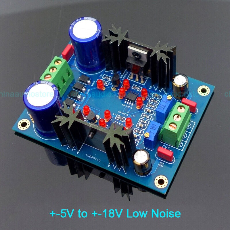

Looking for information about the Walt Jung power regulated power supply circuit, I found this board. Is it a Chinese tale?
https://www.ebay.com/itm/255256255871

That regulator has nothing to do with Walt Jung's regulator, unfortunately there are copies everywhere today including in DIY audio.Looking for information about the Walt Jung power regulated power supply circuit, I found this board. Is it a Chinese tale?
Not yet, some parts of the circuit are protected by copyright but I hope everything will be published soon.Thanks Grunf, any schematic, diy pcb?

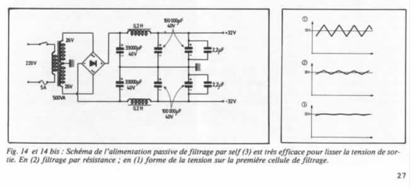

I must say from experience that the CLC sounded better than a CRC or a C-reg-C. I used separate chokes in a version that I demo'd. It weighted some 20 kg - so later I reduced the build to smaller power supply versions, with every step in a smaller housing the highs got less brilliance and the lows less depth, but measurably it all was great. The point is that the regulation with CLC better filters the higher harmonics while they allow a great (i.e. short) recovery time.View attachment 1200797
Hello,
This was published in 1988 in french l'Audiophile magazine #43 written by Mr Johannet and Mr Walther
The choke was a 200mH model 0,7 ohm dcr. I used it in my 30 watt Hiraga and it was first used in Le Nemesis ( single ended transistor amp by Jean Hiraga.
Right drawing
#1 the shape of the '' dc '' at the first cap
#2 the shape at the second cap when using CRC
#3 The shape at the second cap when using CLC.
Pretty obvious. RC is only 6DB and LC is of course a 12 DB filter.
Greetings, eduard
