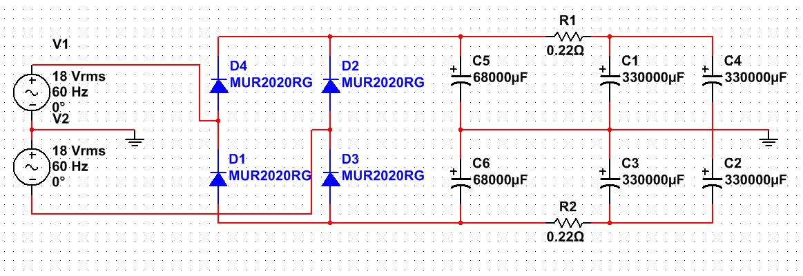

Can you tell me why using 24V 15A SMPS is not good? I put inductor in series with the output and I put 40mF on each rail for each side. So I have 160mF reservoir cap total after the inductor. I don't think this will be in any way inferior to any toroidal supply.
You guys keep talking about ripple and voltage droop. I will not have droop and ripple. I would like to hear a real reason why SMPS is inferior.

That's the reason I have the few uH high current inductor right at the output. It's really not that bad, we used to use all analog regulated supplies in our mass spectrometers, but I changed to all SMPS and be careful on the pcb layout with ground planes. We are working with nV signals, we never have problems with noise.

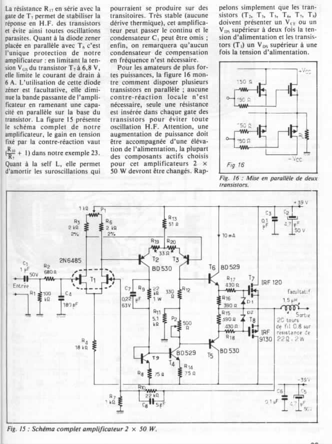

I don't understand a word on the article with the schematic!! Is that the original Hiraga schematic?

On en parle n°34 : modifs ampli Hiraga 20W, tweeter technics 5HH10 ...

a little mistake, last caps not connected with ground.
Cause low speed for this amp, not have time to give the necessary current to the load. I have Hiraga 20W (from L'Audiophile '34 jan. 1985). With 0,404F summary filter and 2*160W transformers on high frequencies it has some "metallic overtones" into Martin Logan Electromotion, but with 1,26F filter and 2*300W it's alright.

Now you are talking about droop, transformer droop also particular it's not even regulated.
I never said use the SMPS alone. I am going to have filter caps. At least 20,000uF for each rail.
I never understand why supply is half the design. You want stiff voltage rail, that's about all you can ask for. Charging at 40KHz sure beats charging at 120Hz. I bought two 24V SMPS that are 15A for less than $50. I don't think you can touch a toroidal transformer + rectifier + lot more cap with that price .

Problem with using SMPS for normal Class AB is because you need 48V and higher, SMPS cost a lot of money for higher voltage, that make it not worth your while. Also, the normal design of the 2EF/LTP topology has much better PSRR than the Hiraga, sag is no even an issue.
But for Hiraga that use 20V rail, it's perfect to use 24V SMPS that is cheap like dirt. You just adjust down to 20V!!! You want sag, put a 0.22ohm and filter caps like the schematic of the supply used!!!
I cannot imagine the SMPS will droop more than any of the transformer. Still worry, get a 20A+ SMPS, you are not going to droop!!!
