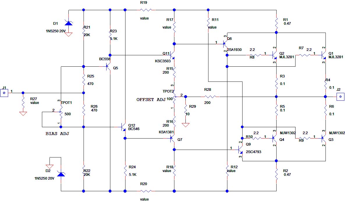

LTSpice of this amp, ahem, is very interesting.
Total Harmonic Distortion 1KHz +20dBU output into 8R: 0.232734%
99.9% of this distortion is H2+H3+H4 with H2 at -53dB and H5 at -83dB for +20dBU output
0.254% THD at 20KHz, +20dB into 8R. Quiescent current is 1.39A
Phase shift at 20Khz//+20dB output into 8R resistive is 3.44 degrees
180 degree phase shift (with LP in place) is 4MHz
Gain is 18.3, that is, 25.3dB for 770mVp input and 14.14Vp output at 1KHz (+20dBU)
1dB point at 240KHz NO LOSS at DC signal
FEATURES: Poor, asymmetrical clip at 21V/27.5W into 8R.
Very high distortion artefacts, arrayed in a monotonic, almost linear reduction
Set offset cold extremely tetchy; 1R change on 500R generates 5mV offset
This should set some discussion. I have attached the LTSpice file.

Hugh, I`ve done the simulation you`ve attached but with the 4 ohms load, the output power doubles like in all ss amps, there is no output transformer effect as described in the original article. The harmonic structure ( never mind the high distortion) is btw as you described "arrayed in a monotonic, almost linear reduction" that you don`t get with the classic output stages. Very interesting.LTSpice of this amp, ahem, is very interesting.

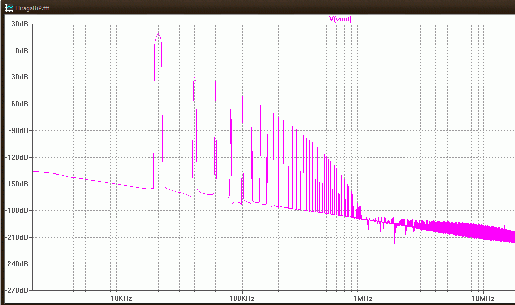

Do you mean monotonic distortion is H2 higher than H3, H3 higher than H4, H4 higher than H5, etc?
This is FFT from my amplifier. Is the distortion monotonic?
Yes, Bimo, betul benar, you have it........
Your figures are pretty low, I get this fft at 20K, high, but much lower at 14.14Vp into 8R at 1KHz (+20dBA).

If you add 100nF you see little change in harmonics or even phase shift. Add 2uF, simulating an ELS63, you do see a distortion increase of 20dB for the first ten harmonics at 20KHz fundamental. At 1KHz the change is minimal, however. I agree an IHF load should be used in the simulations, however, for an amp with low global feedback stability is less affected. At very low THD amps with very heavy global feedback the situation is very difficult.
Hugh

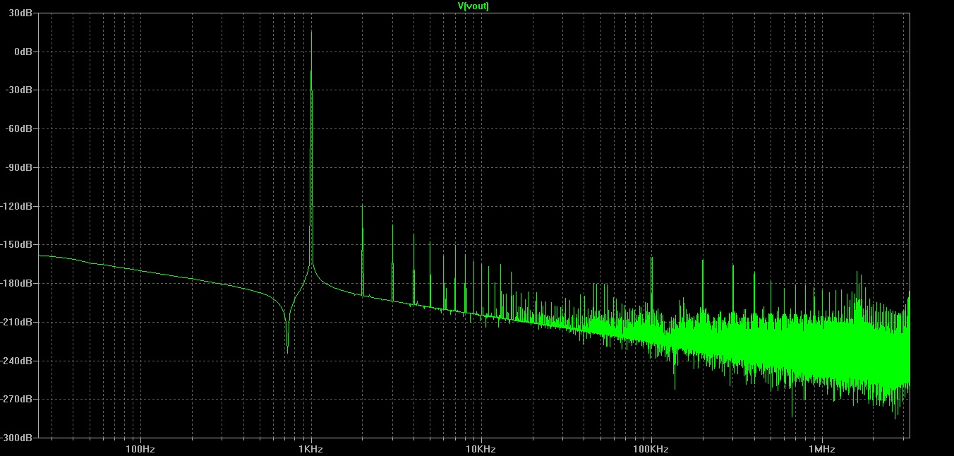

I am new with LTSpice. It seems like you are running larger time step or fewer cycles to speed up the simulation. From my experience, it will give lower THD. You distortion seems too low of 15dB-(-120dB)= -135dB. I run small time step and get like 50 cycles, usually takes me over an hour to run one simulation, BUT the graph is a lot cleaner with very narrow peaks. That is more accurate.Do you mean monotonic distortion is H2 higher than H3, H3 higher than H4, H4 higher than H5, etc?
I am still not familiar enough with this design. But according to the author, it's not the distortion that matter, it's how the distortion interact with the harmonics of the instrument ( can be voice also). He talked about the timber?? of the sound etc. That's what intrigues me, that he uses quasi current output that interact with the complex load of the speaker instead of brute force driving the speaker with very low impedance.If you add 100nF you see little change in harmonics or even phase shift. Add 2uF, simulating an ELS63, you do see a distortion increase of 20dB for the first ten harmonics at 20KHz fundamental. At 1KHz the change is minimal, however. I agree an IHF load should be used in the simulations, however, for an amp with low global feedback stability is less affected. At very low THD amps with very heavy global feedback the situation is very difficult.
I use more cycle and THD don't change to much It is have high open loop gain. It will give low THD and I was built it, sound better than 4 commercial amplifier (and more expensive) according to my friends who compared it.
To see more clear on FFT at 1kHz, I was change input and feedback capacitor to 1F

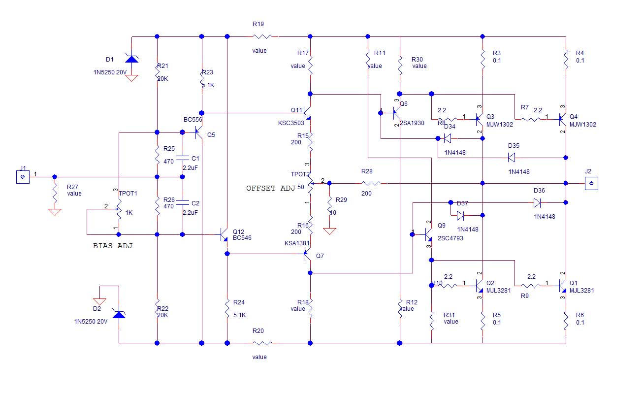

This is my rough try on the circuit. This is more a starter for conversation than a design. I have not really get into the value of the resistors or really give it a lot of thinking in the details. But two things I like to improve are the power handling as I use two pairs of power transistor. Also, the bias and offset is not good in the original circuit. I am trying to separate them into two distinct adjustments as shown.
I was first temped to add CCS to raise the open loop gain, but I think that will make it into another SS amp. To me, it's more important to preserve the low open loop gain and let the quasi current output stage shine instead of using the high loop gain to swamp out the effect.
I definitely would have close thermal coupling between Q5 & Q11 and Q7 & Q12 to minimize bias and offset drift.
