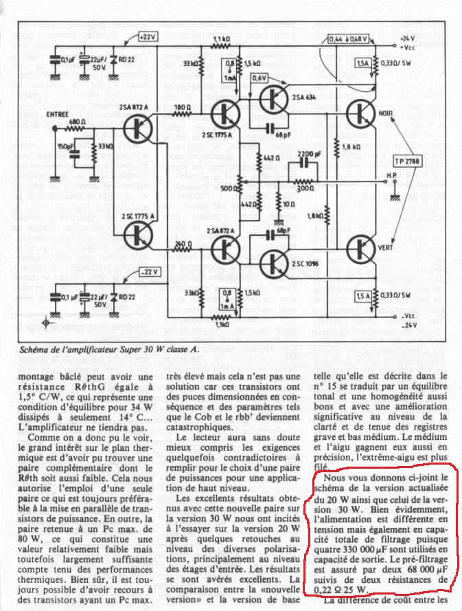

Original Hiraga's power supply had 600W+ transformer with filter 0,068F-0R22-0,66F in shoulder. (1,456F summary filter)
Cause low speed for this amp, not have time to give the necessary current to the load. I have Hiraga 20W (from L'Audiophile '34 jan. 1985). With 0,404F summary filter and 2*160W transformers on high frequencies it has some "metallic overtones" into Martin Logan Electromotion, but with 1,26F filter and 2*300W it's alright.

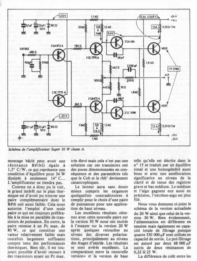

BTW, do you have the schematic of the original Hiraga amp? I've seen too many different version. I want to built the real thing. Thanks

2 caps 68000 uF and 0R22 and 4 caps 330000uF - original filter.

1,456F (2*68000uF+4*330000uF)
- Hiraga 20W class A
