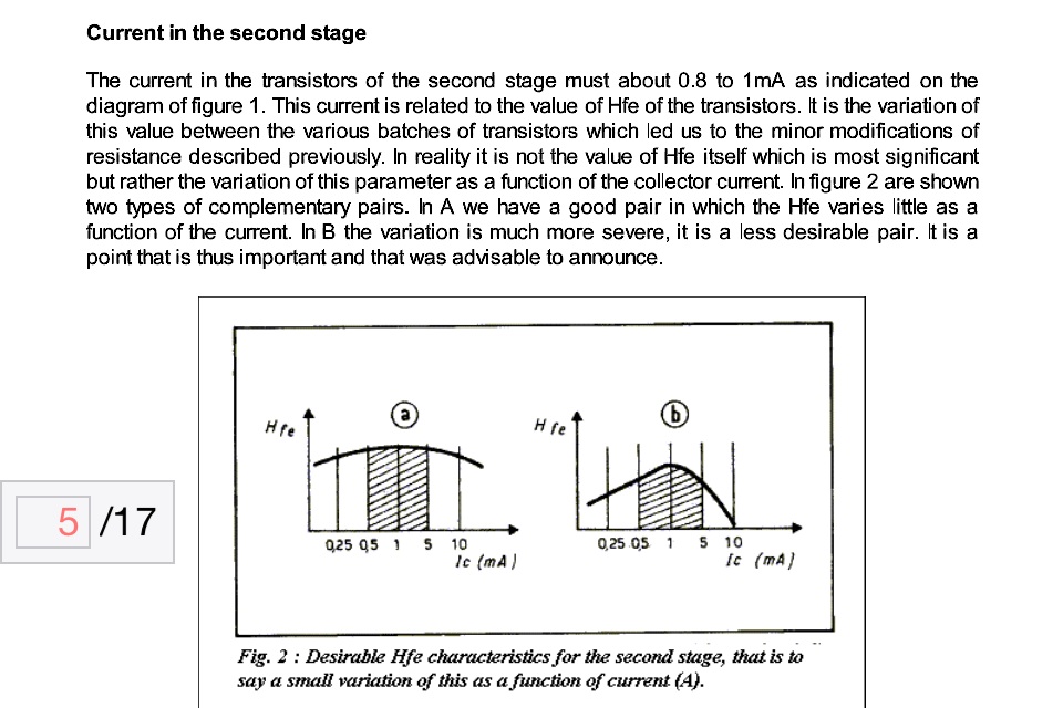

Hi Gaborbela,
In the atached picture you will see what i was talking about. The desired hfe curve for the input pair was described in L'audiofille No15, page 5/17. Look at the picture bellow.
Thats why i said that ksa/ksc pair equivallent or Onsemi or fairchild is not so good as a substitute for the hitachi/nec 2sa/2sc best but obsolete pair...
The philips/nxp are closest but they are obsolete now too.
We have to find other substitutes...
Cheers
Sergiu
I was always fascinated by this advice. I've used it recently in my JLH69 Class A amplifier - as a result I used 8 parallel output devices so I could operate them at the peak of their Hfe curves and where the curves are relatively flat. It stabilizes the OPS input impedance as seen from the driving stage.

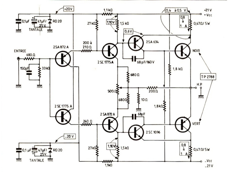

Big thanx for information, but what better: 20W (1985) or 30W (1985)? :)
I read a few pages of this thread. I am interested in Class A amplifier. The Haraga design is very different from the common 2EF or 3EF design. Can anyone point to some article of the theory of operation and comparing between this and the 3EF OPS?

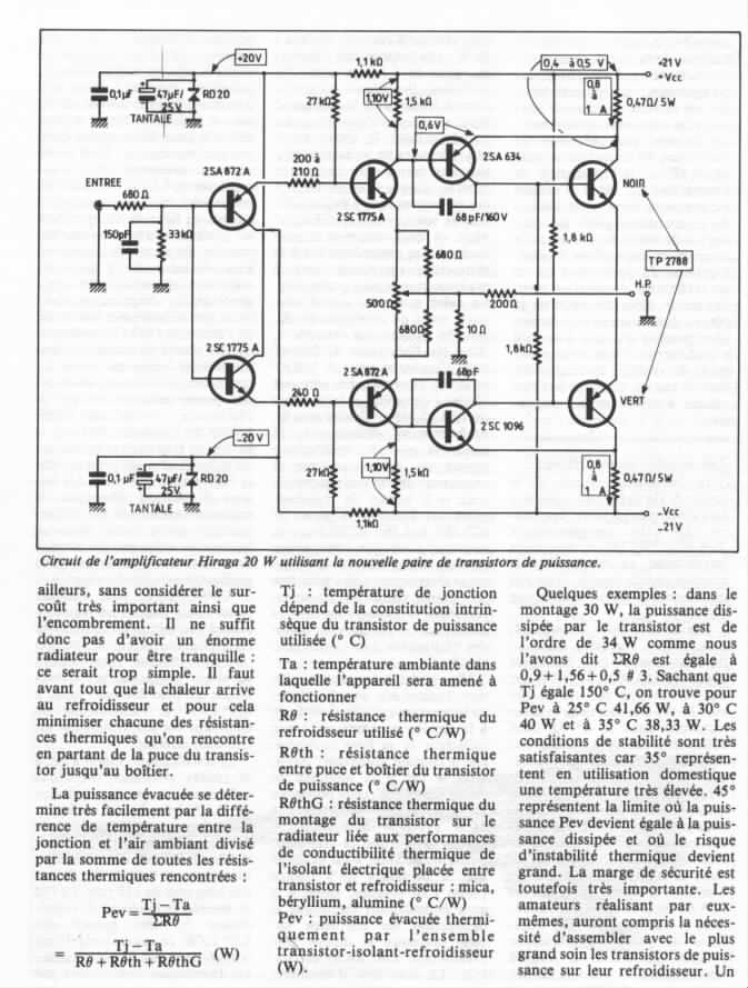

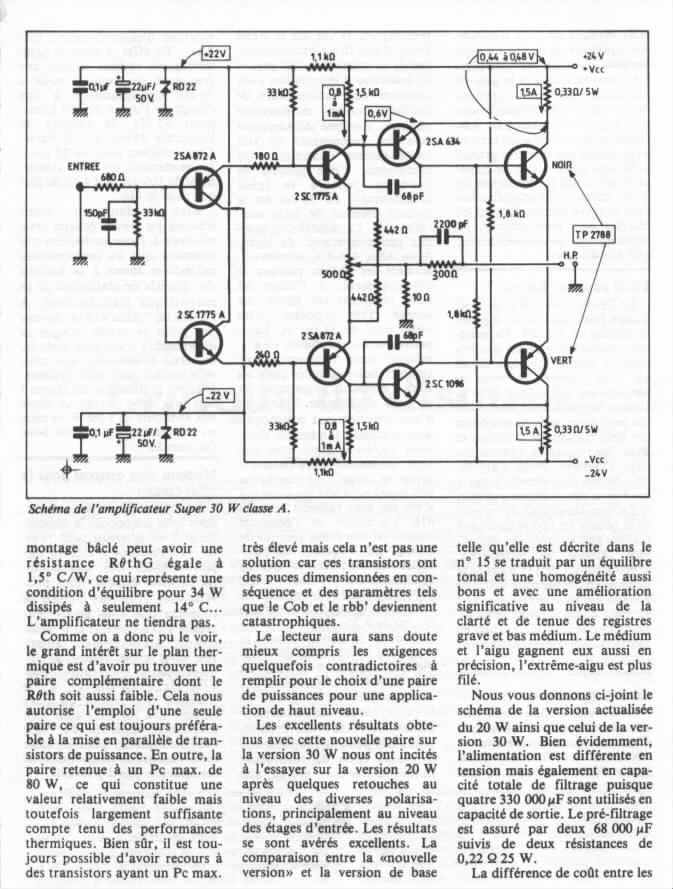

There is a little information about Jean Hiraga's Super Class A 20W & 30W Amplifiers. The 30W version has very very good sound, but I want to build 20W version.

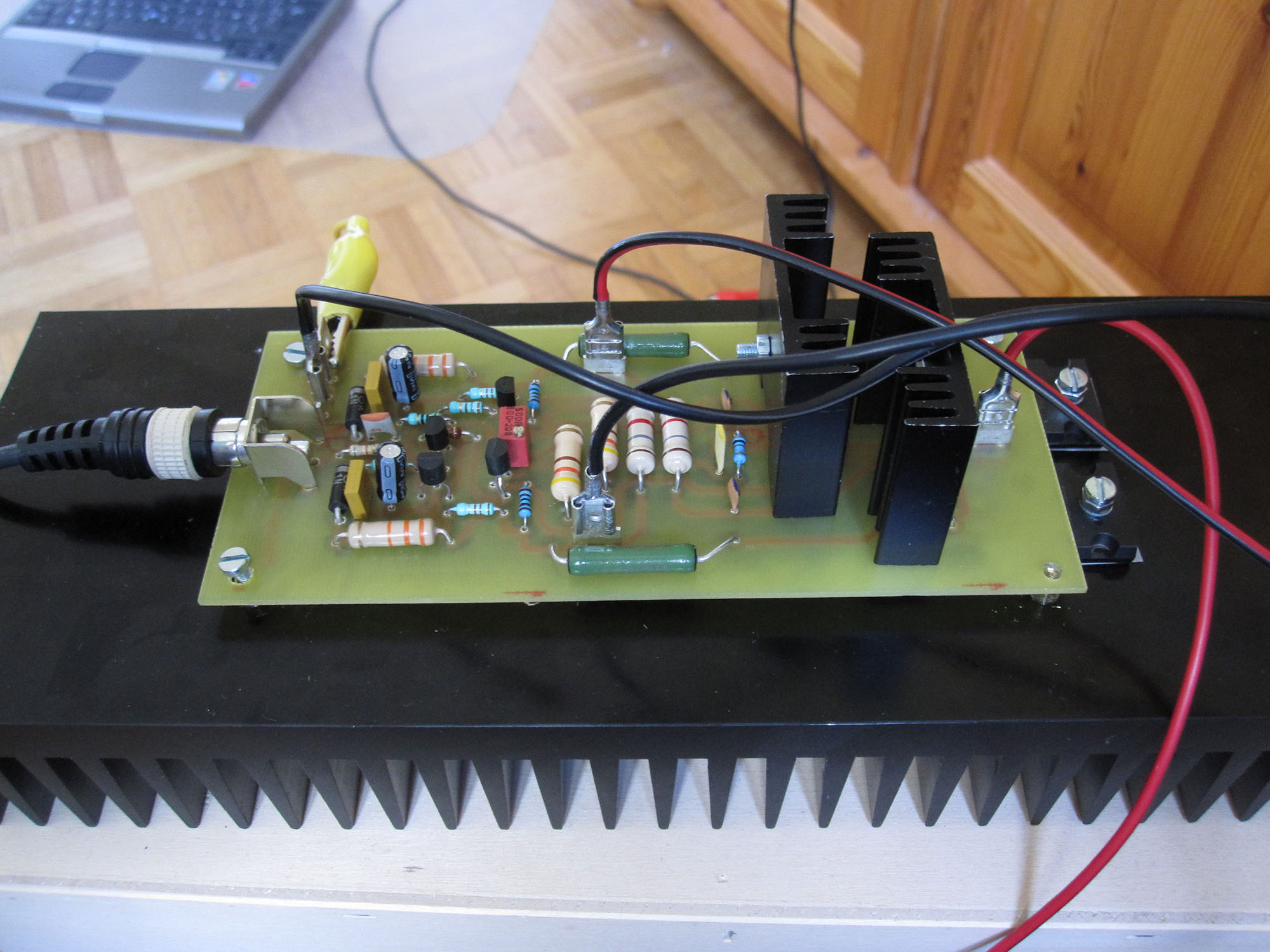

Maximum temperature was +53C in summer (+28 in room) with bias 1,75A. Each radiator is approximately 5000 sq.cm.:)
I used a 30x10x4cm massive heatsink (biggest available in my shop) biased at 1.65A @ 35V and temperature exceeded 55°C: could not touch heatsink more than a few seconds.
Definitely not ecological :p
