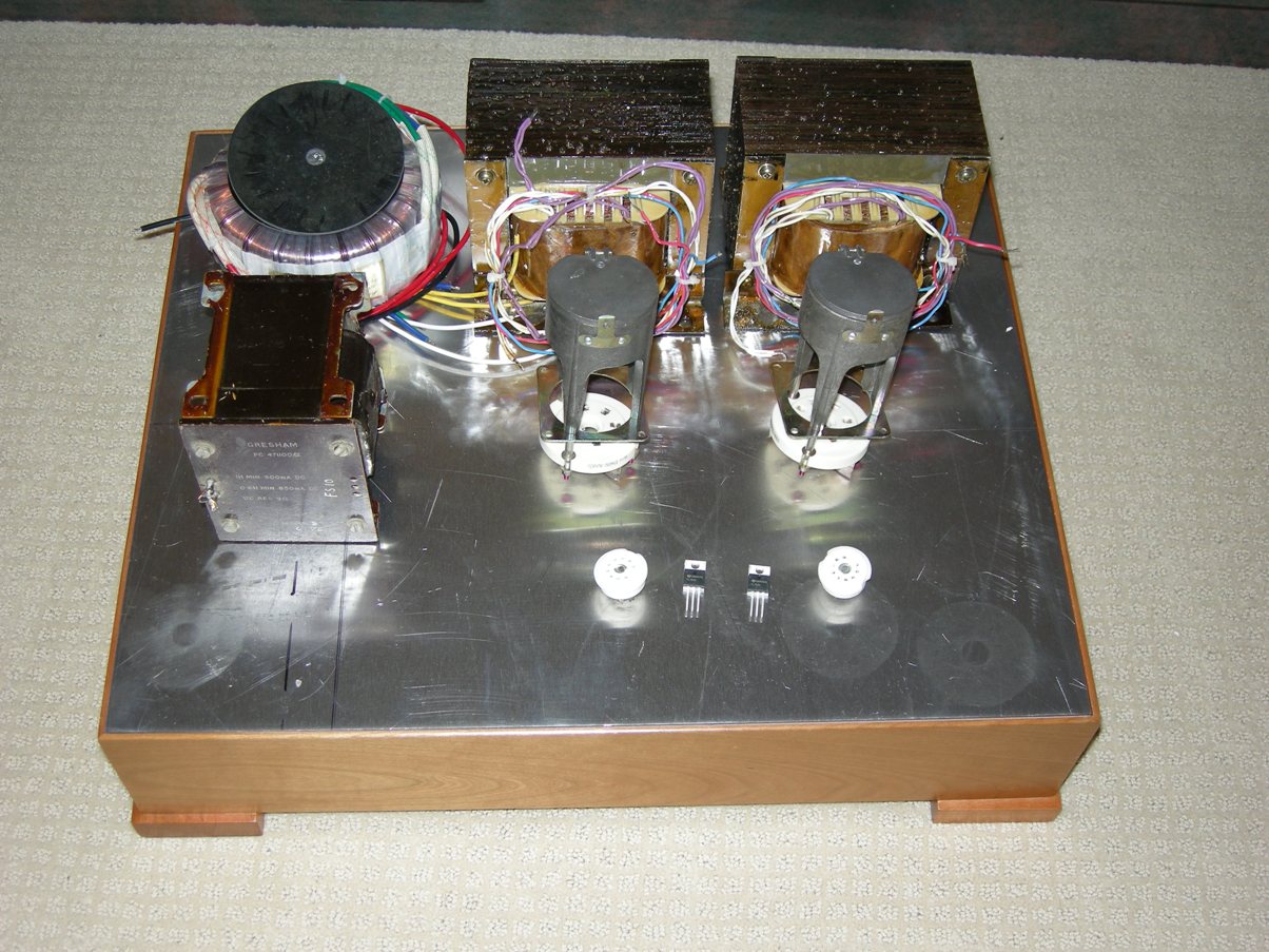

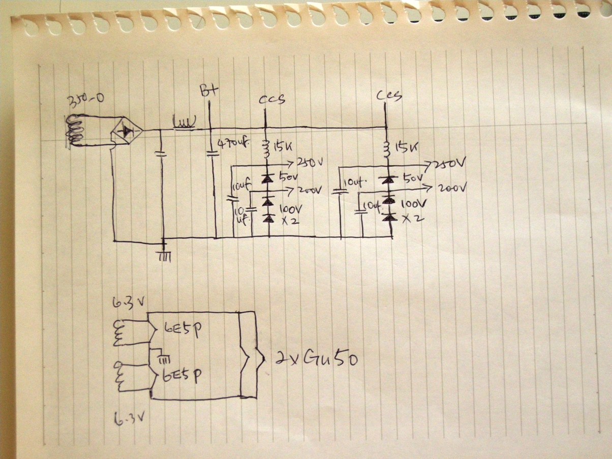

Help with these Russian GU50 tube amplifier

Is 5w zeners good enough ??
Is the 200v on my design good to feed 2 locations? - G2 of 6e5p, and the ccs.
I'll leave more room in between the power tube and the OPT. I'll take your advise to put a mirror there too.
Let's calculate. 250V on Zeners, 200V on 15K resistor. Current is 200/15k. Power dissipated on Zeners = 250 * 200/15 in miliwatts, that means about 3 Watt on all 3 Zeners. But total current is 13 mA. If your tubes draw 13 mA that means Zeners will not work.
I usually start from requirements, how much current should supply your power supply, then decide how to stabilize the voltage.
If say when tubes are cold all current flows through Zeners, it must not be higher that causes 5W dissipation on 100V Zener. That means no more than 50 mA. So, according to current consumption of yout tubes you may now calculate value of resistor, instead of 15K.
