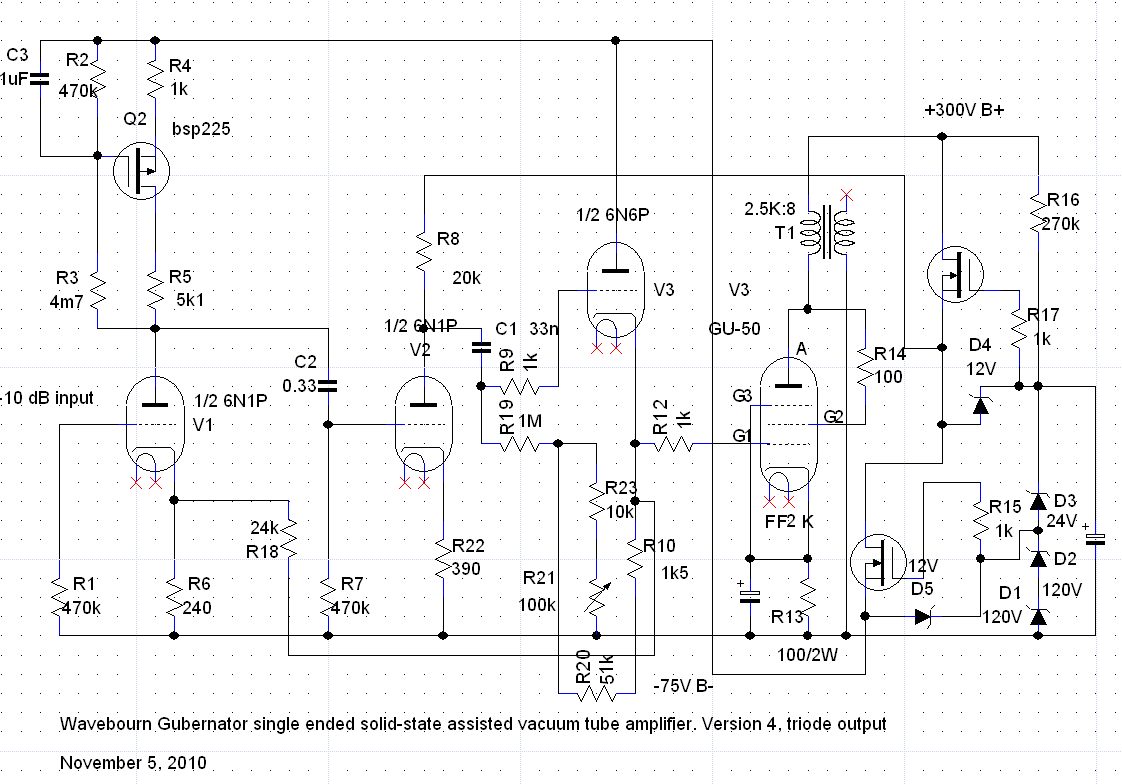

Help with these Russian GU50 tube amplifier
This isn´t impressing and GU50 isn´t well suited for triodestrapping. On one side you swing from 400-150=250V on the other 575-400=175V. This means in the ballpark of 9% 2nd order distortion at clipping just over 6W.
Bad effiency and bad result.
Find another tube if you want to make use of your 3,5k tranny. The Chinese version of EL156 comes to mind. With GU-50 go Right-Handed Triode or Schade.
Absolutely right. Gu-50 tubes are nice for P-P. In pentode, 800V-900V B+, 8K load. For SE they are good for experimenting and learning things, no more. Or, need to be used in A2 in left handed mode, or in right handed mode, or in pentode mode, but always with good negative feedback.
Of course, left handed, 400V, and 3.5K

Modeled the RHT at 400V/3,5k/+13V/100mA. Shows 9W at quite low THD. What does reality say, have you tried this working point?
No, I did not. I was aiming at GU-50 SE, tried many variants on paper, and decided to go by different road for SE. 4P1L tubes are cheap and very linear in triode more, they are very consistent and easy to parallel, and transformers with around 1K primary are cheaper and easier to get of nice quality. Gu-50 tubes are nice for PP, much better than 6L6 variants.
No, I did not. I was aiming at GU-50 SE, tried many variants on paper, and decided to go by different road for SE. 4P1L tubes are cheap and very linear in triode more, they are very consistent and easy to parallel, and transformers with around 1K primary are cheaper and easier to get of nice quality. Gu-50 tubes are nice for PP, much better than 6L6 variants.[/QUOTE]

6N6P = 6Н6П Cyrillic. But that schematic was just a preliminary draft, it may contain some errors. Needs breadboarding.
Thanks for the head up. Lucky I have lots of 6H6n, ah....I can play around with this tube. You asked I have to work out a driver. What I have in mind is I'll try to work out something with your preliminary draft. I'll try front end 1/2 6H6n to drive 1/2 6H6n. I therefore just have one tube to drive the GU50. I have a pair of hammond 1640SE 1.2k so I could try PSE too. Will post that for your comment/ correction.

Operating points as described by Wavebourn. However, I have converted my system. Currently I have revised my circuit and it is now a 6E5P driving the GU-50 in pentode mode with local feedback. (plate to plate)
I think you can work out the loadlines for 6E5P and GU-50.
