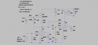

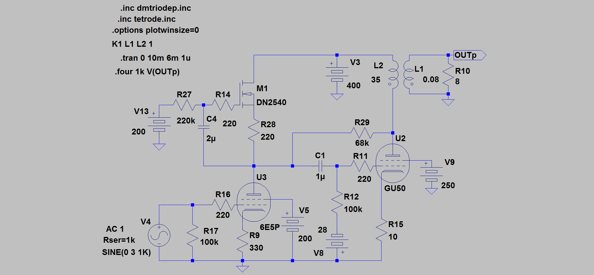

Albertli,
This is a simplified model where your PSU and OPT will work(400V/3,5kohm). Will clip at ca 30V ptp into 8ohm. 6E5P at 200V/12-15mA.
Lars,
Thanks very much. I certainly do make a try on this. I have to digest more before I know how to ask some questions. Hope you would tell me more.

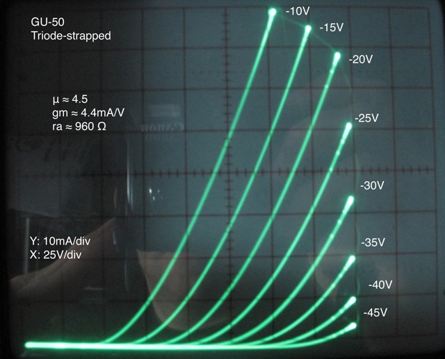

Not sure if of any use here, but was playing today with my curve tracer and did a plot for the GU-50 in triode mode. Unfortunately my anode supply can only swing to 300V at the moment, so curves are limited to that maximum anode voltage.
I took measures from the plot indicating that gm=4.4mA/V, u=4.5 and ra=960. Does it sound about right?
You can download the curves from here:

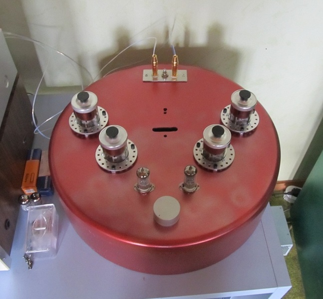

My PSE prototype
This is my PSE prototype - almost finished. B+ 410V, driver ECC801S in SRPP, negative bias (GU50 - around 45mA each), OT 3.5K:8Ohm. Interstage caps: Jantzen Audio Superior 0,22uF. Frequency response from 8Hz - 35Khz 0dB. GU50 in pentode mode - sec grid around 255V. Power >20W/8Ohm.

Hi Ale;
it would be nice if you show the curves up to +10 Volt on G1. 2 more lines on the picture!

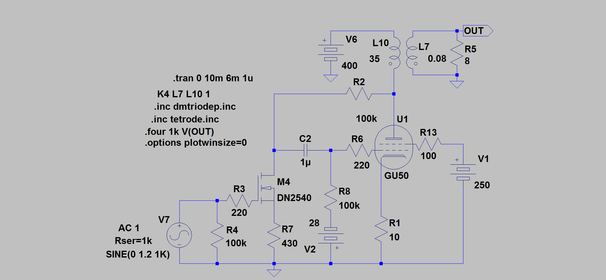

Albertli,
Lars,
I'll make out a psu for your comment.
Do I aim at 100mA tube bias with -28v ??
Albert
Revintage's circuit will work very well.... my circuit is very similar, but my 6E5P run with a simple resistive plate load only. You could run the load as in Revintage's circuit, or with a resistive load or replace the load with a 60-80 Henry choke for the 6E5P.... each will have it's own special sound quality.... try it and pick the one u like the most.

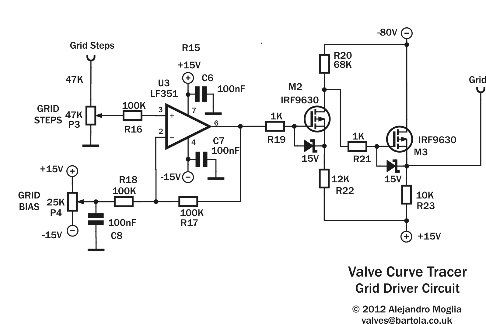

Hi Anatoly,
Got only +5v, but strangely enough the +5V is squeezed to the 0V curve. Any idea?
http://www.bartola.co.uk/valves/Construction_gallery/Pages/Traced_curves.html#0
Ale
I thought it was the case, but checked with the oscilloscope and had a perfect step at 5V with no signs of the driver struggling to provide current.
Attached is the driver circuit. with the 10K resistor I think it can't provide more than 1ma there...
Any suggestions?
Ale
Any suggestions?
Ale
Thanks and would love to try all those you recommend. I thought I'd start doing it as of Lars design. I'm making the wood chassis and would cut the aluminum top plate sometime next week.
