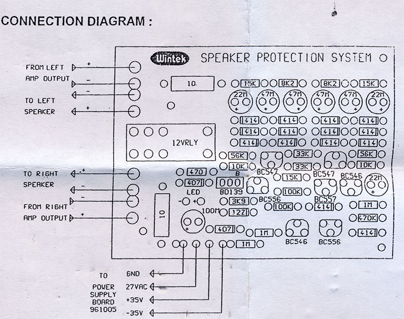

Guys. please share your opinion on the above and also help me sorting out these issues:
1. The usual humming and hissing noise issue which I was facing earlier has gone and when I turn on the 5XLM3886, they don't give hint like something is turned on. But when I tried to observe the noise by by putting my ear near to the driver, minor kirrrr kind of noise was present there and a very-very mild hum was also there. It is very-very minor and doesn't interfere while listening audio and doesn't feel at usual sitting position but I would like to delete it as well.
2. My sub makes my sub driver to pop out loudly when it is turned on which will damage the driver sooner or later, I have a speaker protection module which I tried to add between the amp and the speaker but it didn't work. The cone pop out effect wasn't there but sound also got muted, no audio signal was passing through. I checked the volts and those were fine. This is the module I have:
Whats maybe the problem? I checked the connection and those were according to the diagram and the markings given on the board.
Is there is some other easier solution to protect the driver?

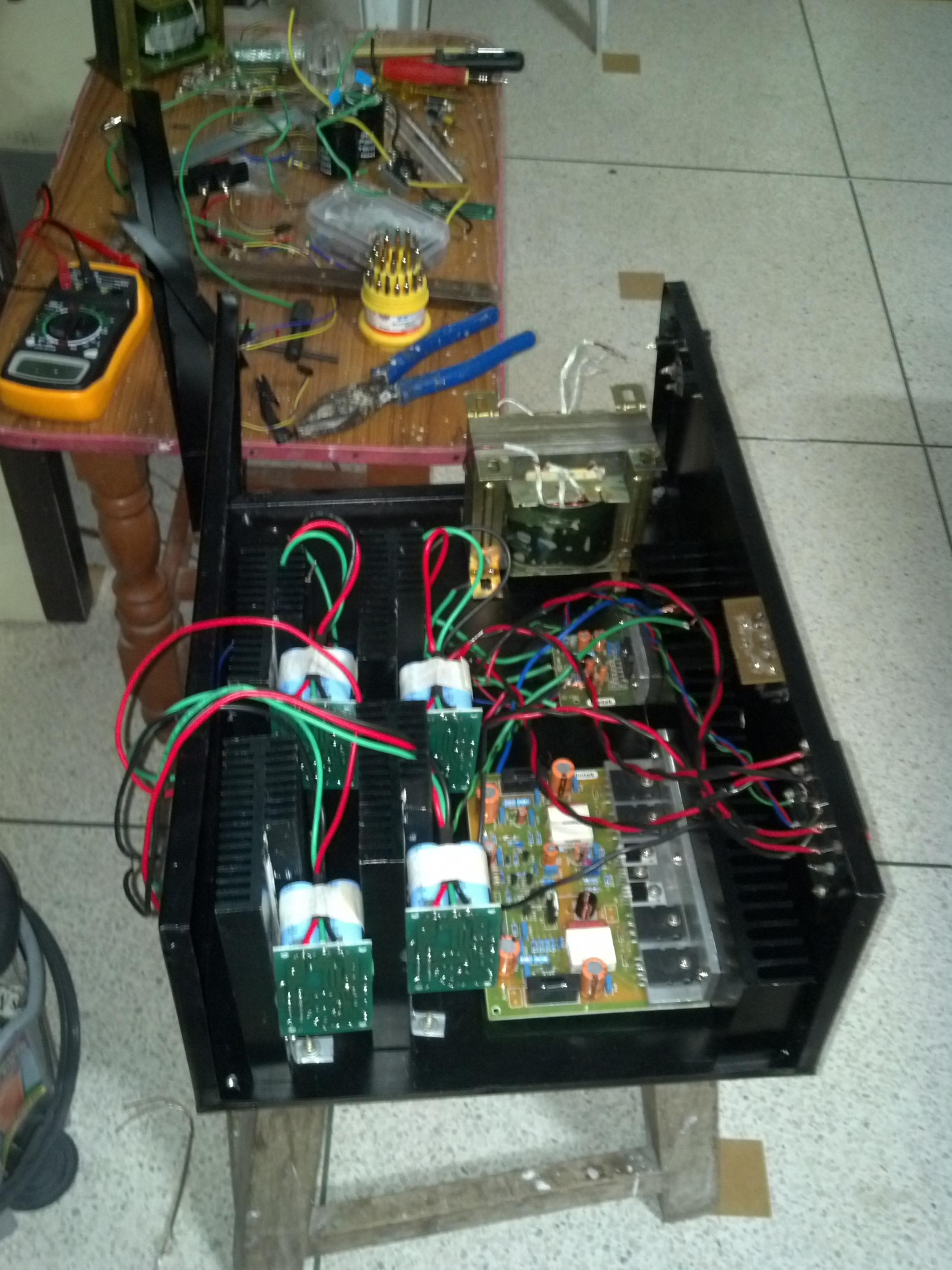

3. Due to odd size of the heatsinks, I had to dump the old idea of the amp cabinet and now thinking about this simpler 2-piece thing:
Total dimensions of the cabinet : (W)430mm X (L)300mm X (H)180mm
It can accommodate - 5X3886, 1Xsub amp, 2Xtransformers, 2XPSU circuits on one board, and some other added modules by making some arrangements.

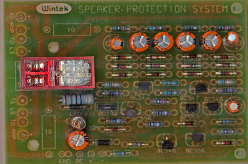

Check the relay. Does it get energized when you turn on the device.
You must be hearing some clicking noise of the relay. If not there is some issue with the circuit.
Check the voltage across relay it should be close to 12v. Double check the wiring.
The circuit has a "loss of ac detector" you need to connect the ac output of your transformer. I.e before the rectifier to the circuit.hope you must have done the same. Post pics of the wiring lets see the same.

To test the DC speaker protection disconnect the speaker output from the Protection circuit but keep the power supply connected to the protection circuit , Then connect a DC power source of say 3v-5v (Maybe 2 or 3 AA batteries in series) to the speaker inputs on the Protection circuit and listen for the Relay to Switch , you should hear it click every time the DC is connected to the Protection circuit .....
Generally speaking the loud pop you hear when you turn on the power isn't going to hurt your speaker , it is generally a extremely short DC burst to your speaker which isn't enough to harm the voice coil , though the Protection circuit is very useful for protecting your speaker in case of some sort of chip failure and clipping ... Many times when a chip fails it will output half the supply rail to the output which will fry your speaker in about 15 seconds ....
The diagram has marking for +/-37v, ground and ac inputs. I connected ground form rectifier to ground and +/- 27 after rectifier to the +/- of he circuit. Then connected amp and speaker lines to the circuit.Check the relay. Does it get energized when you turn on the device.
Now you say i should connect the AC. There is only one point for AC line, then doesn't it mean that I should connect one of the 24v supply from tranny to the AC line and the (0) to the ground? Please see the diagram of the circuit I posted in my earlier post and help me out understanding the connection.
Hmmm... Didn't think about that. Then what is better fail safe alternative.though the Protection circuit is very useful for protecting your speaker in case of some sort of chip failure and clipping ... Many times when a chip fails it will output half the supply rail to the output which will fry your speaker in about 15 seconds ....

As you are saying you have already connected the dc supplies of +-37v to the board and the ground connection aswell. You just need to connect any one of the tranny's secondary ac output to the ac input of the board, ensuring the ac is not above 27volts. Leaving this connection will not allow the circuit to work. The circuit encorporates a delay network of capacitors and transistors, whenever the circuit will detect the ac signal from transformer it will energize the relay after a short span of time (delay) depending upon the value of the capacitor. This will prevent any switch on thummps arising due to transients. The role of the circuit here is that it will connect the speaker to the amp through the relay after a short period of time where in the amplifier circuit has been stabilized and there are no dc offsets or transients at the output. And immediately when the power is removed the ac signal is lost which will instantly swtich off the transistors driving the relay. And the speaker terminals are shorted to ground . Thus elimanting switch off sounds if any. This will protect your speaker from excessive excursion, and mechanical failure of the driver.
Also as a suggestion use a subsonic filter with this filter which will protect the driver from excessive excursion below 18hz.
secondly dont use the same psu to supply all amps. Built seperate psu for all channels. This will eliminate cross channel interference. I will suggest building a seperate psu for your sub with its dedicated trafo. Also better to use several filter caps in parallel rather than one single high value capacitor. For example ..better to put 4 pcs 4700uf capacitance in parallel than using one single 22000uf capacitor. This will handle transients in sound much more faster than one single cap. As bigger caps will take more time to charge.

Thanks saraswat, that is indeed helpful So you mean I will have to connect AC from transformer along with ground and +/- supplies? So total for power inputs need to be connected there? I thought either use AC or DC.

Yes you are right now. You have to connect all ac and dc inputs together. I.e all 4 together.

Amp pics
Yeah, I couldn't go over his recommendation on the heatsinks and got really big heatsinks separate for each chip as he and other fellows suggested and now I feel it was worthAndrewT is one among the best personalites around .
Thanks for the pics saraswat, got some ideas now.Amp pics
