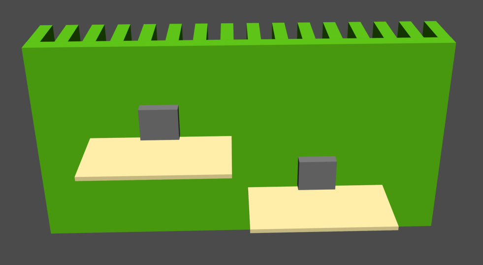

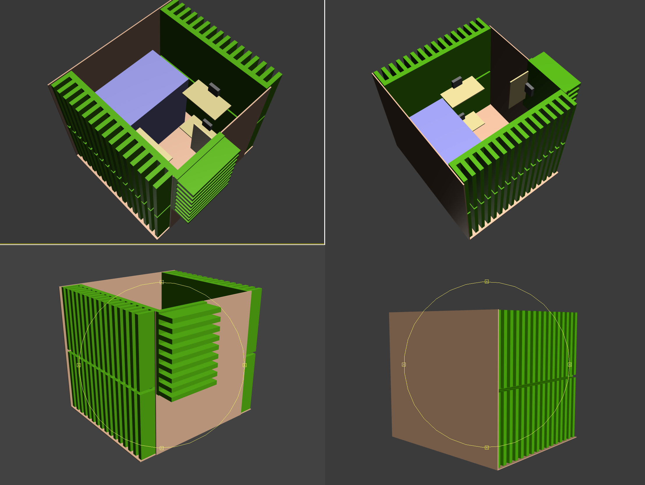

Well there is one arrangement - one heatsink above another. By doing this, total height of heatsink turns out into 200mm and length remains same 196mm. Total dimension of cabinet turns out into 230 (W) X 200 (L) X 200 (H) mm (approx). Yeah, I may have to increase the total area by a little more but this is something what I can look out with this heatsink option. How is that?
Here is a 3D illustration of the above I just created:
But the cost is too much for this heatsink. I can arrange four pentium-III heatsink+fans in the cost of one heatsink is that worth for this heatsink? If I go for pentium heatsink then I really don't want to add 4 fans for sure.
There is another thought if I want to use the single heatsink, I don't put the two LM3886 in row or parallel, rather I put them in unsymmetrical way like this:
Shouldn't this increase the cooling efficiency since more heat is built up there near the chip itself and by doing the above arrangement, we are actually increasing the distance between the two chips yet maintaining maximum free surrounding area ?

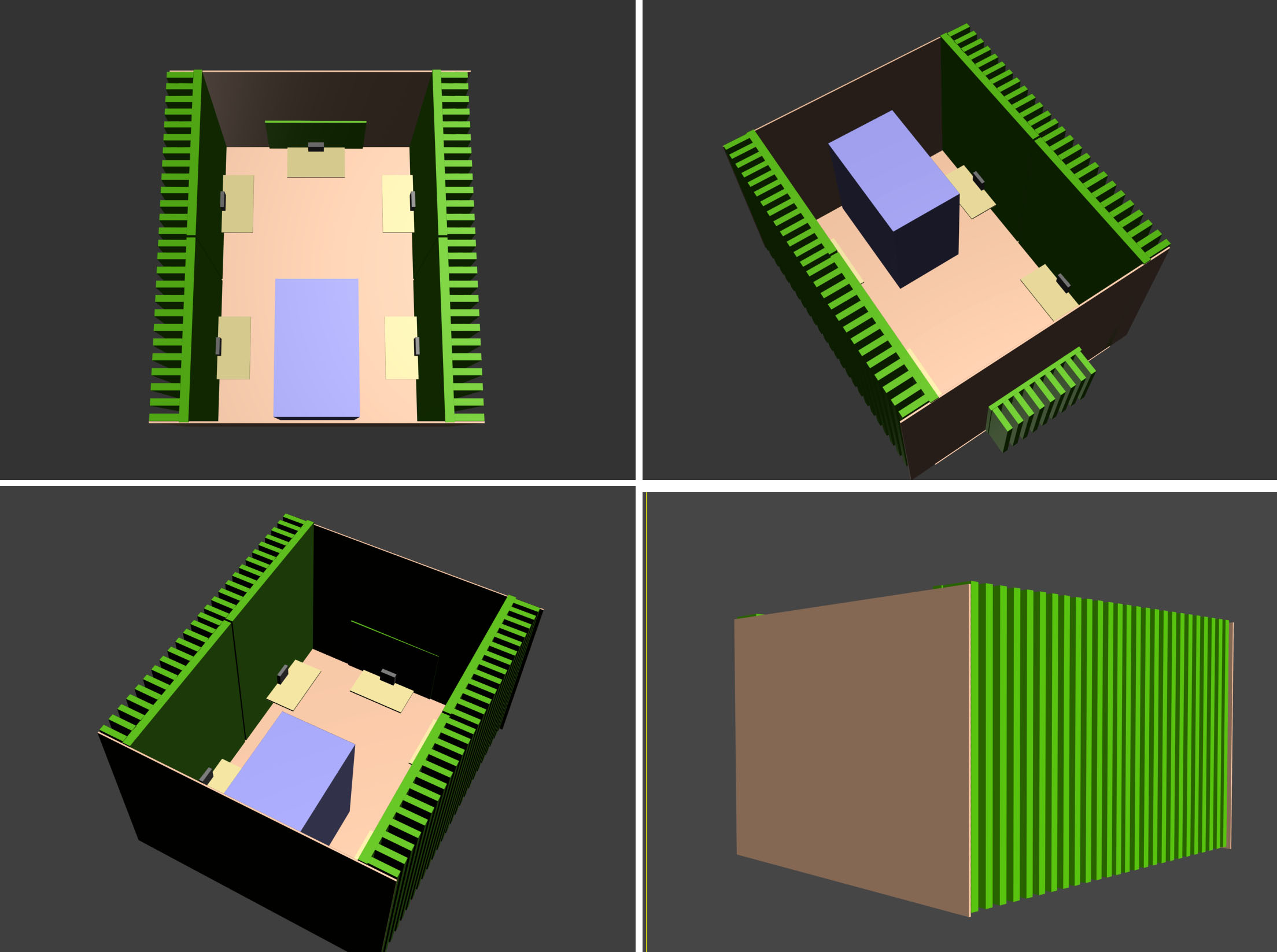

Now I can plan something like this:
Total inner space available is around 220W X 320L X 200H mm (8.6" X 13" X 7.8").
It has little bit more space inside to move the hand while working on it and can easily accommodate some extra stuffs like PSU and some other stuffs in case of upgradation or additions.

You mean the one attached at the rear of the cabinet? Okay, have fixed it in the above design.The upper pic shows one sink lying on it's side. This will make that sink and the device attached run hotter.

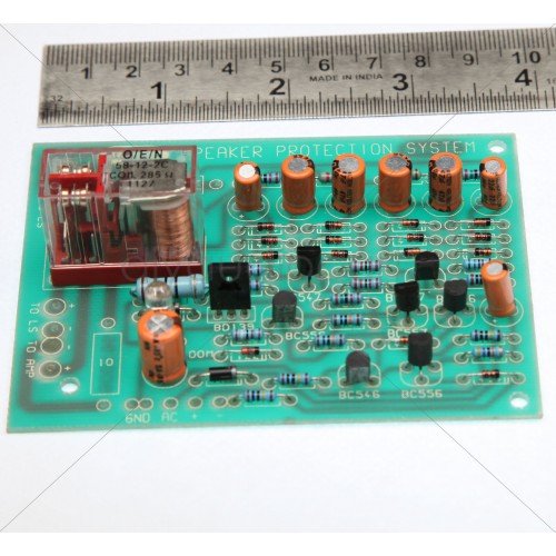

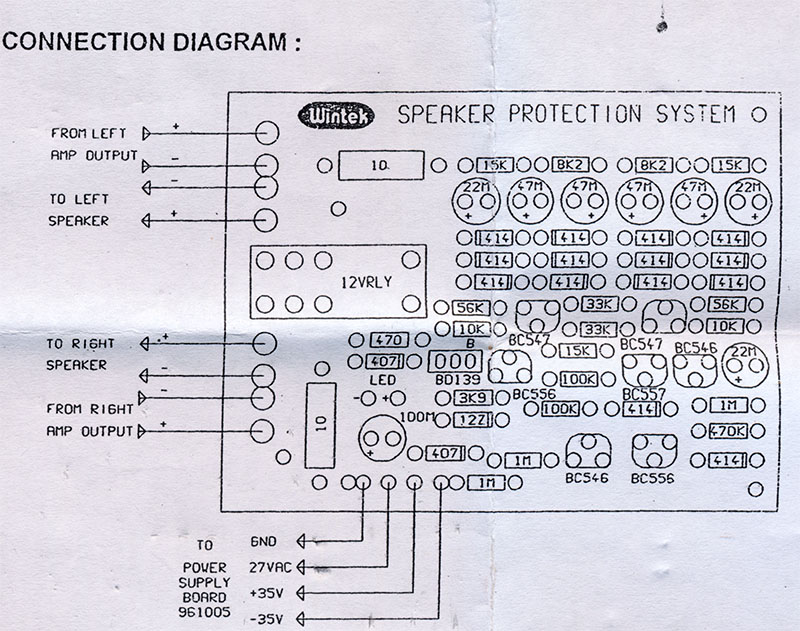

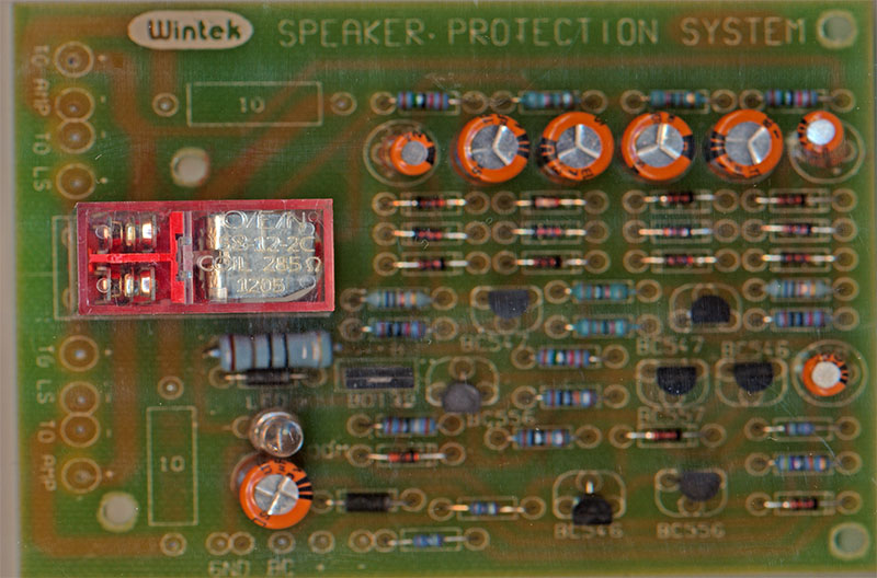

I also have a speaker protection module which I want to use with the sub amp. Now there are 3 components which will be fitted in the sub amp cabinet. But I am not sure how to distribute the power supply through that transformer to these components.

Also how to take power supply into speaker protection module from the same transformer?
Here are pictures and connection diagram of the speaker protection module:

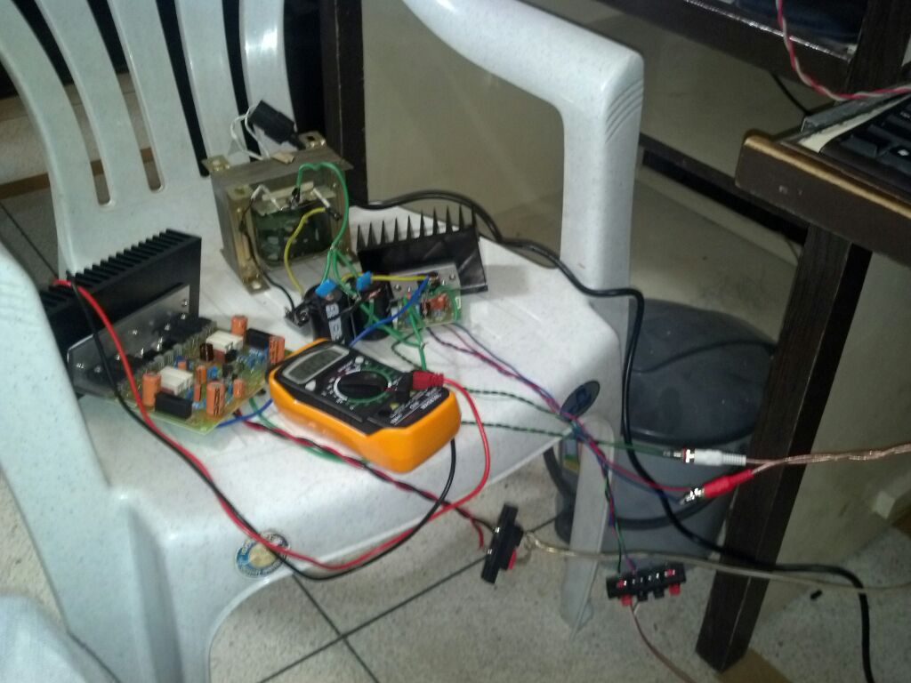

My heatsinks are still on the way so today I decided to play the existing LM3886 along with the sub amp. I attached both the amps with my 24-0-24 transformer+PSU and allowed both the amps play for a long time. Both of them seem to playing nice with the single transformer. I measured the volts on both amps and it was showing around 25.6v on both amps. I checked while played loud and also when there wasn't any load.
Is there any way that I can measure clippings or drop in power?
Also how to measure ohms form multimeter? I set the dial on ohms and measured both +/- points of the speaker outputs. Measurement was varying but it was also dropping till '1' on some occasions. Even it was dropping till 0.2/0.3 when there wasn't any audio signal. Is that correct way to measure or I am missing something?
Any other measurement where I should keep eye during initial days testings?

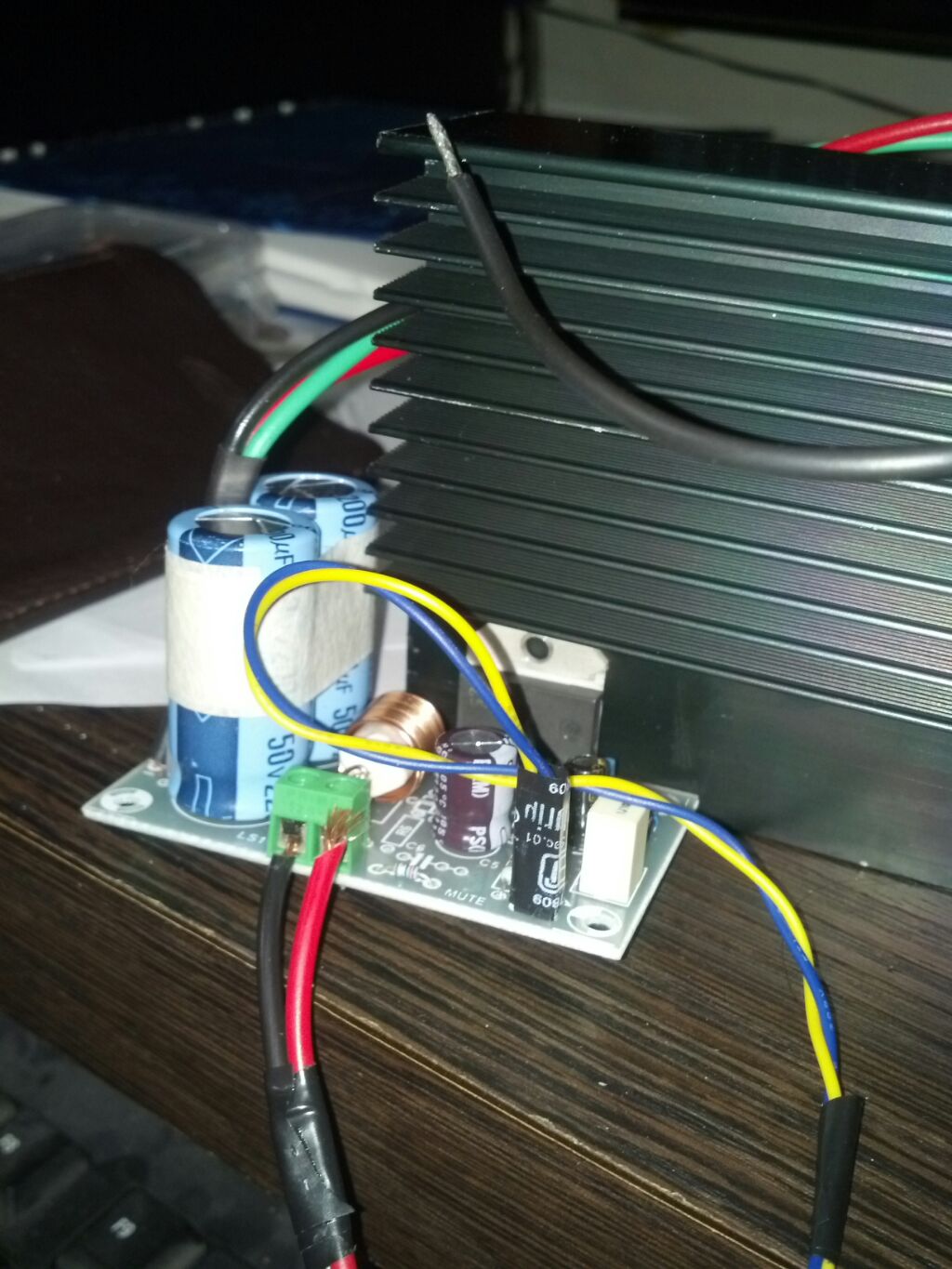

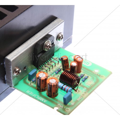

Is it necessary to put that aluminum piece between the chip and the heatsink as shown in the picture below:
No

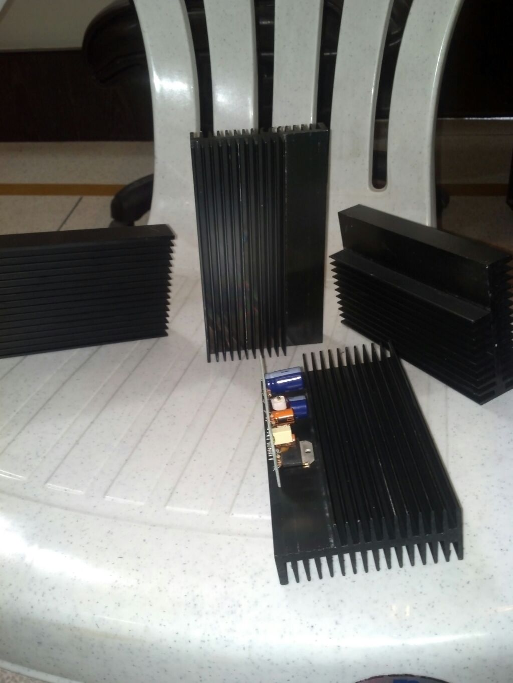

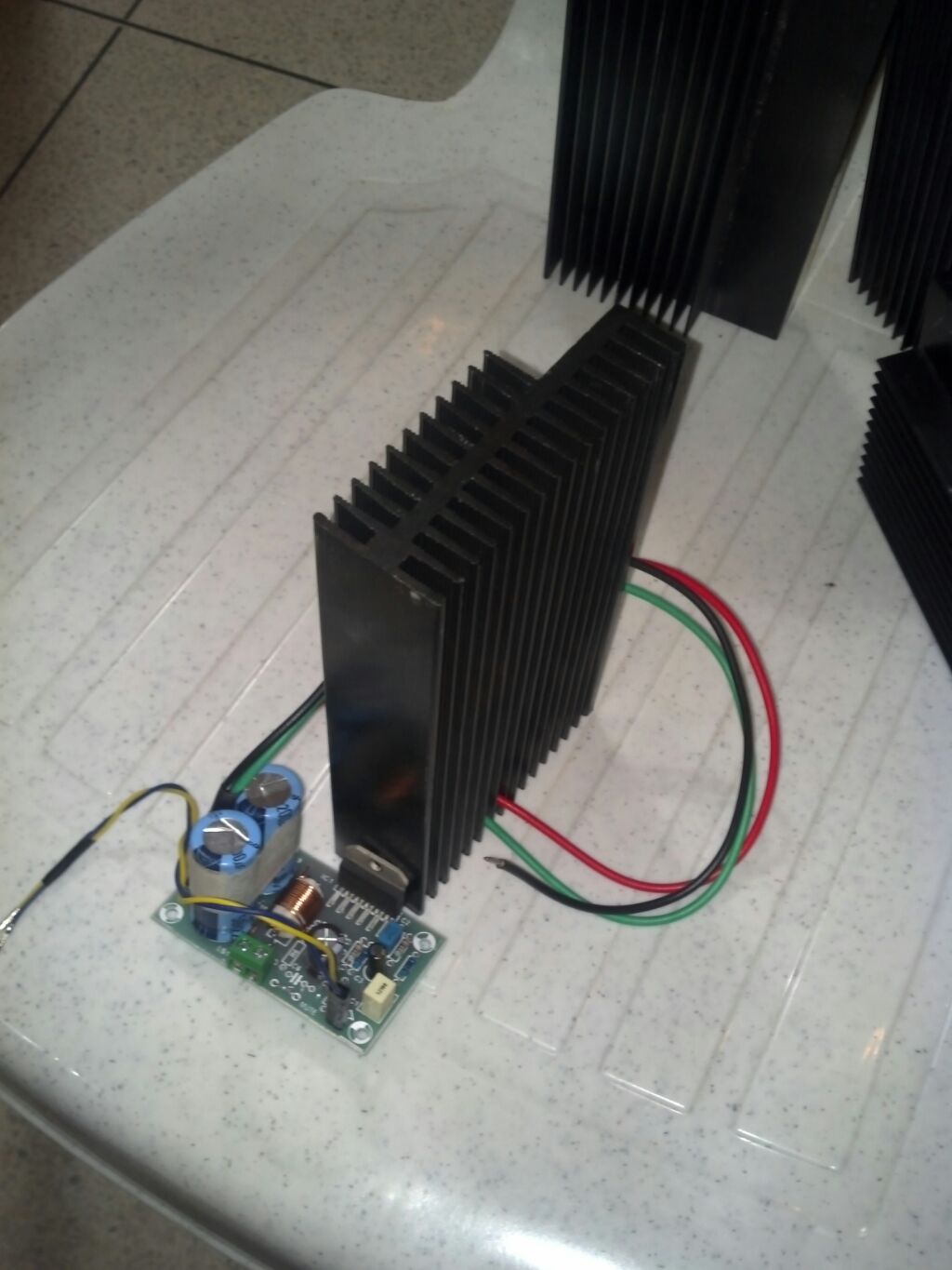

Here comes the another problem. The heatsinks I got aren't amtching the claimed size of 200X160mm, rahter they are just 160X88mm.
Another thing, the heatsinks have fins on both sides and there is very little space available to attach the chip and my LM3886 board with Rubycon caps isn't fitting in that space.
Can I attach the chips like shown in the image below or in any other way or there is only one set format to attach the chips for maximum cooling performance:

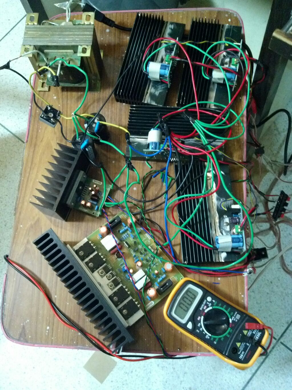

Finally all of 6 channels are playing
Got cut few of the fins from the heatsinks and attached chips to them. Connected all of them including sub amp to the 24-0-24 transformer and started playing. Everything is running fine.
Sub amp makes loud sound when turned on so I will need to add speaker protection to it.
