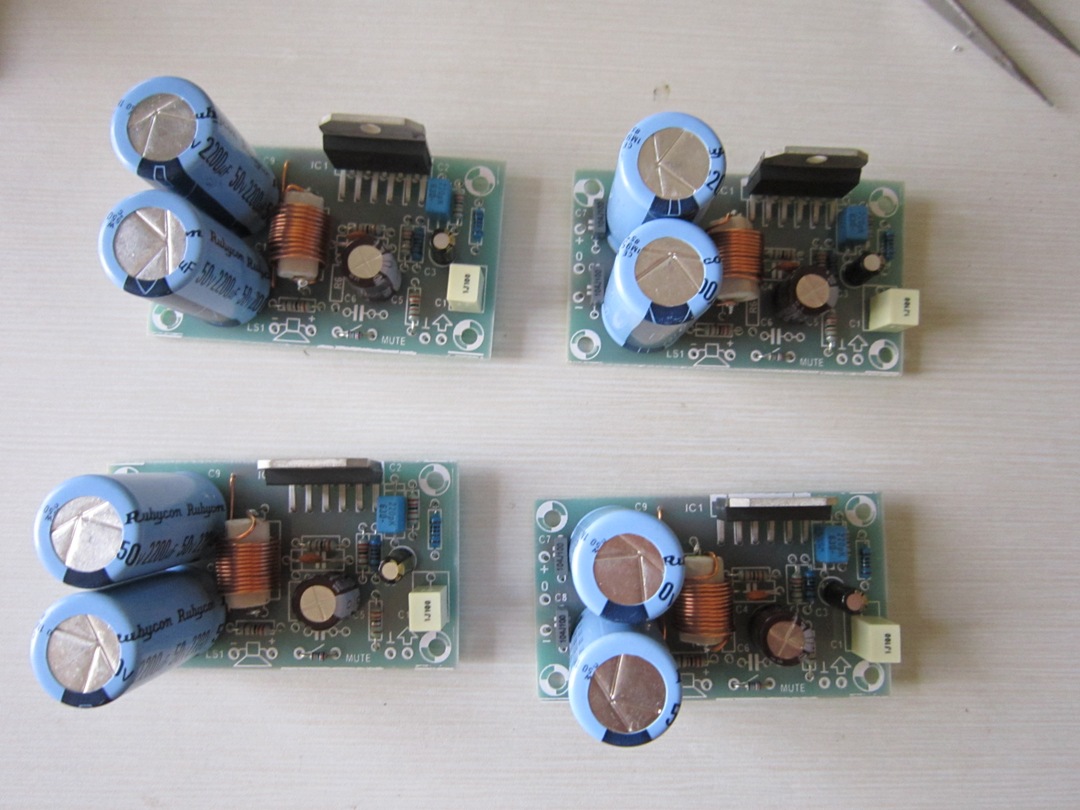

Received rest of 4 X LM3886 kits.
Now searching suitable heatsinks and cabinet
This is same Elektor type PCB,If I am not wrong .
Yeah, it is. Any issue with this PCB?This is same Elektor type PCB,If I am not wrong .
